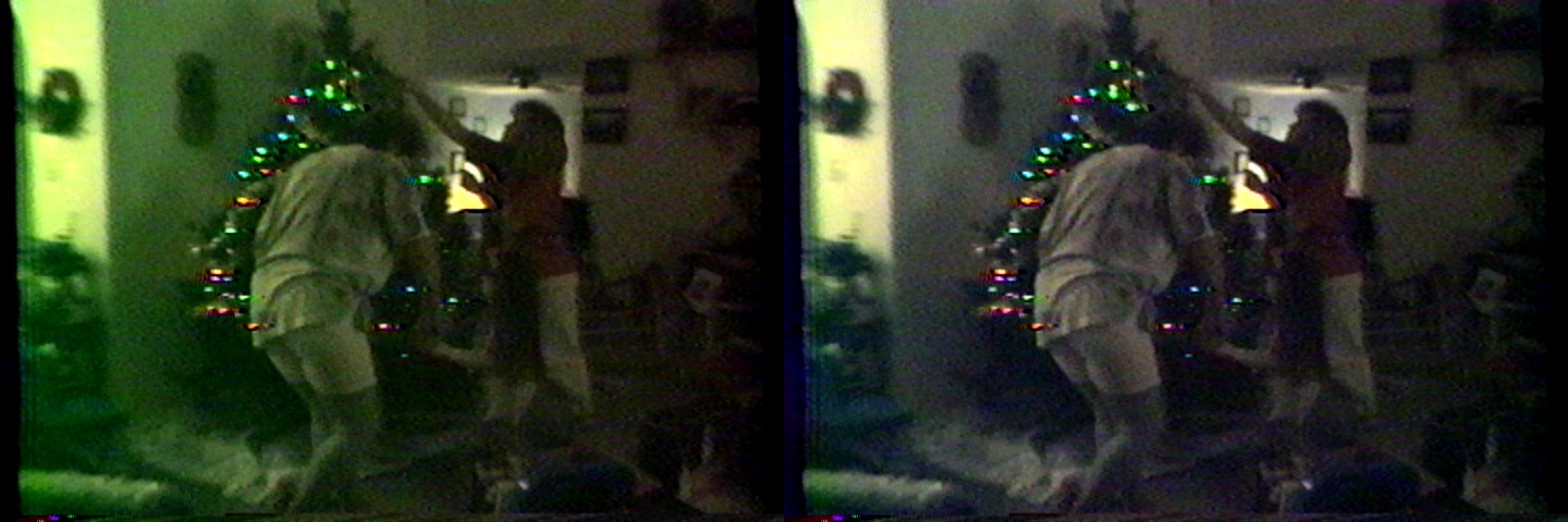

    After another quick look: Actually, you do have a problem you had not noticed. The sample is interlaced, with an odd distortion of the left border (and it's obvious that a tbc is needed here) -- unless that's a large chunk of furniture on the left, but it shouldn't be moving with the border itself. IF you separate the interlaced fields and play field-by-field, you see the reason for the flicker: there is a deeper green shift in the odd fields, while the even fields have less green on the left and more red on the right. When the interlaced video plays, the on-and-off shifts look like flicker. There's also uneven movement of the tape, and odd fields actually "lean" toward the left, so the two fields are poorly aligned within the frame.
    [Attachment 17113 - Click to enlarge]
    That appears to be a player problem.
    There are some clever masking ideas that could be used in Avisynth or many NLE's, but the frames would have to be deinterlaced and the odd and even results treated differently, then interlaced again. Hmm. Can't say I've seen this before. But it would be better to try this tape on another player and see if the problems repeat themselves.

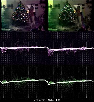

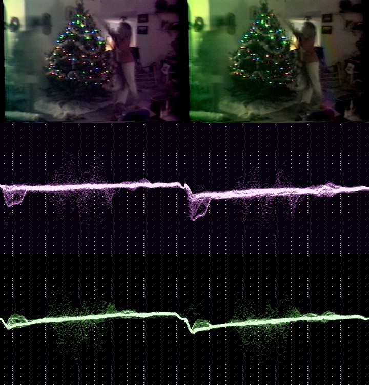

  20. Do all shots/tapes exhibit the same color problems? Or is it just this one shot? It's possible to make some improvements but it won't be easy. Here's the top field on the left, the bottom field on the right, and scope traces of the the U and V channels below:
    The color shift across the frame is because of the tilt in the traces. Those frames are an average of 8 separate frames to reduce the inter-frame variations. But with individual frames the scope traces bounce up and down. The approach to fixing the video would be to de-flicker the bouncing of the chroma channels, then un-tilt them. Then look at that big droop in the channels at the left edge.
    But the first thing I'd try is a different VCR.

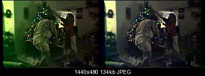

  22. I guess the camera just had problems with the low light scenario. Here's a little adjustment to compensate for the green to purple shift across the frame (original on the left, processed on the right):
    I was working only with the bottom field because the top field needs a different adjustment. Still not perfect but much improved. From here you can work out the details for the top field, then use regular proc amp adjustments and noise reduction.
    AviSource("Sample.avi").AssumeTFF().SeparateFields().SelectOdd()
    org=last
    mask=ImageSource("mask.png").ConvertToYUY2(matrix="PC.601").BilinearResize(720,240)
    ColorYUV(off_u=20, off_v=20)
    Overlay(last,org,0,0,mask)
    ColorYUV(off_u=0, off_v=-6)

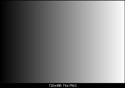

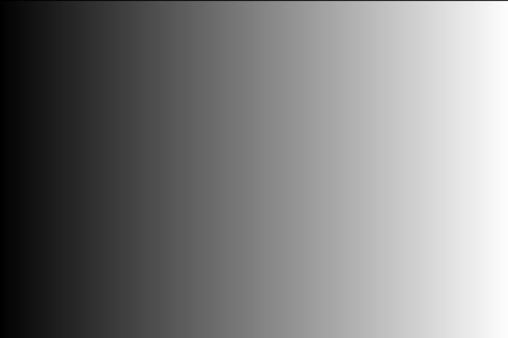

    mask.png:
