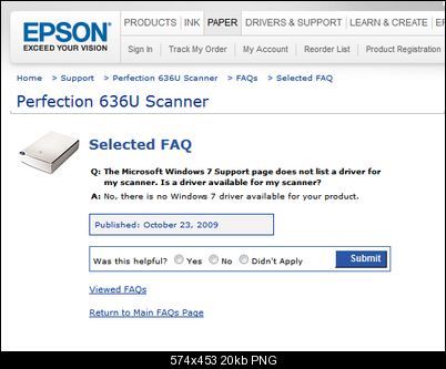

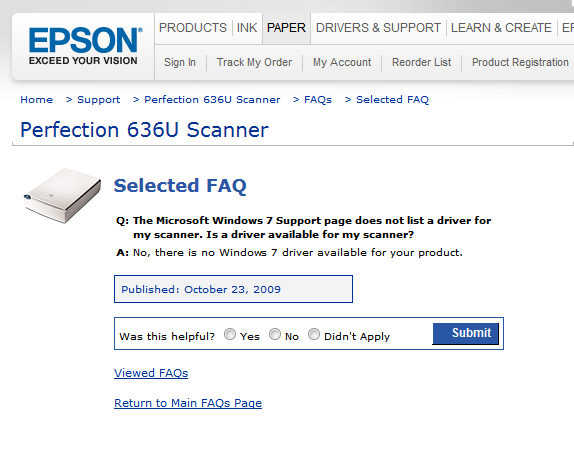

    In Photoshop you should then be able to import using WIA-Epson Perfection 2400
    (importing with Epson Perfection 2400 causes Photoshop to freeze
    but here's the official epson stance.
