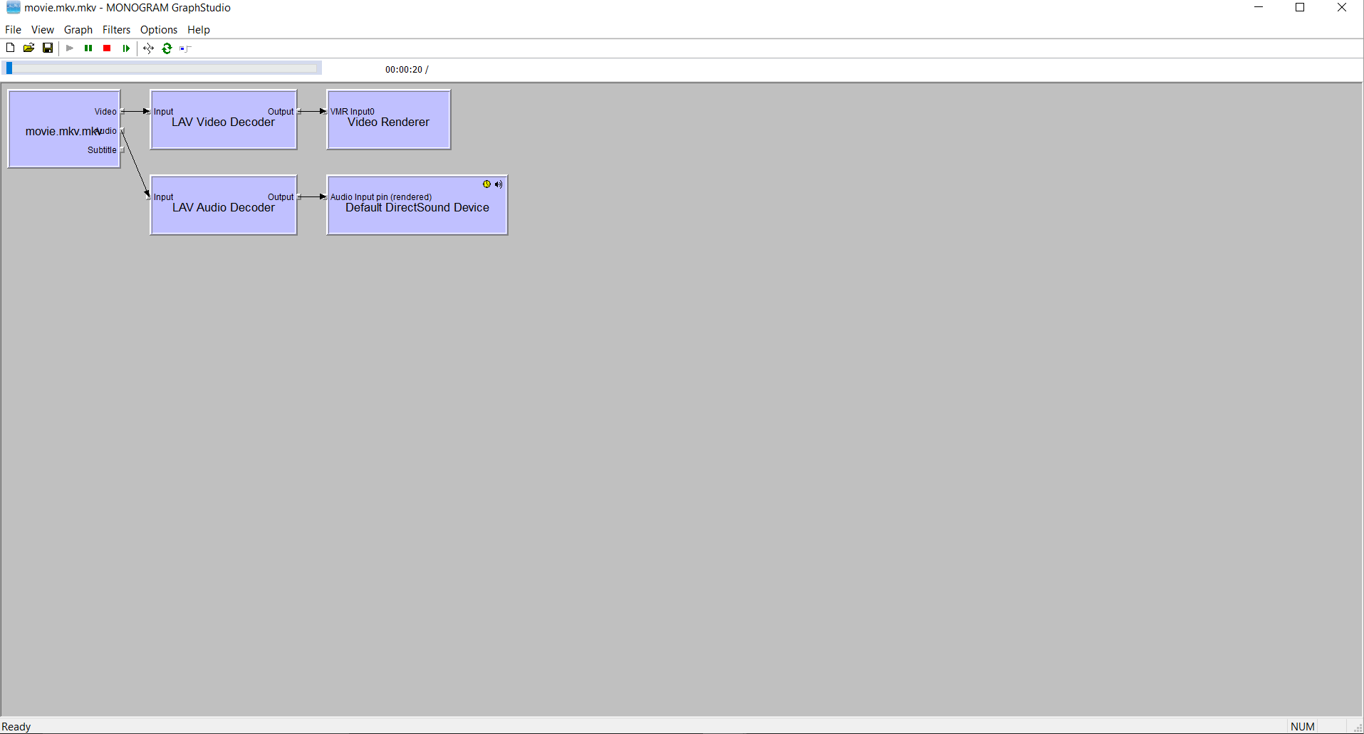

    I would second the suggestion from Dave. The log says that ffdshow cannot process your mkv and AVStoDVD had to force ffmpegsource to frameserve the video stream.
    To setup LAV Filters, you can use the tool within AVStoDVD to set the preferred codecs.

    by setup lav filters I mean the settings as I have never had to set up anything like that before ,which is why I explained my set up in my previous post, as in past when I have used labv filters everything has been out of sync,so want to make sure I set the settings all correctly

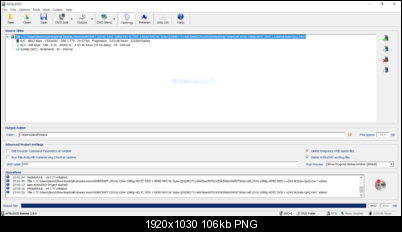

ID:	37371I have installed avstodvd 2.84 numourous times and the end result is audio goes out of sync after encoding, as I do not know what the correct settings inside of lav filters is, which is why I have asked a few times does any one have a link to settings guide for lav filters so I can set up correctly
    also on another not I have a few files that are in sync but when I load into avstodvd it is putting them out of sync by some many milliseconds. is there away before I start encoding I can adjust the sync through avstodvd before encoding so I don't end up with out of sync file after encodes-see attached image for this problem. image has nothing to do with other issue

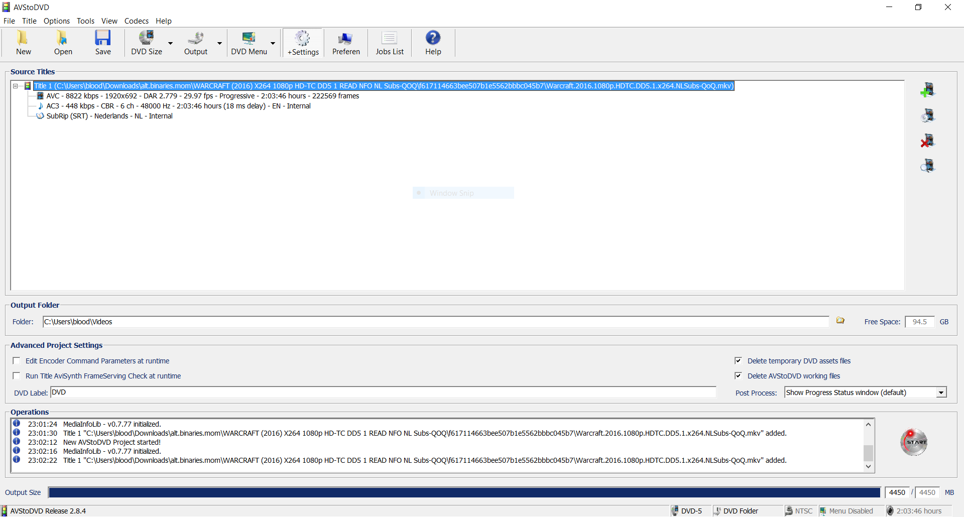

    hi all, having problems with avstodvd again, getting this happen with quite a few files pretty much before the process starts, also it won't create a menu for these titles either, also I tried uninstall avstodvd and reinstall and having problems when reinstalling,comes up with error messges when installing avstodvd
    here is a log for one file I am having the p[roblem I get with a lot of files all of a sudden

    First of all you should disguise the movie file names when you post a log like this. NO need to announce to the forum you're using a
    pirated source.. I'm not being a fuddy duddy, I believe quite a few forum members do so, we just don't advertise it.
    Secondly, one way to troubleshoot would be to copy all the script from he project/avisynth tab into Notepad and save as test.avs on your desktop.
    Then either drag and drop the avs file onto Virtualdub or right click it and select "Play'.
    See if you get a better error message this way

    Here's something to try. Create another one line avs file as you did before in Notepad. It will reference the movie file you copied
    to the desktop. It should say -
    directshowsource("C:\Users\blood\Desktop\movie.mkv.mkv")
    When you do this, save it to the desktop as before call it testds.avs, and drag open it in Virtualdub as you did earlier and make sure the movie
    appears and it can play

    There's one thing you could try first, open avstodvd fresh (no project loaded). Get into Preferences/avisynth tab and change video source filter from a2dsource to
    ffmpegsource. OK out. Now add the movie you copied and renamed from the desktop, setup your project and give it another try. Post the log again if it fails
    Have you tried it with another movie in case there is anything wrong with the source file ?
    if you want to use a smaller source for testing, before you start the operation, on the edit title/avisynth tab, you can deselect
    "auto avisynth script", select trim, trim start 0, trim end 3000 (for only 3000 frames)
