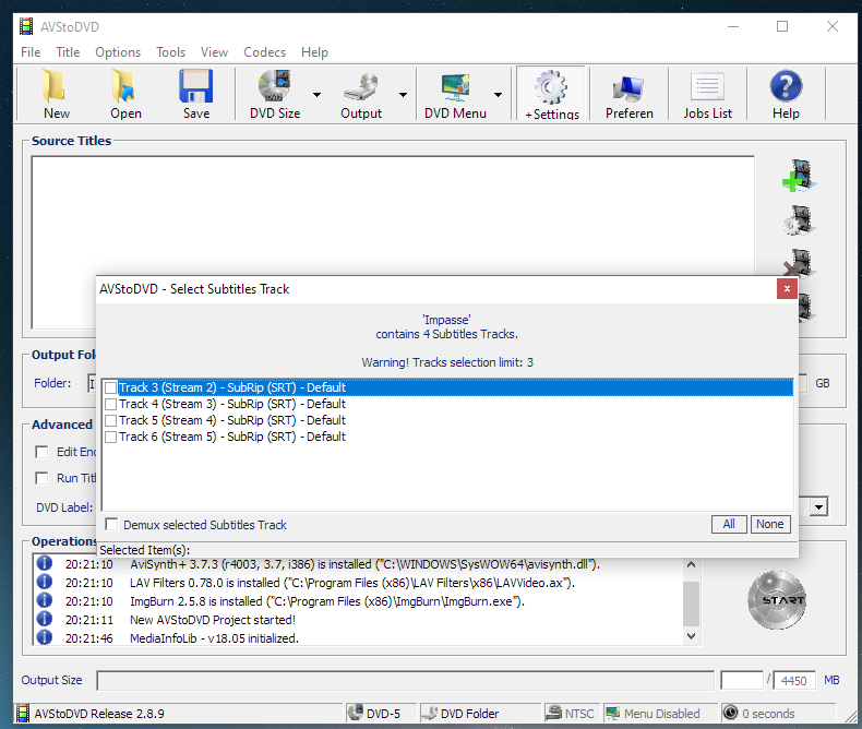

    When I drag an MKV file to the window I get a box that looks like this - lets me select up to 3.
    If necessary remux to MKV using mkvtoolnix GUI
  22. Thanks davexnet. I get that dialogue similarly, offering me the choice of audio tracks. Having selected the one I want, I click on the red cross to close the dialogue window, which seems slightly counterintuitive (one might expect a 'confirm' button or equivalent), but that seems to be the only way to proceed, unless I'm missing something? I would expect the program hopefully to then offer me the choice of subtitle tracks in the same way, but it doesn't.
    I'll have a look at mkvtoolnix!
  23. OK, sorry if I'm being stupid here, I installed mkvtoolnix, opened one of the .mp4s, selected one of the two English subtitles (not sure why there are two but I'll worry about that later), ran it, that created an .mks file which AVStoDVD doesn't recognise as a subtitles file...
    I suspect the best way to proceed is just to select the correct subtitles file within AVStoDVD rather than extracting a separate file, and that I'm doing something wrong with the dialogue boxes. Please advise!
  24. Member
    Mar 2008
    I meant to create an mkv file of all the streams contained in the mp4 (video, audio and subs) and try that as the source.
    Regarding the interface, it may be a little unconventional in 2 or 3 places, but it works as you described.
    Check off the subs you want then close it with the red X - those checked items will be included.
    If that doesn't happen look at the log for the details
  25. Thanks - apologies, I WAS being stupid, I see what you mean now! It's quite a sledgehammer solution but ought to work - I'll give it a go.
    I guessed that the red X was the correct thing to do (by a process of elimination!) - unfortunately, having selected the audio, it doesn't then go on to offer me the choice of subtitles, I don't know why. (I know that the file has multiple audio and subtitle streams because they work fine in VLC.) So I'll try the mkvtoolnix method.
  26. OK, I take it back - yes, mkvtoolnix has created another 7GB file, but it took less than two minutes to do so. And because the resulting file had only one audio track, it let me select the (only) subtitles track. I'm running AVStoDVD now - hopefully it will work now!
