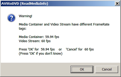

    The first thing I did was open the file in AVStoDVD,
    I know jc8952 posted he was using Windows 10 but I do not remember if it was 64 or 32 bit.
    I will be using Windows 7 32-bit.I'm using the latest version.
    At the start I got this Message for the .mp4:
    [Attachment 82192 - Click to enlarge]
    This changed my first step.
    I did the simple conversion I posted in #298 with ffmpeg.
    The .mkv did not get the error message.
    I hope the fix is this simple but probably won't be.

    cholla, I'm using Windows 11 64 bit. As for that warning I always get that for all of these recordings, not just this one. I just click OK and it usually works out. I don't usually have a problem like this one.
    I'm not sure what you mean about doing a conversion with ffmpeg. I tried using ffmpeg in the AVStoDVD for the audio and video preferences.
  9. Originally Posted by jc8952 View Post
    I hope that won't make a difference.
    Selecting "OK" keeps the 59.94fps.I doubt it makes much difference.

    Try this:
    Make sure that LAV filters is enabled for video (H264/AVC) and audio (aac)
    in codecs/preferred directshow codecs setup.
    Modify the Preferences on the Avisynth tab so that
    video and audio source filters are set to A2dsource.
    Load the source file and when you get the box that cholla mentions above choose "cancel" for 60 fps

    Then you can try that .mkv with AVStoDVD.
    I will post if this works or not.

    I believe the very slow re-encode is partially caused by the corrupt .mp4 file.
    The rest is CPU slowness.
    Since my GPU is onboard I do not believe it is even being used.
    Even though I have HDD's I believe they are fast enough.
    @ jc8952,
    I guess the first transfer from the DVR through the ClonerAlliance Box Evolve device was corrupt for some reason.
    The second try came out OK.
    Did you make any different settings for the "device" ?
    I'm guessing it has some settings.
    What settings did you use for AVStoDVD for example FFMpegsource or A2DSource ?
    Any other you might want to add.

    Opening the source in Avidemux and trying to take a clip fails as Avidemux tells you it has "Invalid Timestamps".
    Based on this it doersn't matter which settings or source filters in A2d are used, the file is bad.
    I remuxed the source using MKVtoolnix and it now seems to be a good file; Avidemux doesn't complain.
    I'm doing a quick run inA2D to see if this has fixed it.
  30. Originally Posted by davexnet View Post
    I have Avidemux 2.7.4 32-bit. I loaded the video & cut it to make a clip.
    Do I need to let Avidemux complete the clip before I get the error ?
    Just loading the video did not give me an error about timestamps .
    Probably a good software to use for this.
    That is what I plan to do when ffmpeg gets finished.
    It is getting close.
