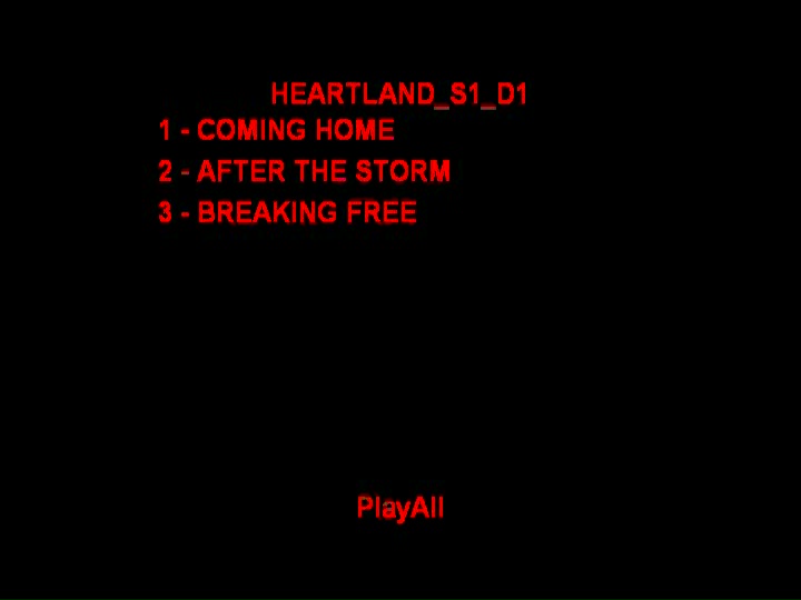

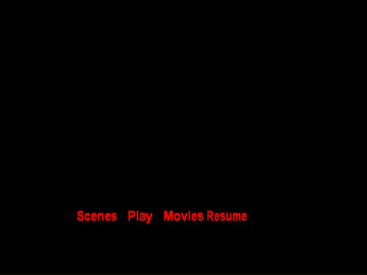

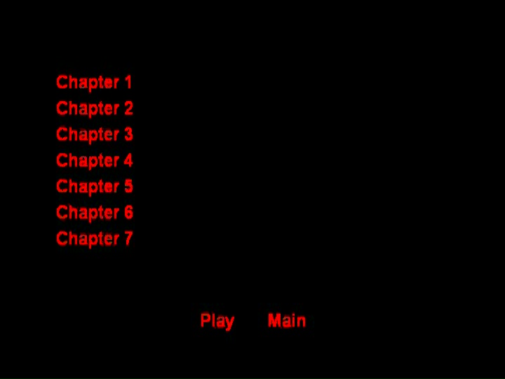

  10. @ Lathe,
    I have used this program many times to create a menu.
    It is what I use when I want to do a menu for a TV series so the episodes can be selected individually.
    TitleWriter
    Here are some menu samples I've done:
    I just us a black.jpg for the background & choose the font & color in TitleWriters GUI.
    [Attachment 82065 - Click to enlarge]
    [Attachment 82066 - Click to enlarge]
    [Attachment 82067 - Click to enlarge]

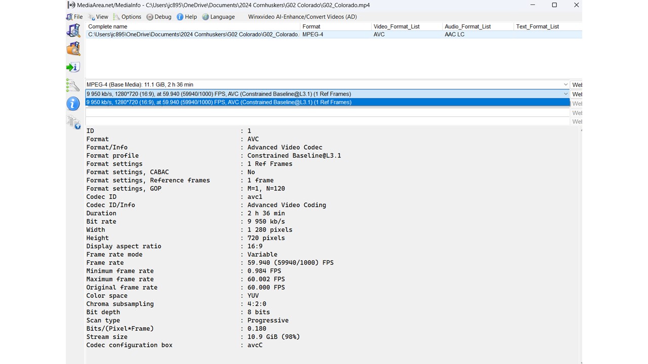

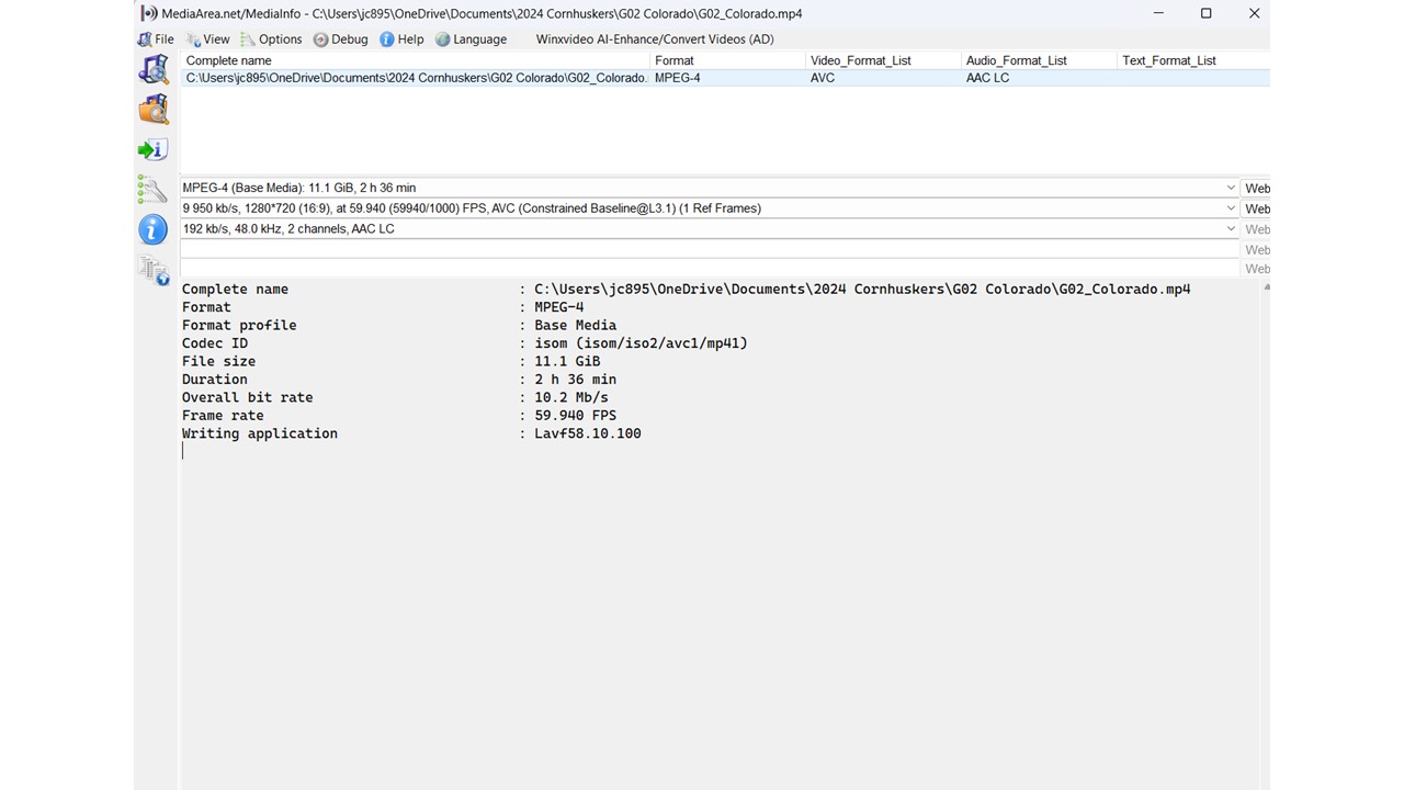

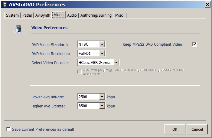

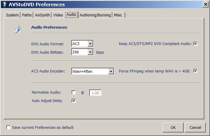

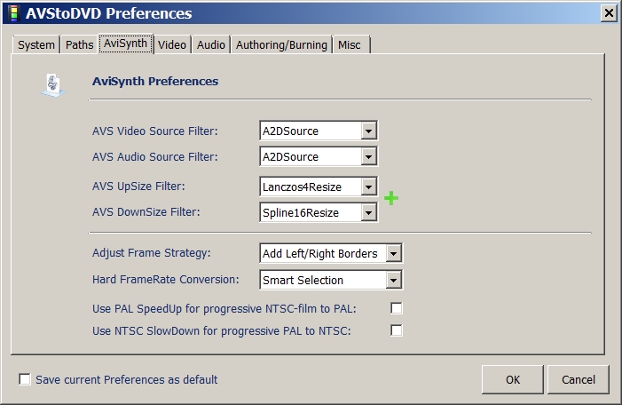

  13. @jc8952,
    Do you have MediInfo?
    Post what it says if you do. From the .mp4 file.
    It should show if the video & audio tracks are the same length.
    This is how I have AvstoDVD\Preferences set:
    [Attachment 82069 - Click to enlarge]
    [Attachment 82070 - Click to enlarge]
    [Attachment 82071 - Click to enlarge]

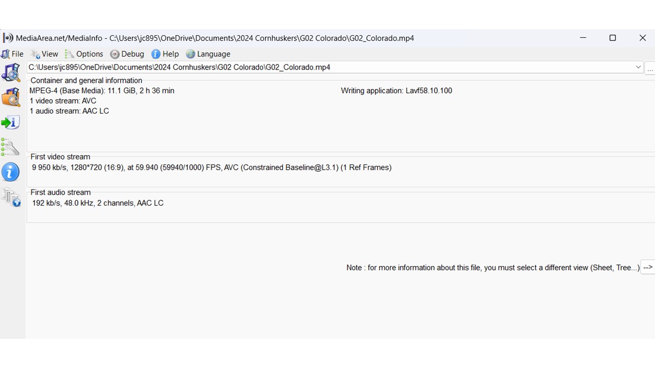

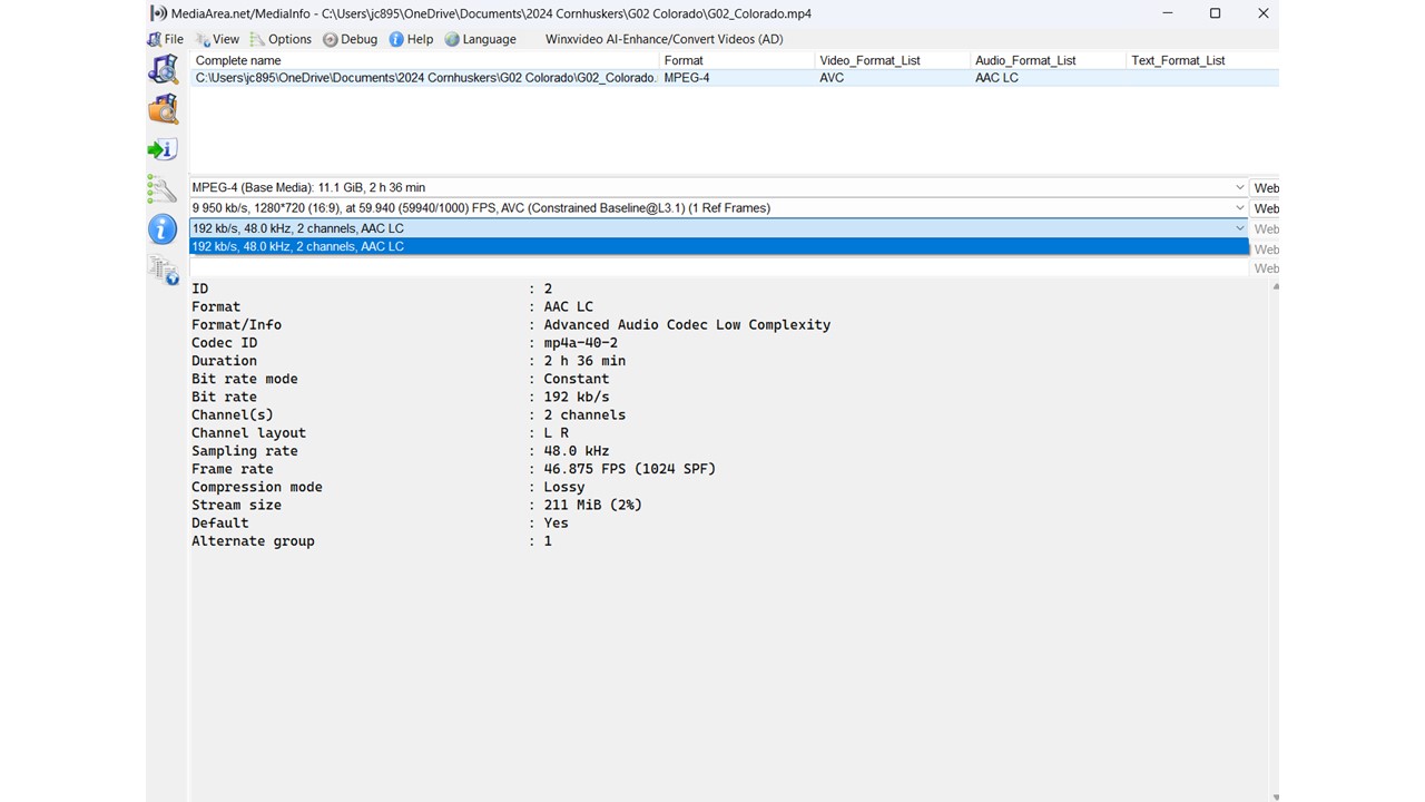

    Jan 2014
    Western Arkansas
    [Attachment 82068 - Click to enlarge]
    here is the screen shot of MediaInfo with my mp4
  15. You need to choose View\Text.
    Then show the Video & Audio stats.
    These will have the length of each.
    Mar 2008
    Important stuff not shown.
    You have to set view/text (or view/tree)
    Jan 2014
    Western Arkansas
    the video and audio are both 2 hours 36 minutes

    Originally Posted by cholla View Post
    @ Lathe,
    TitleWriter
    That looks like a good way to do it.
  19. @jc8952,
    Try the settings as I have them in the post#283 examples.
    If your video is still out of sync after that I believe it is a timestamp problem.
    It might be fixable using ffmpeg with command line.
    ffmpeg is a might fix solution & it also might not fix the problem & be a waste of time.

    thank you for your help. I usually use 'smart selection' in the preferences. I will try your suggestion but it will be late tonight before I will be able. I'll let you know what happens.

    I don't think the stream length in mediainfo is always accurate,
    can't rely on that. Mediainfo doesn't run through the whole stream to check,
    it's either inferred or it comes from the header

    Cholla I tried the settings you had in post #283 and it didn't make any difference. The audio is still out of sync. I don't understand this. I have been making mp4 captures of TV to DVD videos just like this for a couple of years now and haven't had this problem before.

    The video is variable frame rate, this often causes problems
    Did you attempt what I mentioned earlier?

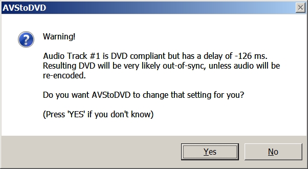

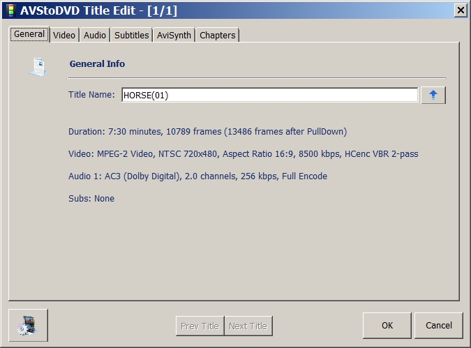

  24. @jc8952,
    Did you also make settings in the "Settings" for this video in addition to the "Preferences" settings ?
    If you left the settings at default then it did "Auto Video Setup" & "Video Direct Stream Copy".
    Also "Auto Audio Setup!" &" Audio Direct Stream Copy".
    You want to uncheck all of those for a full encode.
    The "General tab should look something like this:
    [Attachment 82114 - Click to enlarge]
    You may also get this warning:
    [Attachment 82111 - Click to enlarge]
    Sometimes you have to try it both ways to get the video correct.
    If AVStoDVD still fails then you probably have a timestamp problem.
    As I posted ffmpeg might be able to correct that.

    what's really frustrating is the original mp4 file plays just fine with no sign of audio being out of sync.

    When you extracted the audio and saved as a WAV, what was the length in hours, minutes and seconds?

    I have attached a clip from near the middle of my mp4 source video. I have the full video on Google Drive
    https://drive.google.com/file/d/1T7yLa-58Eu-aMQ_WW7Ku1ALXGg34zQmV/view?usp=drive_link here is the link to my Google Drive for the full video.
  29. Member
    Jan 2014
    Western Arkansas
    Davexnet, When I open the WAV file it is exactly 1 min. shorter than the video. WAV is 2 hours 35 min. 13 sec. When I open the orginal mp4 it says 2 hours 36 min. 13 sec.
