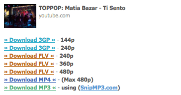

    Name:  Schermafbeelding 2013-02-11 om 16.43.24.png
Size:  29.6 KBIn some cases, if there's a 480p FLV download available, the MP4 download goes up to 'Max 480p'. What to choose in those cases? 480p seems to give a higher picture quality than 'max 480p'.

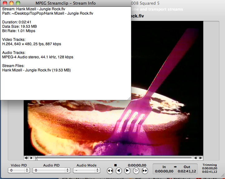

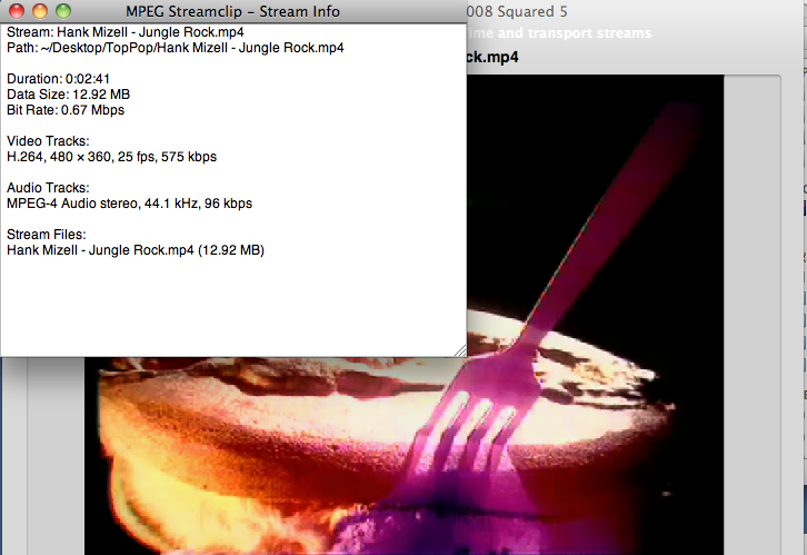

    I used MPEG Streamclip to analyse the differences between the FLV and MP4 video. It appears both have a H.264 codec, but he FLV video has a higher resolution and bitrate.
    I think I will go for the FLV video's, and than change the .flv extension to .mp4.
    [Attachment 16234 - Click to enlarge]
    [Attachment 16235 - Click to enlarge]
