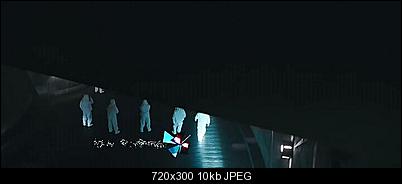

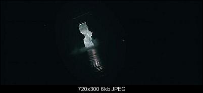

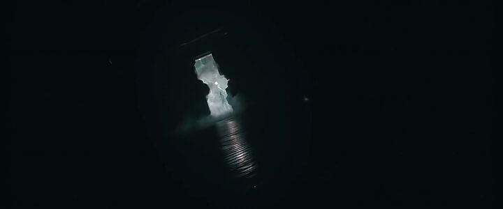

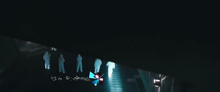

  1. Look at the two pictures:
Name:	Resident Evil Apocalypse.avi_snapshot_00.18_[2013.02.10_09.11.34].jpg
Name:	Resident Evil Apocalypse.avi_snapshot_00.35_[2013.02.10_09.11.59].jpg
    I'm converting 1080p h.264 to 480p Xvid, using the program media coder x64, I'm put the video bitrate as 6000 kbps, but in transitions from the dark to the light part the image is checkered, with a lot of squares, what settings should do to solve this problem? Thank you!
    Mar 2011
    Nova Scotia, Canada
    There are reports of bit rate problems with this program. Check if it's what it's near what it's supposed to be with mediainfo.
    Are you using target bit rate or file size mode (the same thing really) in one pass? You can get fast results that way but not good ones, and I don't think a high bit rate would help that much. Try one pass quality based if so, or 2 pass bit rate. I always use the former for xvid but it doesn't give you precise file sizes.
    I haven't used media coder because the reviews did not look good. Since I don't think it's available under linux it's unlikely I will. But I almost always use avidemux for xvid conversion, and I've never had any problems since figuring it out somewhat.
    Beware 'easy' video encoders. Handbrake and vidcoder (the same engine, different interface) are the only good ones I've seen that are fairly easy. But if you want to encode to xvid with handbrake you have to install an older version.
  3. Dark areas like that are always a problem with Xvid. At least be sure that the min quantizers are set to 1, and disable B frames. For PC playback be sure the deblocking filters are enabled.
  4. Originally Posted by Hoser Rob View Post
    There are reports of bit rate problems with this program....e to install an older version.
    I'm use average bitrate in 6000 kbps, not matter how I increase bitrate, quality is same, already tried 2 -pass, without result.
    In Avidemux can not put the quantizers in 1 but only 2, the result is already better than what I was posting, but the average coder without B-Frames with quantizers and first in quality greatly improved, but still is not perfect ... .
    Thanks, and sorry my english weak, I from Brazil, and I have to practice my English more.

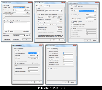

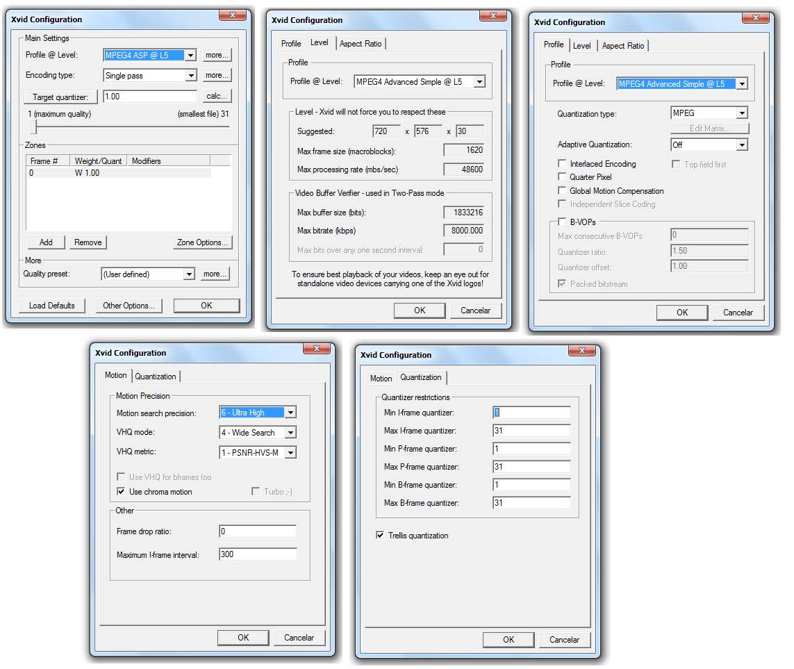

  21. Yeah I tried a few different debanding/deblocking methods, and while I found one or two which actually seemed to improve it without making a mess of the rest of the video, once Xvid was added to the equation it was all over. All that filtering only made a tiny difference.
    By the way, unless you're using some bizzare Xvid settings which make the video really hard for it to compress I'd be thinking 6000kb/s is kind of excessive for 480p. When I ran a few test encodes I just used single pass encoding at maximum quality, 720x300, and fairly unadventurous Xvid settings, and the bitrate was around 1400kbps. I don't think I've ever encoded a 480p Xvid/Avi which got even close to 6000kb/s.
    Maybe it's time to buy a cheap USB media player you can just connect a hard drive to and save yourself the trouble of converting?
    And especially seeing as you're encoding with Xvid while converting HD to SD and I'm OCD enough about it to make failing to do so a capital offence when I'm ruler of the world.... I thought I'd ask.... are you converting the colors when re-encoding? If you're using an AVISynth based encoder GUI, adding this to the script will do it (include the path to wherever Colormatrix is on your PC to load it as usual if you don't have it in AVISynth's plugins folder):
    ColorMatrix(mode="Rec.709->Rec.601", clamp=0)
    I've no idea if or how you could get MediaCoder to do something similar.
    If MeGUI is causing you problems when encoding with Xvid it'd probably pay to check the log files. That's likely to give you an idea where the problem is. How old is the version of MeGUI you're using? There's an option in MeGUI's settings to tell it not to delete intermediate files which will hopefully stop it from doing so if it gets to the "can't go on any longer" stage, and more recent versions will warn/ask you before deleting intermediate files if the job didn't complete successfully.... I think. If you don't use the development update server in MeGUI's options, try switching to it and getting MeGUI to check for updates.

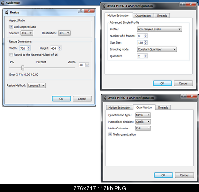

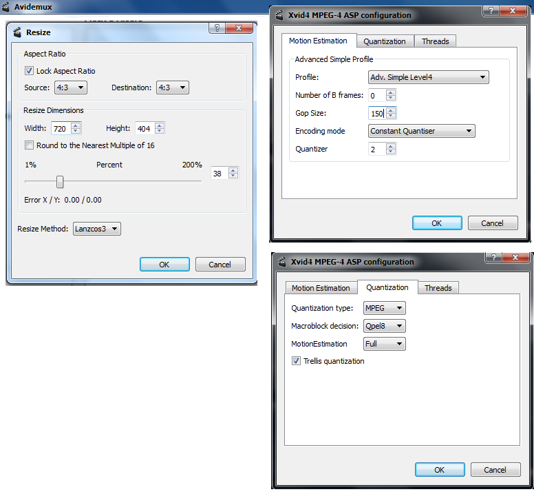

  24. Originally Posted by Nobility350 View Post
    Joining several tips obtained here and Avidemux + latest version of the Xvid codec, got satisfactory results for what I was expecting, especially compared to what I was originally getting.
    Maybe should summarize what you did. It will help the next person.
  25. Originally Posted by jagabo View Post
    I'll post pictures of the settings below, although good, avidemux does not have many options, so I changed some parameters in xvid encoder, not sure whether or not they affect the end result ... any suggestion of change,please post
