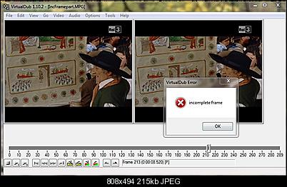

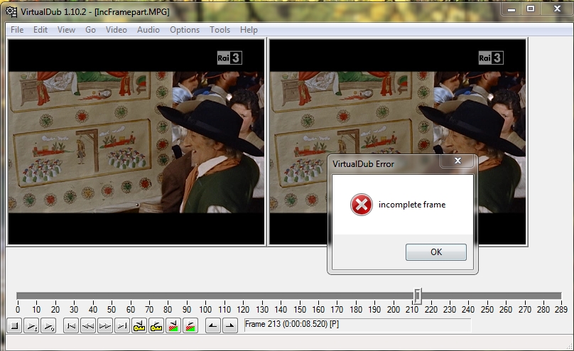

  1. Hello. I'm trying to use VirtualDub instead of Handbrake for my conversions from MPEG-2+MP2 to x264+MP3, but in my first video the conversion stops after at about 28 minutes with a pop-up message that says "incomplete frame". I started the conversion after that point and it keeps on regularly.
    I discovered that the error pops up during a simple playback too.
    So, instead of using a repairing tool, is there a way to tell VirtualDub to ignore the error and skip that frame? (both audio and video, obviously, to keep the synchronization). It's not so important to me a rare single frame in a 1 and a half hour long movie that I'll delete after having watched it.
    Repairing takes additional time, so I'd like to avoid it in these cases.
    EDIT: I forgot to say that I launched the "scan video stream for errors" function, but it gave me no relevant results: "0 frames masked (0 frames bad, 0 frames good but undecodable)". Maybe the problem is in the audio stream?
    Please IGNORE what I previously wrote here in the quote (the error is NOT located near a cut):
    Anyway, the error is located in a point where I cut some minutes off the original movie. As starting and ending markers for the cut I chose two frames without looking their kind (b/p/i). I suppose that this is the problem, and that setting markers in keyframes (i type, if I got it) should solve the issue, but leaving unwanted (ads) frames in that point. Is it correct? (in both cases I'd like to know the answer to the previous question: "can VirtualDub ignore this error?"...)

  5. I re-opened the original video, but the simple playback of that point gives the above mentioned pop-up error ("Incomplete frame"). And if I advance some frames forward, I discover that it's not a single frame but about ten incomplete frames. After the last the playback continues correctly.
    "Preserve empty frames" doesn't change the situation.
    I suppose that now I should try passing the movie through Projectx or Pvastrumento (I can only use freeware and these are the only ones that I know)...
    Or I could manually cut those frames away in VirtualDub, but how can I know if there are more of them in other points of the movie?
    P.S.: I played the original file in VLC, and it actually is damaged in that point. I think it's an error caused by the TV recorder. When played in VLC, the image "stops" for a while, then the movie continues with some "blocks" in the moving areas for about two seconds, and finally goes on correctly.

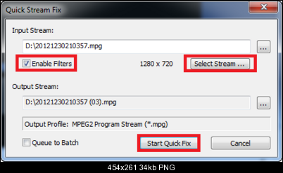

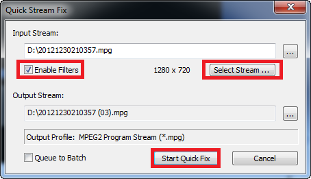

    Try VideoReDo.
    After install, open vídeo file and select Tools, Quick Stream Fix (Config like shot below):

    FWIW, here's a clip with the same symptoms when opened in VirtualDub.
    It throws the error at around seven seconds - however when it's opened using the ffinput plugin it plays ok.
    http://www.mediafire.com/download.php?iy4o5w65vtk53db
  13. Sambat, thanks for that sample. I've added it to my folder odds and ends. I wish you had included a few more GOPs past the error.
    Using the MPEG 2 plugin for VirtualDub I get the same "incomplete frame" error message when previewing. But when using DgIndex to build an index, AviSynth to open the video with Mpeg2Source(), then opening the AviSynth script in VirtualDub I was able the preview the entire clip. Forcing the DirectShow input driver worked too but that will be dependent on what DirectShow components are installed on a system. And DirectShow isn't frame accurate so editing in VirtualDub may be inconsistent.

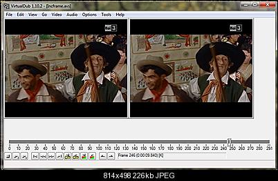

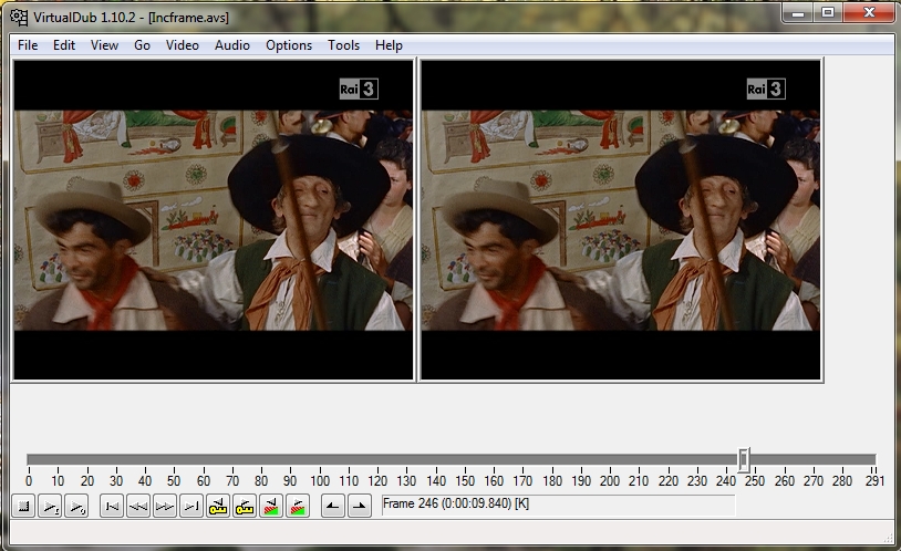

    I posted info on my website (http://Budmansite.com ) under Virtualdub -> Playing files with errors or missing codec problem. By using AVIsynth and loading an AVS file (Directshowsource("PathToVideo.mpg") the video will be loaded as raw data and will play past the error.
    This assumes Media player will play the video or at least attempt to. Media player will play your test video so I used AVS file to load into Virtualdub and it plays all the way through as seen below:
Name:	ScreenHunter_466 Feb. 11 16.03.jpg
ID:	16228 Error with Virtualdub decoding.
Name:	ScreenHunter_467 Feb. 11 16.03.jpg
ID:	16229AVS file loaded and played with directshowsource. No error past error point.

    Thanks a lot Jagabo . I read the guide and created this simple script, but...
    LoadPlugin("C:\xyz\dgmpgdec158\DGDecode.dll")
    LoadPlugin("C:\xyz\Avisynth_Filters\decomb522_25_dll_20050904\Decomb.dll")
    LoadPlugin("C:\xyz\Avisynth_Filters\mpasource_20080220\mpasource.dll")
    video=MPEG2Source("C:\movies\mymovie.d2v")
    audio=MPASource("D:\movies\mymovie Tc0 L2 2ch 48 192 DELAY -22ms.mp2")
    fielddeinterlace()
    AudioDub(video,audio)
    ... Virtualdub gives me this pop-up Avisynth error message when opening the ".avs" file:
    Avisynth open failure:
    Script error: Invalid arguments to function "fielddeinterlace"
    I also tried moving "fielddeinterlace" just after the "video=" row and before the "audio=" one, but it's the same.
    And even tried to make the parameters explicit this way:
    fielddeinterlace(full=true, threshold=20, dthreshold=7, blend=true, map=false, chroma=false, ovr="", show=false, debug=false)
    Same error.
    What's wrong with that? I simply followed the guide script... (the simple way, not the one with the template).
