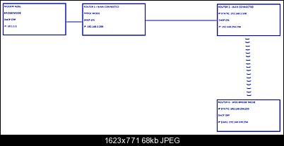

  15. Lone soldier Cauptain's Avatar
    Jan 2006
    Brazil
    Sorry Yoda, I´m based on my config.
    My setup: ADSL Modem + 3 Routers TL-WR1043N
    ADSL Modem in Bridge mode, DHCP off, IP: 10.1.1.1
    Router 1 in PPPOE mode connected wired on Modem, DHCP on, IP: 192.168.254.254
    Router 2 connected using Wireless Bridge mode on Router 1, DHCP off.
    Router 3 connected using Wireless Bridge mode on Router 1, DHCP off.
    If you use Cable modem, its few different setup.
    Cable modem active connect, DHCP on.
    Router 1 connected using in LAN Wired connection from Cable Modem, DHCP off.
    Router 2 connected using in LAN Wired mode on Router 1, DHCP off.
    or
    Cable modem active connect, DHCP off.
    Router 1 connected using in WAN Wired connection from Cable Modem, DHCP on.
    Your computer and xbox 360 hooked via lan not change anything.
    Claudio

  17. Lone soldier Cauptain's Avatar
    Jan 2006
    Brazil
    Hi Yoda,
    For connect via wireless, search for WDS BRIDGE mode on new router.
    Keep mind:
    Modem/Router 1 DHCP on >>>>WDS BRIDGE MODE>>>>Router 2, DHCP off, no IP Static.
    Modem/Router 1 DHCP on >>>>LAN MODE>>>>Router 2, DHCP off, IP Static.
    Claudio

  19. Lone soldier Cauptain's Avatar
    Jan 2006
    Brazil
    My home setup:
    Remember:
    Bridge Mode (on MODEM ADSL) is NO same WDS Bridge Mode (router 3)
    WDS Bridge Mode is NO same WPS Connect Mode.
    Claudio
