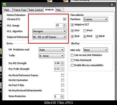

  1. If you want fast speed of x264 then use these settings marked with red rectangle on picture, these settings are about motion estimating and have nothing to do with picture quality and
    M.E. algorithm - Hexagon
    Subme - 6
    these settings are very enough to catch any changes between frames ..................
    and I think that XviD encoder is using Subme something about 3 or 4 ....... and XviD catchs all movements in any video

  2. these settings are about motion estimating and have nothing to do with picture quality and
    you should read up on how MPEG works and what motion estimation is for because what you write there is just totally wrong.
    -> use the presets x264/MeGui offers to get faster encoding only mess with the other settings if you know what you are doing.
  3. nothing in 1-st post is wrong, these settings in Motion Estimation are for deciding (x264 encoder) what sholud be the next frame - B, P or I depending on how much changes (in motion) we have between neighbour frames .............. so you are wrong not me
  4. But the picture quality depends on the picture decision,...

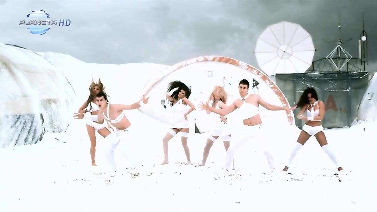

  24. here is my last encode with "--me=dia --subme=4" - http://thepiratebay.se/torrent/8121530/Andrea_-_Neblagodaren_HDTV_720p__x264_AAC-SSN
    and the resulting clip have very good picture quality and i get much faster encoding speed without getting any negative impact on picture quality ......so why we have to use "--me=umh --subme=8+" when we can go with "--me=dia --subme=4"
  25. Lone soldier Cauptain's Avatar
    Jan 2006
    Brazil
    Originally Posted by somespirit View Post
    here is my last encode with "--me=dia --subme=4" - and the resulting clip have very good picture quality and i get much faster encoding speed without getting any negative impact on picture quality ......so why we have to use "--me=umh --subme=8+" when we can go with "--me=dia --subme=4"
    Very good quality??
    My eyes, my eyes...
    Its ok
    Claudio

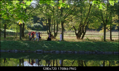

    Subpixel refers to the predictive motion vector : it's interpolating an "inbetween" value, so the difference between predicted and actual is less than if you were a full value away. Recall the residual is the difference between predicted and actual - this residual is what makes up the P and B frames. When you have more accurate motion vector predictions, there is less difference, thus less data needs to be stored in the residual = smaller filesize . This leads to higher efficiency - ie. better quality at the same bitrate. This is why better analysis and prediction helps to higher efficiency encodes. But the motion vector data is more complex and costs more - that's why you need RD optimization models to reduce the size - so this is sort of trade off (trade offs is what video compression is really all about)
    Yes, this is all theory, but it translates to reality. Just do some tests, it's easy to see the difference and these are pretty much established facts . The lower the bitrate range relative to content complexity, the larger and more noticable the differences. The higher the bitrates relative to content complexity, the more difficult to see the differences.
    e.g. parkjoy, 1280x720, 8Mbps , this is a b-frame in both encodes . If you were to use some setting inbetween - yes you guessed it - it would be in the middle in quality and speed . If you can't see the difference, either something is wrong with your test setup or you need to have your eyes examined .
    dia, subme 0
Name:	250 dia,subme0 Rec709.png
    multihex, subme 9
Name:	250 multihex,subme9, Rec709.png
