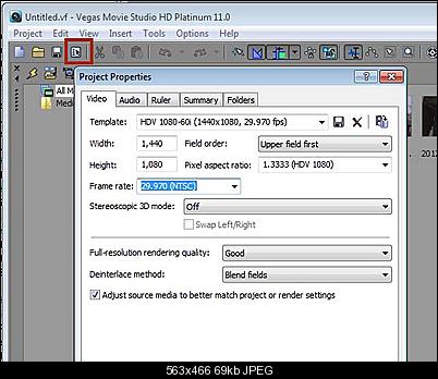

  13. In the file => project settings, change the deinterlace method to "interpolate" instead of "blend" . Blend will apply a blend deinterlace (blurry). In the render settings, whenever you render a progressive format, but the project settings and video are interlaced, vegas will apply a deinterlace
  14. Also make sure your project settings match your source footage, it should look something like this.
    If you're laying back to tape there's no need to deinterlace. If your goal is YouTube, follow poisondeathray's advice.
