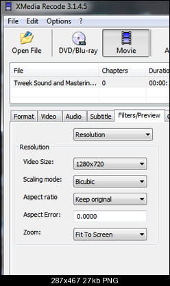

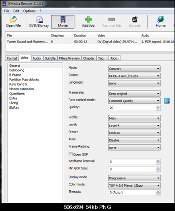

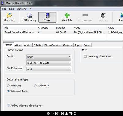

    the kindle has a dual cpu and dual gpu like my nook hd+, so it shouldn't have a problem with any 720p video. i'd use the xmediarecode kindle mp4 preset and only change the bitrate control to cq and start with maybe a cq of 20 for it. adjust down for higher quality and larger filesize, higher number cq for lower quality smaller filesize.

    and the video size is on the filters screen
