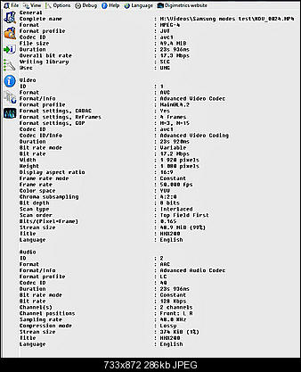

    copy a video from the cam to your computer and use mediainfo (it's free) on it. change mediainfo to text mode and copy paste the results here.

  4. Originally Posted by aedipuss View Post
    Thanks - hope this works!
    ric
