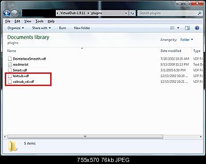

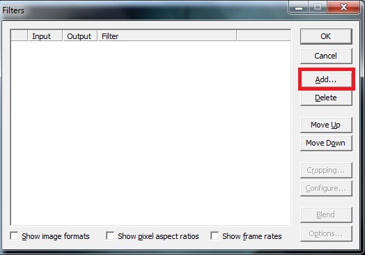

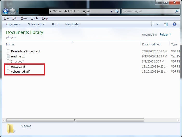

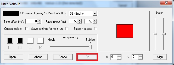

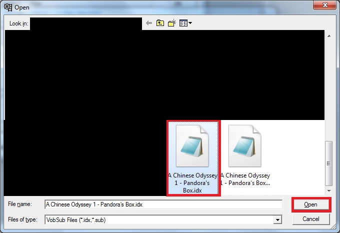

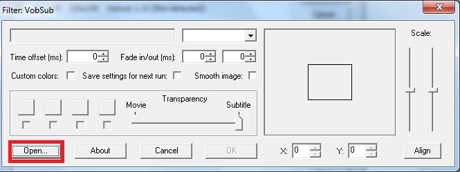

  15. Extract the files manono and put them in your plugins folder:

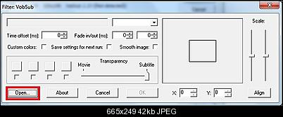

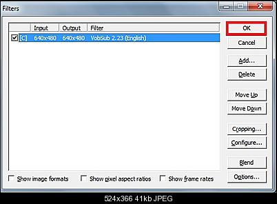

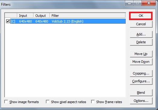

    Open up Vdub and do the following:

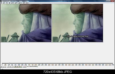

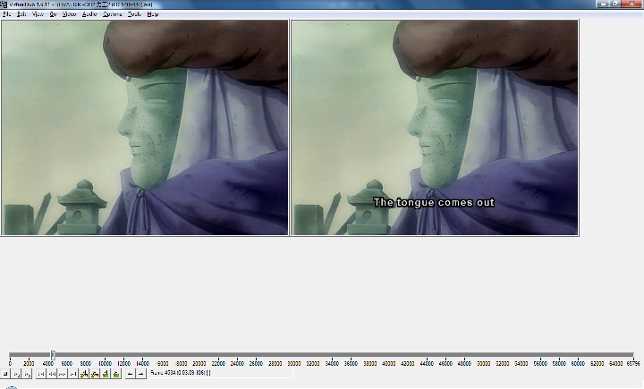

    Should look like:
