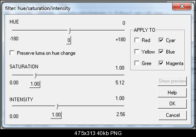

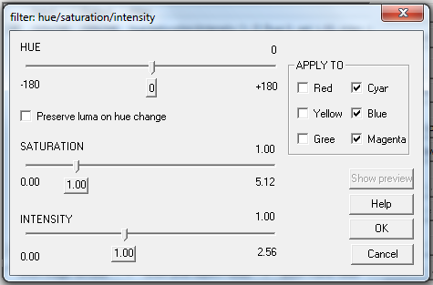

  8. Wow thank you!
    About how you change the colors, I just (as I said). listen to my eyes.
    but i playing with colors through ColorMil and same more plugings in VB .. I do not know exactly what say these graphs. But I just use ColorMil and see what happens.
    If there is a color I see it too hard, so I lower the saturation of the color by this for example:
    it much easy to do..
    Maybe it comes out as good but I do not believe it ..
    I think it's a good fast way to change specific colors

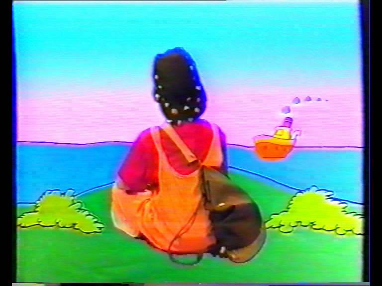

    I have to use MCTD on high settings + NeatVideo on high settings + super temporary cleaner 1.4 MT to cleen all the noise ..

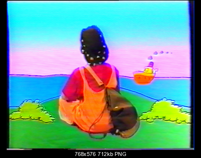

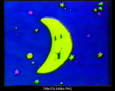

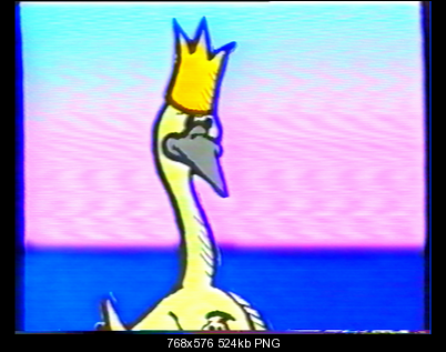

    i have a picture for you:
ID:	16173Click image for larger version
ID:	16174Click image for larger version
    I also use
    ChromaShift(C=2,L=-2)
    mergechroma(aWarpSharp(depth=50))
    for the big Chroma problem (as you can see on the last image)
    it takes 1.25 days to Process this
  18. Banned
    New York, US
    Biggest problem: according to the images you have posted, you could have saved much time and trouble by lowering saturation and contrast during capture. None of the filters you described will address those defects.
