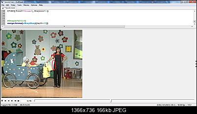

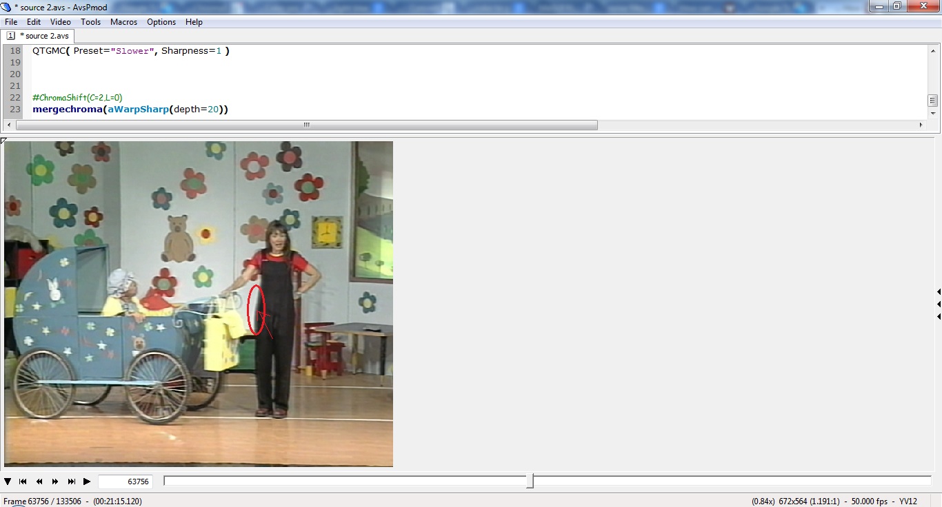

    The new script is done:
    loadplugin("C:\Program Files (x86)\AviSynth 2.5\plugins\FFT3DFilter.dll")
    loadplugin("C:\Program Files (x86)\AviSynth 2.5\plugins\aWarpSharp.dll")
    LoadPlugin("C:\Program Files (x86)\AviSynth 2.5\plugins\ChromaShift.dll")
    Import("C:\Program Files (x86)\AviSynth 2.5\plugins\QTGMC-3.32.avs")
    AviSource("D:\****\1.avi")
    ConvertToYV12()
    #MergeChroma(McTemporalDenoise(settings="low",interlaced=true))
    Crop(4,4,-44,-8)
    #SmoothLevels()
    FFT3DFilter(bt=-1, plane=0, dehalo=1.5, hr=2, ht=50, svr=0)
    Cnr2()
    QTGMC( Preset="Slower", Sharpness=1 )
    #ChromaShift(C=2,L=0)
    mergechroma(aWarpSharp(depth=20))

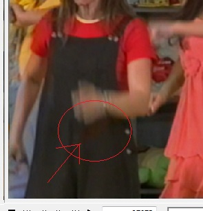

    Picture (after the script):
    I changed the
    mergechroma(aWarpSharp(depth=40))
    to

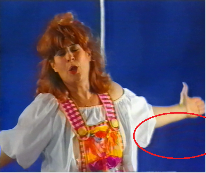

    i still dont know how to fix the problem i marked in the Pictur.
    i tried
    but it didn't effected on this problem..
    it just moved the other colors and not what it need to move...

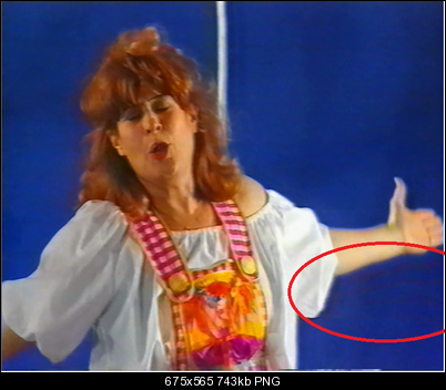

    i uploaded a new example of the new original recording
  5. Add AssumeTFF() after opening the video. ConvertToYV12() should use interlace mode, ConvertToYV12(interlaced=true). I'd try putting QTGMC() earlier in the script.
    ChromaShift() won't work with the oversharpening halos. hr in fft3dfilter() needs to be larger. Somewhere between 3 and 4. You might have to fiddle with ht too. BlindDehalo3() might work better but it needs to be tweaked so that it only works on the horizontal axis. Then use a better sharpening method. Maybe something involving nnedi3. Or, as suggested earlier, turn off the sharpening filters in your VCR.
  6. i have fixed it alone!
    this is the first time that i fix such a problem alone
    i found on google the plugin Ghostbuster.dll and downloaded it from here:
    http://forum.doom9.org/showthread.php?s=&threadid=35339
    then i added at the start of the script:
    loadplugin("C:\Program Files (x86)\AviSynth 2.5\plugins\ghostbuster.dll")
    and at the end i added:
    ConvertToYUY2()
    Ghostbuster(3, -20)
    i played With those parameters according to the "readme.html" file..

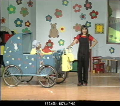

    this is before:
    and this is after:
    [Attachment 16097 - Click to enlarge]
    https://forum.videohelp.com/attachment.php?attachmentid=16096&stc=1&thumb=1&d=1359823252
    i just need to play With the brightness in VirtualDub.
    and jagabo, i did what you said to me
  7. IMO it doesn't look better
    There are other areas that are made worse, halos are accentuated more in some areas partly because of the change in levels and contrast. e.g. her left shoulder, left leg, background halos on the wall flowers...
    There are some artifacts introduced on the left border of the frame (white patches)
  8. Originally Posted by poisondeathray View Post
    Maybe you're right about the damage ..
    What happened in the left do not really good ..
    But the damage of light and color is a small problem .. There is less light leaks ..

    Originally Posted by gil900 View Post
    I found that Cnr2 ​​() does pretty big damage... I tested it many times.
    Both of your scripts that use it in this thread are using it on interlaced video. And the artifact is exactly what one would expect when used that way. So the evidence is you tested it wrong.
    And Ghostbuster() is for ghosting, not oversharpening halos. If you use it to fix the halo on one side of an object you will create or exacerbate the halo on the other side. Exactly what your sample image shows.
    only for checking on another tape,
    now the Cnr2() is after the QTGMC( Preset="Slower", Sharpness=1 )
    and the same problem occurs:
    But anyway it does not matter because I do not use it ...
  22. Originally Posted by gil900 View Post
    [Attachment 16103 - Click to enlarge]

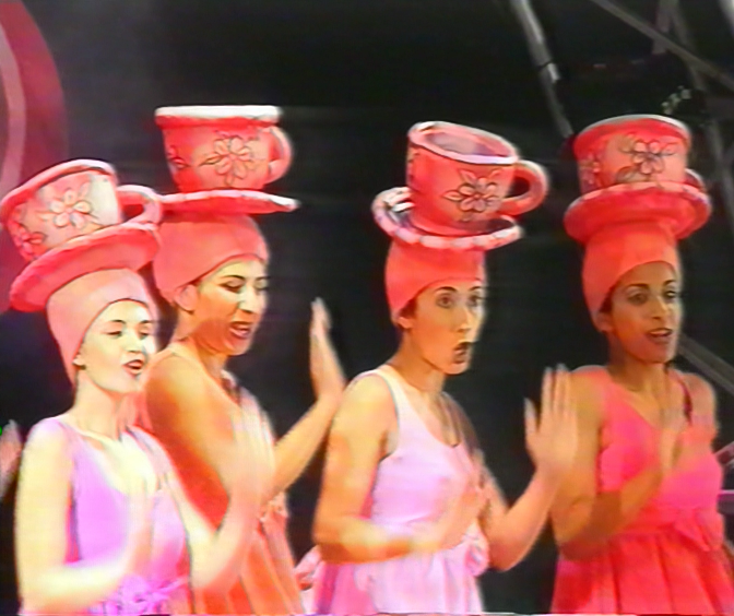

    EDIT:
    Meanwhile, I'm working on another recording with a serious problem of Ghosts
    and i trying to slove the problem by Ghostbuster().
    this is the problem:
    (frame 15238)
    but this ghost i can't slove perfectly.
    i traied
    Ghostbuster(40, -2)
    Ghostbuster(65, -1)
    Ghostbuster(52, -1)
    Ghostbuster(63, -1)
    and this is the result:
    It's still not enough ..
    What can I do?
    But do not think it's too bad ..
    In not dark Frame, it really improving the results.
    This erases the ghosts without signs (not dark frames)

    But as you can see, it's still not perfect ..
    I need advice on how to improve this or another way to do it.

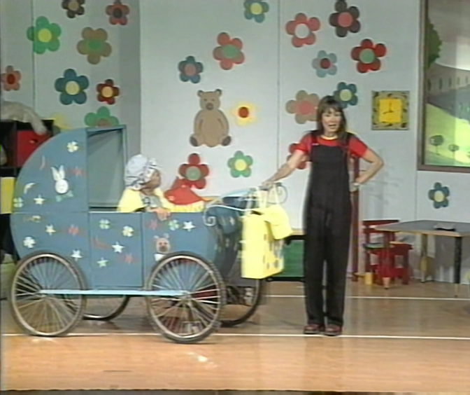

    I have no sample of the last group of images you posted, but the luma levels and chroma are really a mess.
    Here is a result with the previous new_sample.avi using a simiar script I posted earlier, but added GhostBuster. The same filter exists in VirtualDub as "Exorcist.vdf". One unfortunate side effect of all anti-ghost filters is some edging effects. After all, these filters "add" a mask image to the video and masks over the ghosts. You can't have everything.
    frame 41 (original)
    [Attachment 16113 - Click to enlarge]
    frame 41 (after):
    [Attachment 16114 - Click to enlarge]
    Some modesst finishing work was do0ne in VirtualDub. In Avisynth, for ghosting and edge oversharpen artifacts:
    # --------- YUY2 only -------------
    AssumeTFF().SeparateFields()
    GhostBuster(6,-14)
    FixVHSOversharp(20,16,12)
    FixVHSOversharp(20,8,4)
    FixVHSOversharpL(20,12,8)
    Weave()
    ColorYUV(gain_y=5,gamma_y=5,off_y=6)
    ColorYUV(cont_y=10,cont_v=5,cont_u=10)
    Tweak(sat=1.1)
    AssumeTFF().QTGMC(preset="fast")
    SelectEven()
    ConvertToYV12(interlaced=false)
    LSFMod()
    MergeChroma(aWarpSharp2(depth=40))
    FixChromaBleeding()
    DeHalo_Alpha()
    GradFun2DBmod()
    Crop(4,0,-22,-10).AddBorders(12,4,14,6)
    # ---- conmvert for RGB work --------
    ConvertToRGB32(matrix="Rec601",interlaced=false)
    return last
    [Attachment 16106 - Click to enlarge]
    (frame 15238)
    i traied
    Ghostbuster(40, -2)
    Ghostbuster(65, -1)
    Ghostbuster(52, -1)
    Ghostbuster(63, -1)
    [Attachment 16107 - Click to enlarge]
    What can I do?
    It's bad. You're not using the plugin effectively. See the previous post with GhostBuster and other plugins. And that's a very noisy dark background.
  28. [QUOTE=gil900;2217664]
    (frame 15238)
    i traied
    Ghostbuster(40, -2)
    Ghostbuster(65, -1)
    Ghostbuster(52, -1)
    Ghostbuster(63, -1)
    Not enough? You've made it much worse. You've reduced the "ghost" of her arm but created dark ghosts of her face and shirt in the dark background. Look to the right of her face and shirt.
