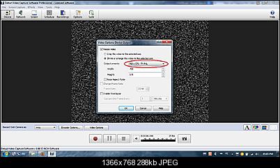

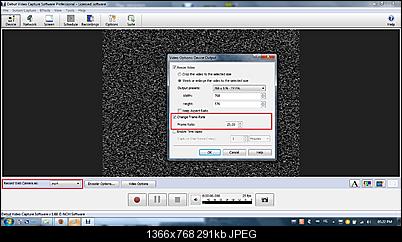

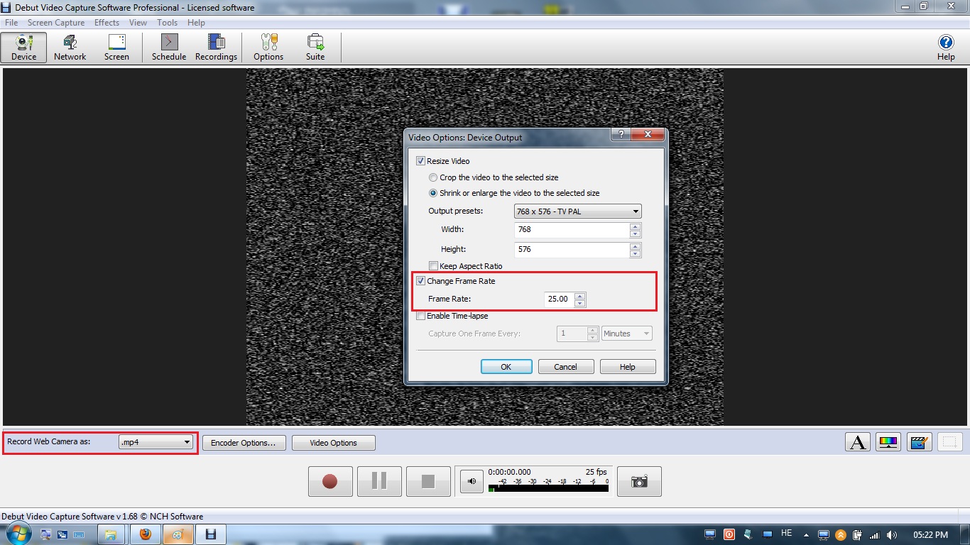

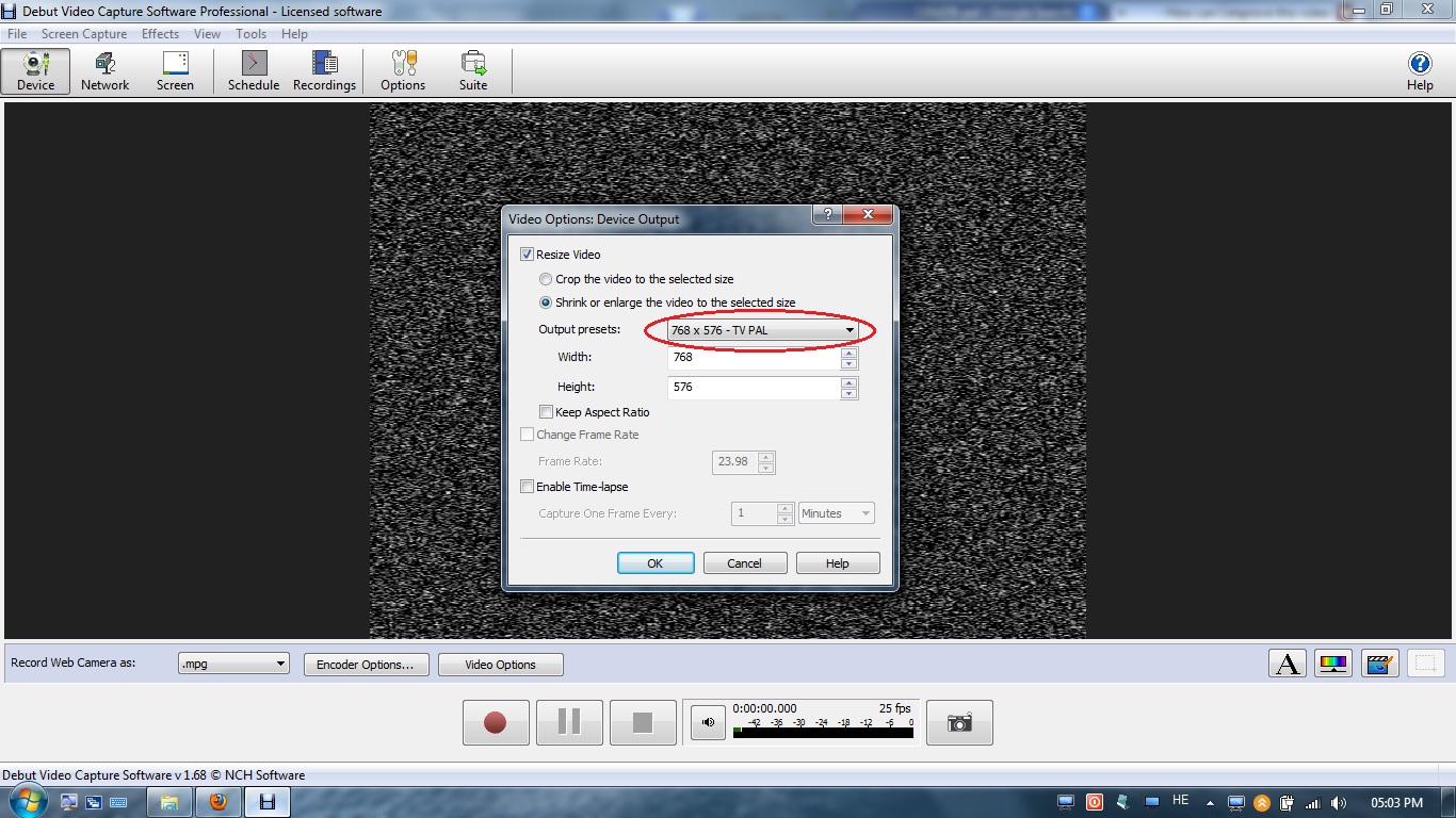

  1. in my software i see that PAL TV restitution is 768x576 and not as you say - 720x576
    so i checked on google what is 720x576 and sow that 720x576 is a 16:9 widescreen restitution..
    Or am I wrong?
    So what do you say? Record on the resolution 720x576 or 768x576 ?
    EDIT:
    and as you can see, i can't change the frame rate in the software...
  2. PAL D1 video is 720x576. PAL DVD uses 720x576 for both 4:3 and 16:9 display aspect ratio. 768x576 is the equivalent display resolution for 4:3 PAL video (when retaining the 576 line height). If your software doesn't allow PAL capture at 25 fps it is severely defective. Analog PAL has only one field rate: 50 fields per second. When digitized those fields are packaged in pairs to make 25 frames per second digital video.

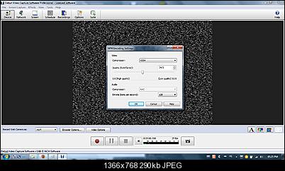

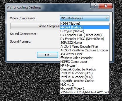

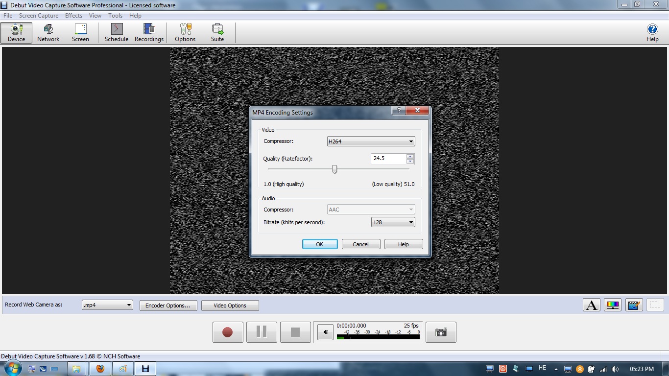

    and i chaked again and sow that if i change in the software to record to mp4 file then i can change the frame rate:

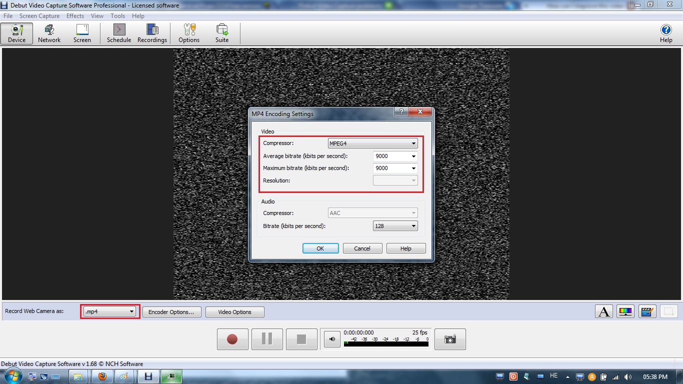

    but what settigs is the best for mp4 file?
    this is my settings:

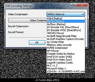

    i want to record with compressor because i no space in my hardisk for big files...
    i can set H264 or MPEG4 in the compressor...
    if i record to avi file with compressor than i have a very high CPU use..
    EDIT:
    the H264 compressor is verry havy for the CPU.
    it takes 99% of all my 4 cores..

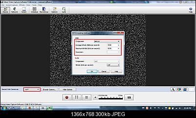

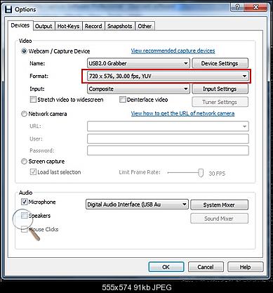

    this is the settings that working best:
    what do you thing?
    i need to change something in the settings?
  4. If you're serious about cleaning the video you should capture YUY2 video with lossless compression (HuffYUV, Lagarith, UT, etc.). That way you will avoid all the problems of high compression codecs -- loss of detail (not that VHS has much detail), blocky artifacts, temporal noise artifacts, etc.
    If you can't afford that much disk space (~40 GB/hr) and have to use high compression codecs, use the highest bitrates you can. But it's absolutely critical that you capture PAL video with 525 scan lines and 25 fps.

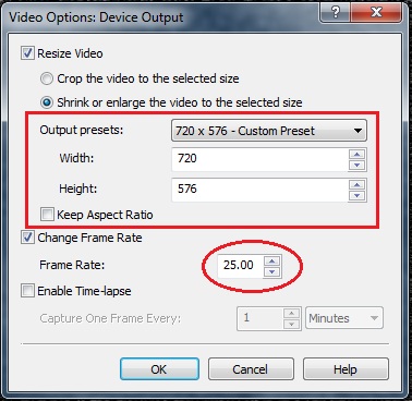

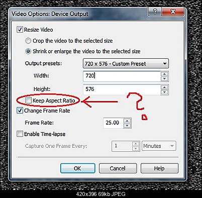

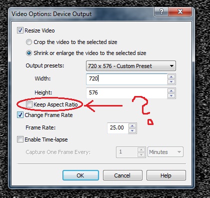

  6. Capture at 720x576 and 25 fps interlaced. That's the international standard (ITU/BT 601) for analog to digital PAL capture. If you can't do that capture at 768x576 25 fps interlaced instead. But you should look for software that conforms to the ITU specs.
    OK
    do i need to select "keep aspect ratio"?
    EDIT:
    what?
    this is the bast software i found on the internet...
    what is ITU specs?
  8. Originally Posted by gil900 View Post
    [Attachment 16063 - Click to enlarge]
    I don't know what your software does. Try both, see which works.

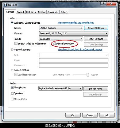

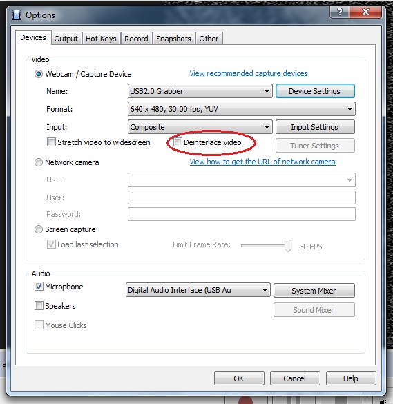

    I can also set up the software will deinterlace the video During the recording
    Maybe it's good
    EDIT:

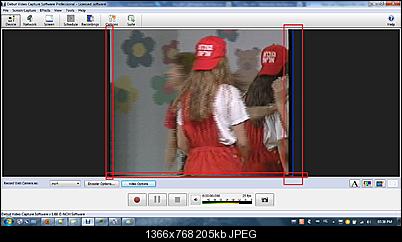

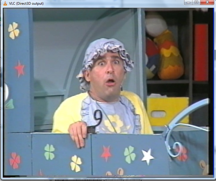

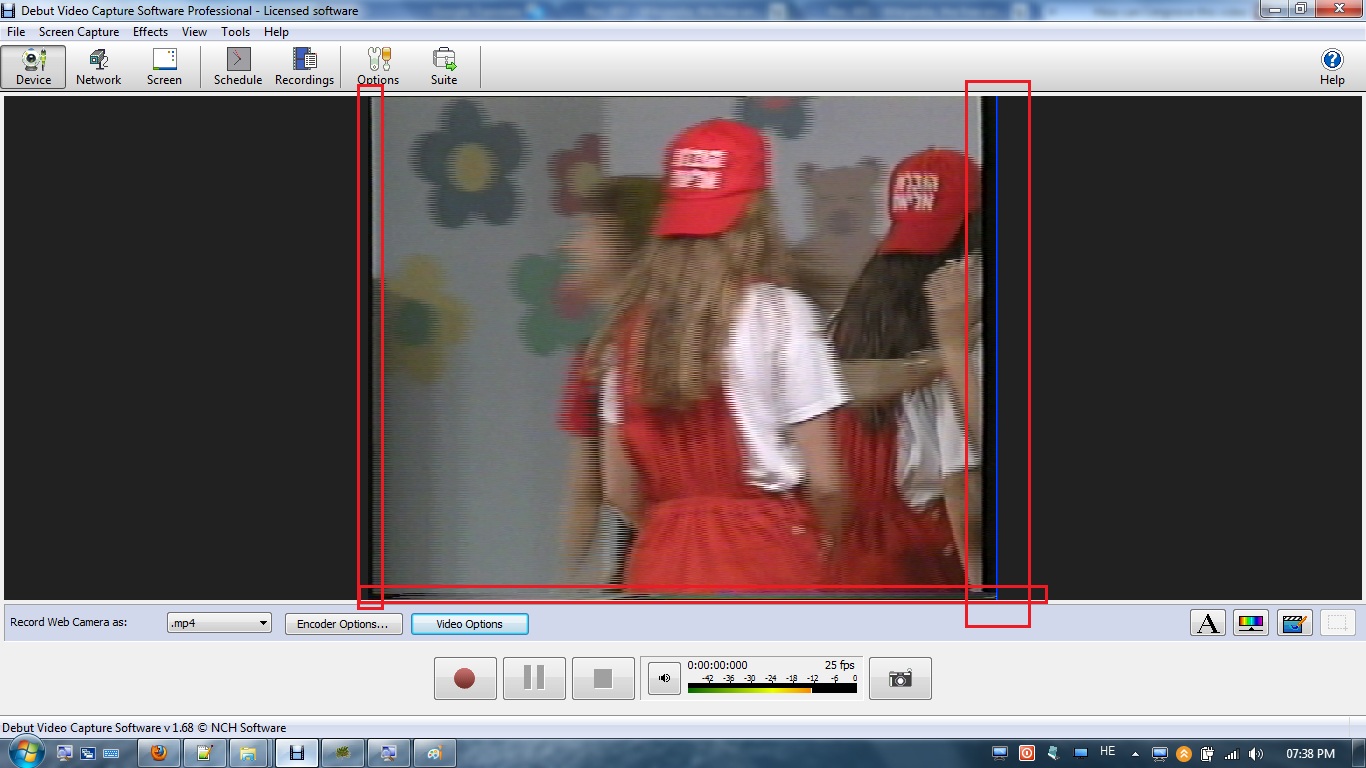

    on 720x576 i have this problem:
    this is still good?
  10. That's not a problem. It's what's on the tape. You can crop or mask it later while filtering.
    Do not deinterlace while capturing. The card will probably do it poorly. And you will lose half the temporal resolution, maybe even half the spacial resolution.
    Your goal while capturing is to get as close as possible to what's on the tape.

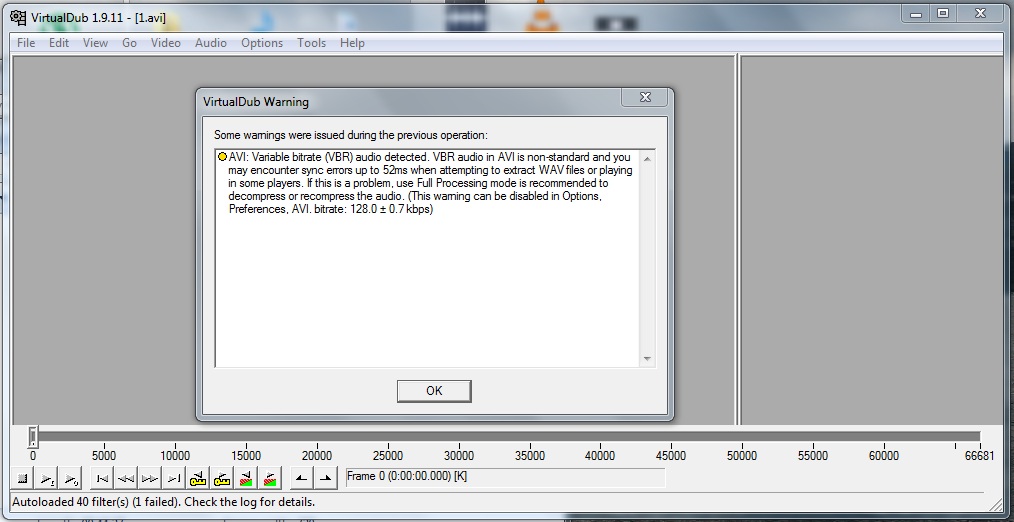

    PB

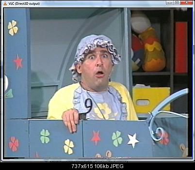

  15. Ok I finished recording to an AVI file.
    But there is a small problem with DGIndex.
    DGIndex not support avi files..

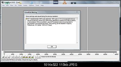

    so i load the avi file(45 min, 2.65GB, 25FPS,720x576) on VirtualDub an then i got a wonning massage about the audio:
    but i dont have that problam with the audio that described in the massge.. so i think that it is ok..
    Anyway, I encoded small part from the video without compression (PCM UNCOMPRESSED)
    to make the bast sample i can..
    I have attached the sample video.

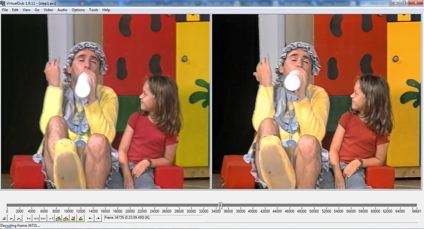

    I think the quality is much better now
    What's next?

    I just wanted to point out that the last screenshots from the OP show the default or native capture settings of the Webcam/Capture Device are at 640x480@30fps YUV and all of the other screenshots are the output settings from the software. Is this possibly the source of interpolation and resizing problems?
    yes.
    but i Identified that problem and change the settigs to this:
    and in the video options i changed the FPS to 25

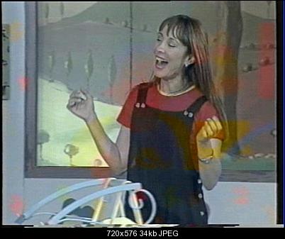

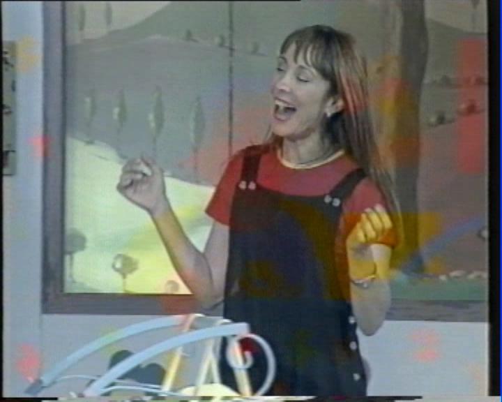

  18. The new sample is getting closer. But there are still problems with the handling of the chroma channels. The colors from the two fields are blended together:
    The blotches of color at the right are from the next shot (the other field in the frame). And notice how the rest of the colors (the red shirt for example) are very muted because they are mixed with the color of the next shot.
    I don't know if this happened during the capture or during your conversion to RGB. You should upload a sample without any conversion. Use VirtualDub in Video -> Direct Stream Copy mode.
    Cropping in AviSynth would be something like Crop(4,2,-20,-10).

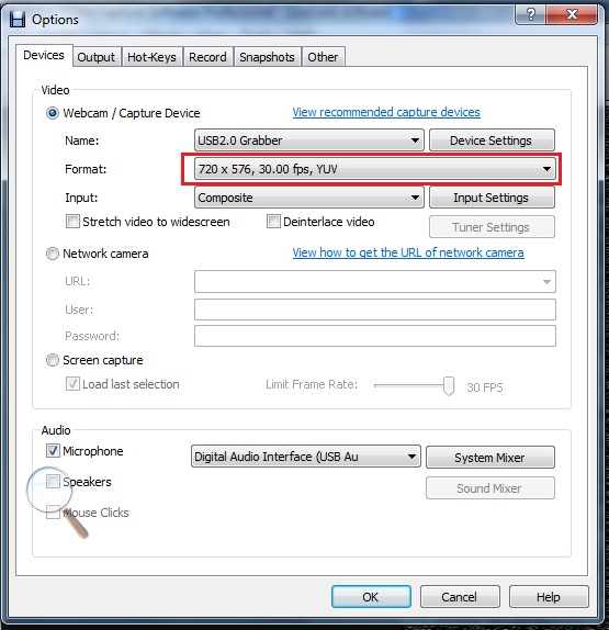

  21. Unfortunately, the problem is in the captured video. Interlaced frames have been encoded as if they are progressive. That has caused the color blending. Can you force the encoder to use interlaced mode?
  22. Originally Posted by jagabo View Post
    i dont know but this is my options:

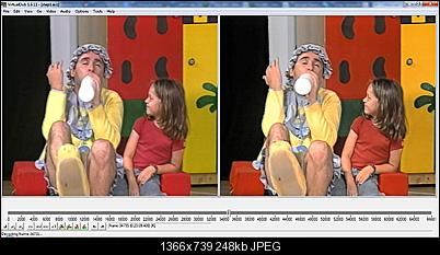

  25. Banned
    New York, US
    1. In VirtualDub, with a video loaded, go to :Video..." -> then "copy output frame to clipboard".
    2. Open a photo app and copy that captured photo into a new photo.
    We can seldom judge much from screen captures. Your script does not correct invalid luma or chroma levels. After you go from YUV to RGB, it's too late for that.
    [Attachment 16075 - Click to enlarge]
    As a test, I suggest you use Huffyuv. Then we can verify whether the program is screwing up or the encoder.
  28. Originally Posted by jagabo View Post
    OK i did it.
    this is the test file:
    there is no motion on the first frames(frame 0 to frame 24) because the i just start to record..
    this is not a problem
    And I have a question.
    This is not really related, but that is the question -
    Is it better to remove the tape from the VCR when not recording?
    Because I thought about it. The VCR just warms the tape without doing anything.
    sanlyn, thanks for the help but I think you're working too hard.
    I did what jagabo said - re-record on correct settings.
    And I did it. And you are trying to improve an old and not good recording
    That was submitted to illustrate two things: (a) why it's a waste of time capturing damaged noisy old analog source to lossy compressors, and (b) something to help you learn about scripting and plugins.
    Re Untitled_40.avi: MP3 variable bitrate audio ? ?
  30. Originally Posted by gil900 View Post
    Yes, finally a clean capture. 720x576 interlaced, 25 fps, no chroma blending, no macroblocking, not DCT ringing, minimal oversharpening halos, pretty clean time base. Now you know the hardware, drivers, and software are all working correctly. This is what you really want as a starting point for filtering.
    If you really can't afford the disk space required by HuffYUV you might try using x264vfw. Set it to interlaced encoding, max GOP size of 1, with a CRF value around 12.
    Yes. And I recommend fast forwarding all the way to the end then rewinding back to the beginning before starting to capture. That will loosen up the windings and the tape may play smoother.
