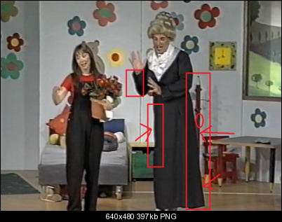

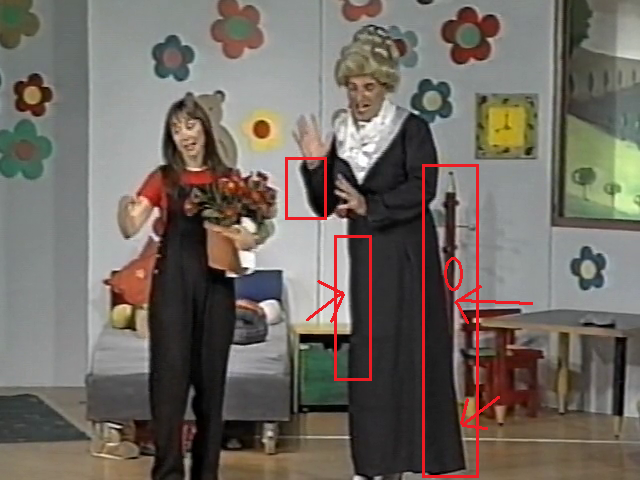

    How do I fix this:
    I have no idea how to fix it ..
    I have tapes with color leakage also that I do not know the fix.

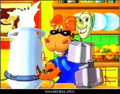

  4. Those are oversharpening halos, probably caused by the VHS deck. You can try using de-halo filters in AviSynth. Or use a deck without sharpening filters. In the end you'll be left with fuzzier video though.
  5. Originally Posted by jagabo View Post
    thanks..
    like this:
    MT("BlindDeHalo3(rx=2.0,ry=2.0,strength=63)",threa ds=2)
    I know this is the tape machine
    i set their the sharpnesses on medium.
    What do you recommend me?
    to set in the tape machine the lowest sharpness?
  6. Turn off the sharpness filter on the deck. VHS halos are only on the x dimension. Use a larger x than y in dehalo filters. Around 4 in that sample. You'll also have to crank up the strength.

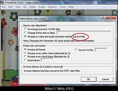

    How did the frame rate of this posted sample get to be 30.068 FPS ? ? The sample also appears to have been resized, but I could be incorrect there.
    I used edited Audio file that filtered from noise
    I did the audio file with the software: WavePad Sound Editor
    I had to change the FPS of the video from 30.00 to FPS of the new audio file.
    Otherwise the audio was not appropriate for video

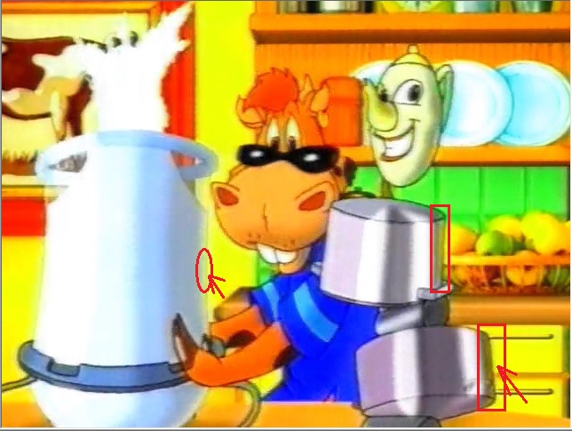

    After i did the "dehalo=4.0",
    This new problem:
    I do not know if it's because "dehalo=4.0"
    (the same tape and show Containing a anime..)
    But how do I fix it?
    IF your intention is DVD or BD/AVCHD, it's still not appropriate.
    This new problem:
    [Attachment 16038 - Click to enlarge]
    You need to recapture and work with the capture first. The cartoon image is blurry, has aliasing and other problems, and is seriously over-saturated.

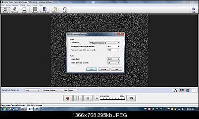

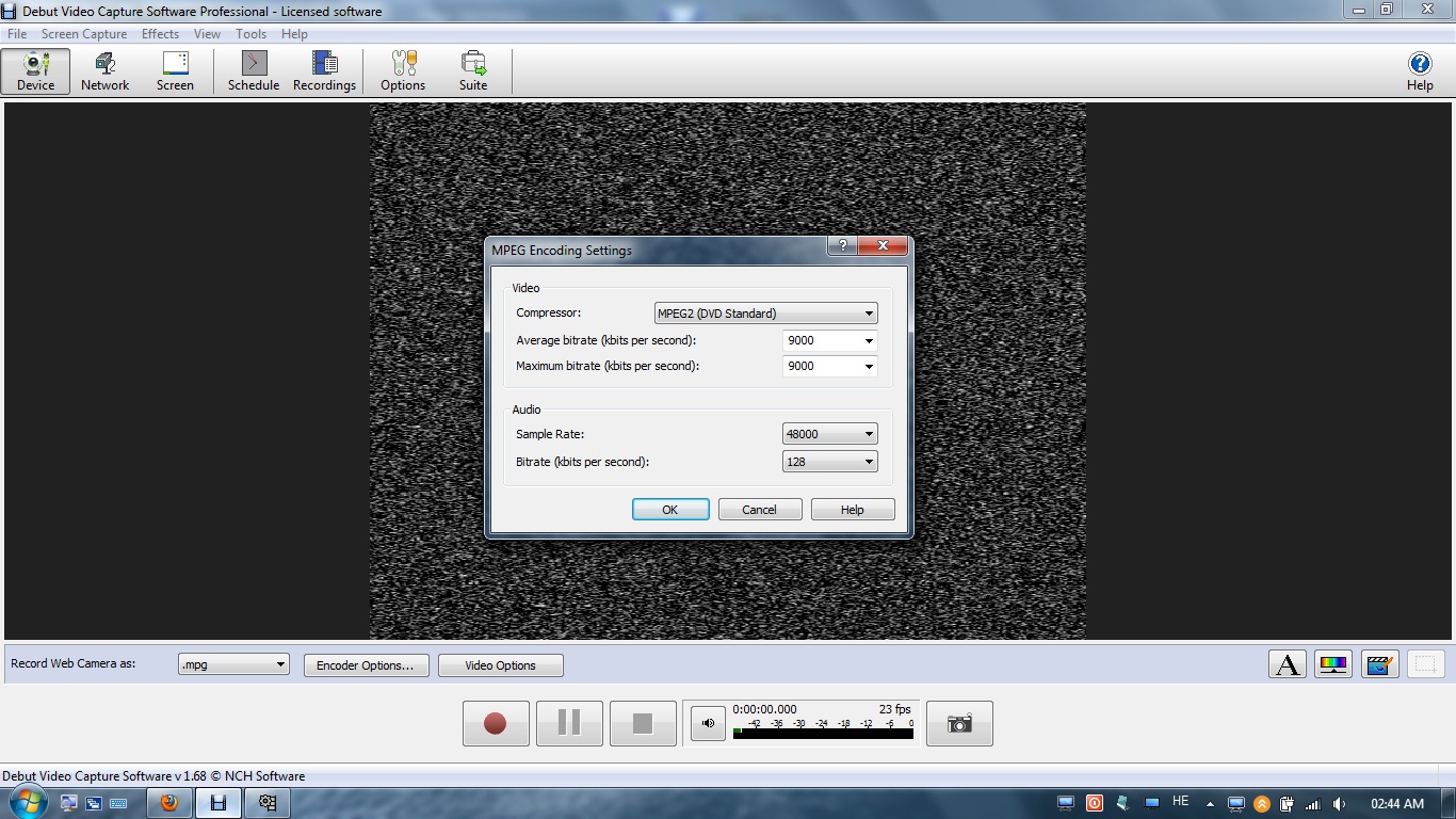

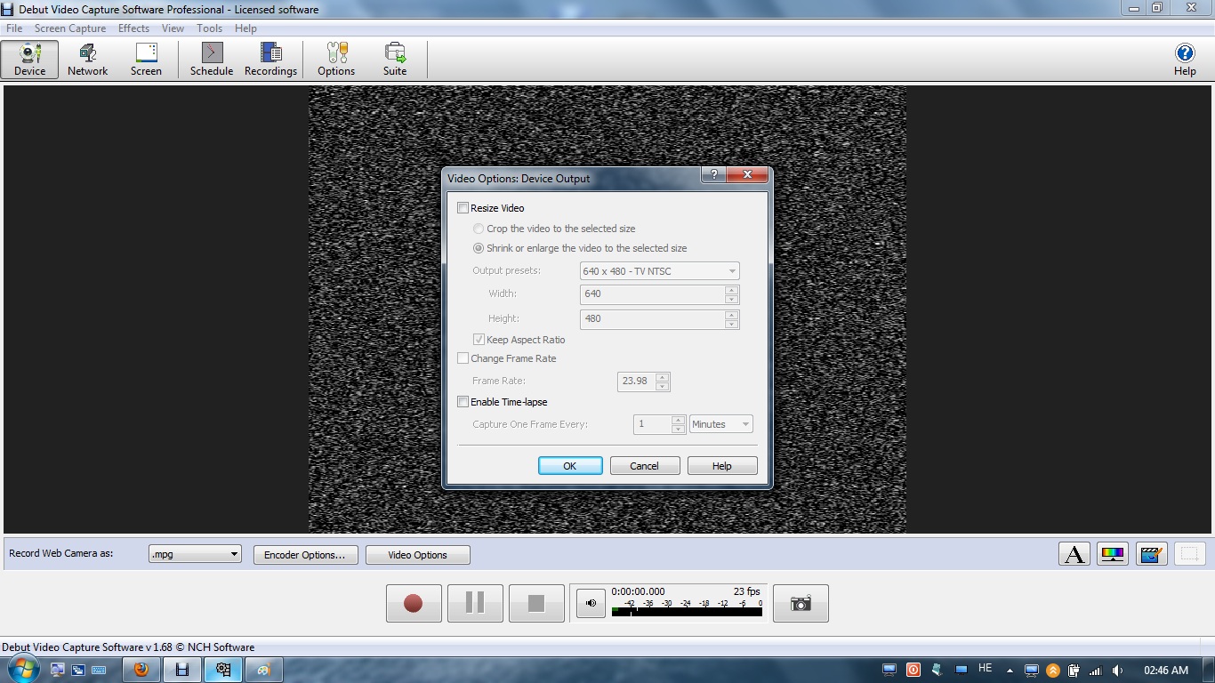

  18. I did not recorded on DVD ..
    I recorded with the easycap.
    And these are my settings:
ID:	16046Click image for larger version
    If your m2v sample is a cut directly from the original, unprocessed capture, how did it become 30 fps? Was it recorded that way? Is it possible to record 25 fps interlaced source into progressive mpeg at 30 fps with your capture software ?
    yes..
    The answer is simple than you think.
    It's not
    I saw the quality remains the same.. I have convert over 30 tapes.
    I have no hard disk have so many recordings of this size(unprocessed) ..
  21. So in my language -
    Possible to fix it?
    It's shorter than it should be?
    What I have set up in the recording software for it will not happen again?
    EDIT:
    If the tape is not 30 FPS (PAL), so it is better the standard FPS of the tape ..

    EDIT:
    the FPS of the video is now 23.976
    and i changed the mode in
    TDecimate(mode=1, cycleR=1, cycle=6)
    to mode 2
    now it is:
    TDecimate(mode=2, cycleR=1, cycle=6)
    I read the document and saw that mode 2 is the best. (Based on good algorithm)
    but as i expected, now i have a problem wich the sound.. to match the video to the sound, i need to change the FPS of the video to 16.614

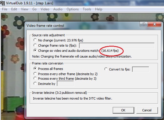

  26. Originally Posted by gil900 View Post
    every 6 frames there is a duplicate frame...
    but i dont know why this is "a serious problem".
    if i play the video so it playng perfectly...
    It's not playing perfectly. There are five jerks in the motion every second. Since this is interlaced video the video plays backwards at each of those jerks.
    my problem that i want to fix is the color bleeding..
    The color bleeding isn't hard to fix. You can use something like:
    MergeChroma(awarpsharp2(depth=30))
    after a smart bob deinterlace.
    But if your source is PAL you should really get a proper 720x576 25 fps capture first. Worry about the audio sync later. Actually there shouldn't be an issue with the audio sync: a 25 fps source captured at 30 fps (with a duplicate every 6th frame) has the same running time as the original 25 fps. But capturing PAL at 640x480 at 30 fps is doing severe damage to the picture.
    Maybe we should verify if you're really capturing PAL video? What country are you in? What is the brand and model number of your VCR?
