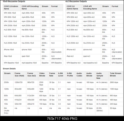

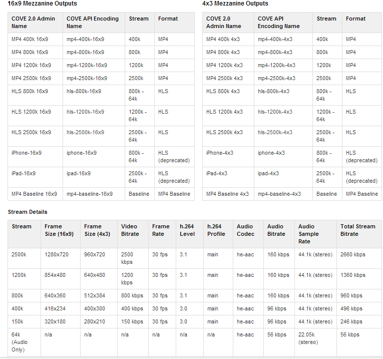

    Typically, if you have a good URL for your video stream you can simply substitute bitrate values, e.g. , 2500k for 800k.
    Otherwise, you might try the Encoding Names in the following chart (click on chart for source page at PBS.org):
