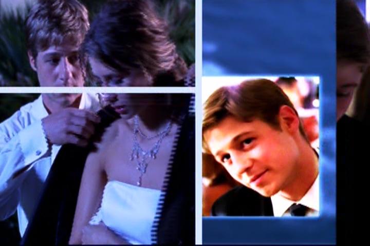

  11. Who cares about the opening titles? They are usually just a bunch of quick shots so you won't really even notice if it's jerky or not. Just use honor pulldown flags in DgIndex, TFM().TDecimate() in AviSynth. If you still get some comb artifacts in the titles follow up with vinverse().
    Oh, got your sample now. I see it has lots of smooth panning shots. But still, who cares if they get jerky? It's just the opening credits. It's the body of the video that counts.
    If you really can't stand to have jerky opening credits use a smart bob and encode at 59.94 fps. Or use VFR encoding (but I just hate VFR).
    Wow, this shit is on the DVD! (simple bob):
    There's no fixing that. If the studio doesn't care about the opening credits why should you!
  12. wow that's terrible QC on the OC intro !
    no way to "automatically" fix, short of manually reconstructing bits (e.g you can roto parts from other frames, using masks, in after effects, photoshop . You can use interpolation methods to reduce the amount of work required, but it's still a lot of work)
    I wonder if the blu-ray version of the intro is like that ?

    It should have been edited as 23.976 progressive from the original film scans. Laziness and poor QC here suggest they produced from some already telecined lower quality version
    On this version - They didn't remove the telecine before editing (normally that can be ok if you keep everything interlaced; the worst that can happen is you get a cadence break and some garbage combing on transitions). The bigger problem here is they resized while it was still interlaced, and not in an interlace aware fashion - that's why you get those thick bands in the jagabo's screenshot
    If they didn't have access to the original film scans, only a broadcast version - the proper thing to do would be to remove the pulldown before editing, so everything progressive, then to add pulldown (telecine) back to make the retail DVD
