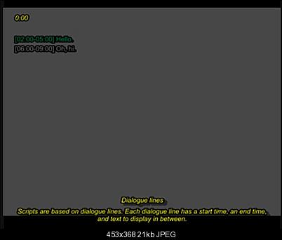

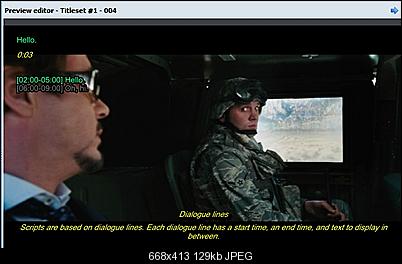

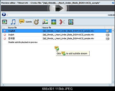

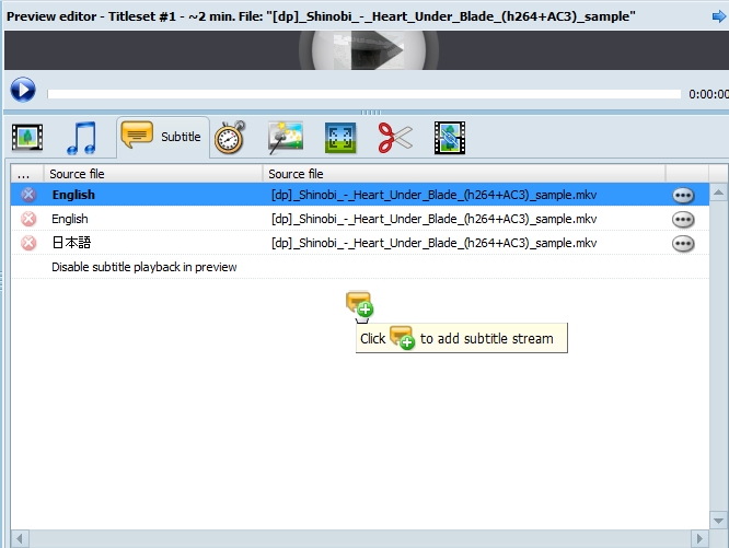

    Easiest way to burn SSA or ASS subtitles to Cx2D is:
    1. Make sure they are NOT included in the video you are converting or they will use the 'one size fits all' method under preferences
    2.. Make sure they are NOT named the same as the video or CX2D may pick them up automatically in the left panels.
    3. Click the little dialogue box on right panel under preview:
Name:	ScreenHunter_465 Jan. 29 23.09.jpg
    4. Click the + sign and add subtitle file. Worked the last time I tried it.
Name:	ScreenHunter_465 Jan. 29 23.21.jpg
    The right hand panel is useful for adding additional files, subtitles, etc.
    I worked with them to get the functionality of SSA and ASS working and the last I checked they had most working correctly. There were only 1 or 2 like karaoke?? and I believe horizontal scroll that were not perfect. Everything else I believe worked.

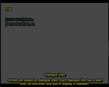

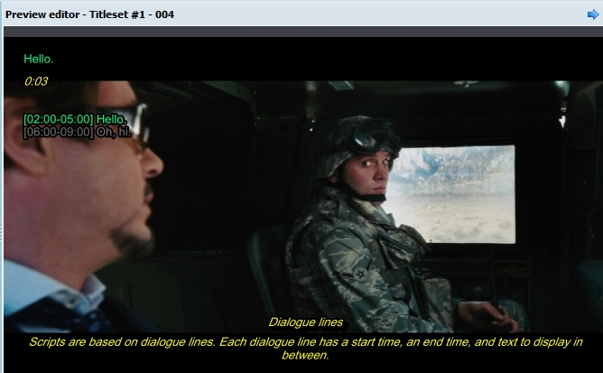

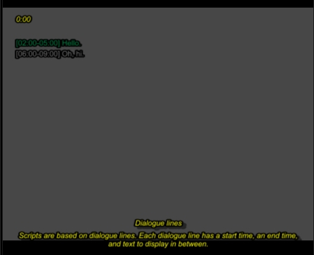

    Not sure what you mean by 'Too Big' but subtitles are set in SSA/ASS subtitles by the their font size setting and more importantly, the 'PlayResY: XXX' setting at the beginning of them. The position is set by their MarginL, MargionR, MarginV settings also. Below are 2 images of my original posted image only in a 4:3 screen and in different PlayResY: xxx settings on a 384 wide video. They do not overlap the screen and the size font was adjusted. I also left a little black at the bottom andadjusted the MarginV setting in SSA subtitle to display in and out of that area for whatever you choose.
Name:	ScreenHunter_466 Feb. 13 16.45.jpg
Name:	ScreenHunter_466 Feb. 13 16.44.jpg
    If this doesn't help,you will need to post more information like a screen shot of the video and the start of your ASS file at least to the first couple lines of the actual subtitles.
