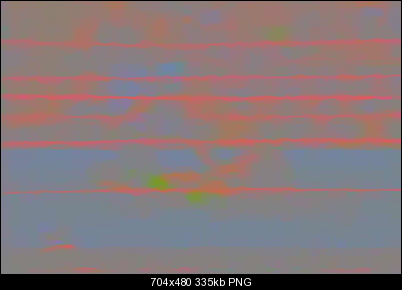

  26. Try adding Sharpen to the chroma Overlay:
    Overlay(GreyScale(last), last.Sharpen(0,1.0), y=-2, mode="chroma")
    That will bring out a little more of the lost color in the thin horizontal red lines.

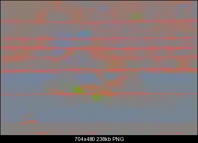

  28. The chroma just after the Overlay without sharpen (saturation increased to make the color more visible):
    With the sharpen(0,1.0):
    You might try a lower warpsharp value along with the sharpen.
