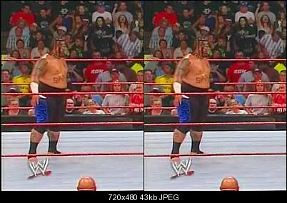

  22. Hi, Sanlyn. I forgot about this thread. I have a sample now. Here's a short MPEG2 which was a TV programme recorded straight-to-DVD.
    I tried this script to fix colour droop but it has no effect:
    Overlay(GreyScale(last), last, y=-4, mode="chroma")
    Any suggestions on how to fix it?

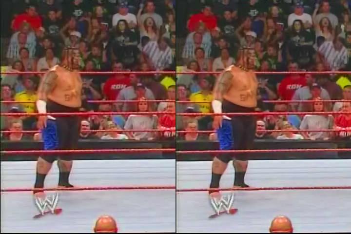

  23. The problems in that sample isn't that the chroma is displaced, it's blurred. It's very obvious if you punch up the saturation, before chroma shift on left, after your chroma shift on right:

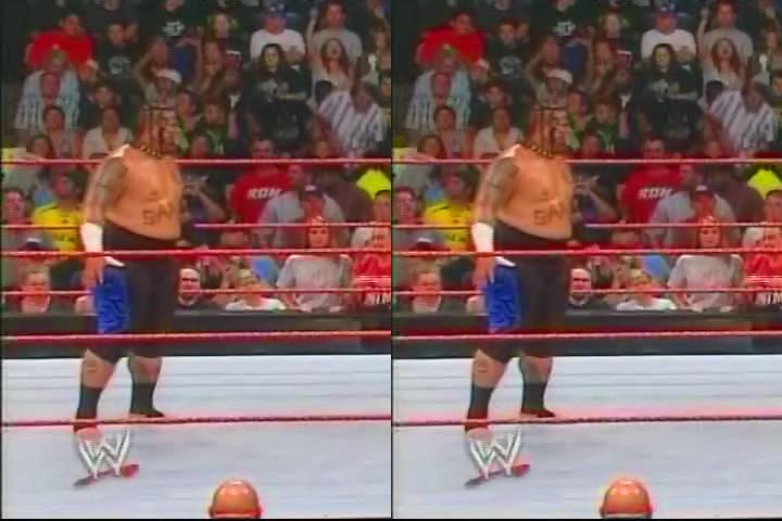

    A more appropriate fix is something like MergeChroma(awarpsharp2(depth=25)). Same pumped up colors, before and after MergeChroma(awarpsharp2(depth=25)):
  24. How would that happen. I thought things like that only happened with VHS? Is there any way to fix it?
  25. Oh, by the way, I treated the frame as progressive instead of interlaced in those samples. You should separate fields before MergeChroma(awarpsharp2(depth=25)) then weave them back together. You may have to tune the depth parameter.
