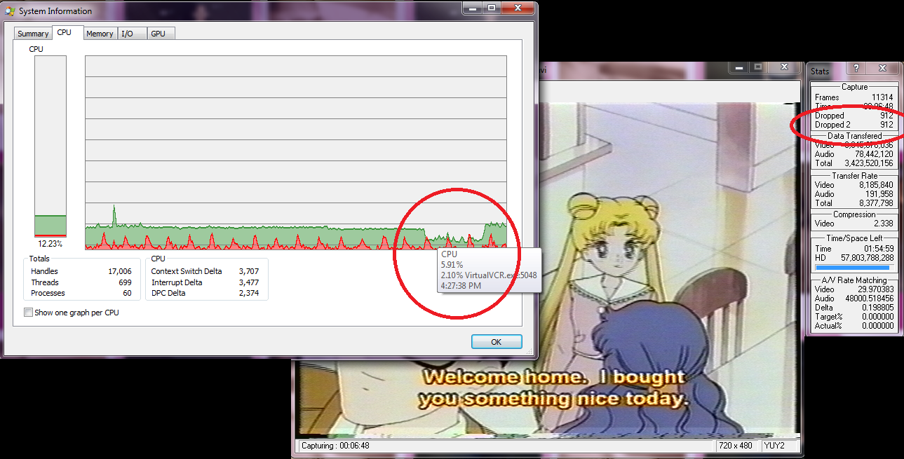

    I just tried using MJPEG, and it worked pretty well for about 40 minutes with now dropped frames. But when I left for 10 minutes, and came back with 2000 dropped frames. So I ended up deleting the file, and tried capturing again with a new tool I found called Process Explorer. While watching the graph, I noticed that the dropped frames actually occur when my software dropped to around 2% CPU usage. There's also something called "interrupts" that was taking up a little of the CPU, I don't know if that's unrelated to my issue though. So I guess the question is: what's causing the CPU drop while capping?
    BTW I am running on Intel Core i3-2310M CPU @ 2.10GHz

  16. Originally Posted by ChibiBoi View Post
    That indicates disk I/O problems. The capture process is doing nothing while waiting for disk I/O to complete.
    Jan 2006
    Ahh, I see. And how do I fix this?
