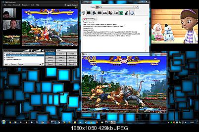

    Dont waste time with this, use DXTORY. Perfect to all stream software. look:
    Claudio
