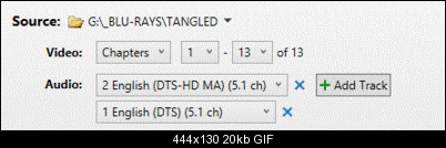

  1. I know DTS-HD MA is a 2-part format that includes a regular DTS core. In a situation where there is a DTS-HD MA track and a DTS track do I need to include the DTS track to make the DTS-HD MA track work or is the core already in the DTS-HD MA track ?
Name:	DTS Audio.GIF
    Like in the above...I want the DTS-HD MA track, but I am also trying to maintain capability with players that don't support lossless.

    As you yourself already said , DTS Master Audio already includes a backward-compatible "inner stream" (the so-called core). Legacy hardware and software should be able to detect the "Coherent Acoustics" core, and ignore the "unknown DTS-HD extensions" (which constitute the "mathematical difference" between the lossy core-audio and the original lossless source).
    Unless you are pretty sure that your "legacy hardware" is not entirely-compliant to the DTS specs (which were designed to be "future-proof" since their beginning), there is no need to include a standalone lossy track in your remuxes.
  3. Member Cornucopia's Avatar
    And to further clarify: a player plays only one audio stream at a time, so if it were attempting to play a dts-hd ma track, it would stand to reason that all the data necessary to play it existed in that track alone.
  4. Thanks for the clarification. I wasn't sure if the Handbrake was breaking down the DTS-HD MA stream to show the core as a separate track or if there was actually a separate track.

  6. That's all very well however it does seem that Handbrake shows up the Core as a separate audio channel allowing you to extract it separately. I find that quite confusing and a "Core only" option like Ripbot would be much better.
    I have a bluray disc that shows it as having 7 audio tracks yet Handbrake says it has 8. The extra one is DTS5.1 in English which the movies doesn't have. It only has DTS-HD-MA in English. I assume that extra track is the Core of the MA track.
