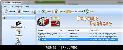

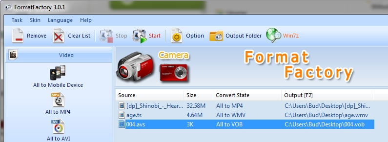

    Format factory will create mpeg2 and does batch as well. I don't use it much myself but I know that if you wish to hardsub and keep the ASS formats, you will have to use AVISynth to send it to Format Factory(It supports AVS files). The canned subtitle method do not look as well and have that 'One size fits All' method of making them all the same whichdefeats the purpose of ASS / SSA subtitles. The settings are very adjustable to maintain quality also.
Name:	ScreenHunter_464 Jan. 26 21.39.jpg
    Notice it also does VOB. Again I have not used it much except to assist others to hardsub but it worked well for that.
