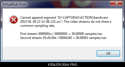

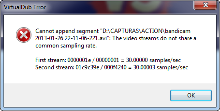

    I wouldn't worry about "frameloss", the difference between 0.000024 is pretty small unless you have very long video you wouldn't notice a problem or even sync issue
    The problem is that VDub doesn't like the frame difference. It just gives me an error.
    What would you call very long? Recording sessions can go for over two hours. We chop the footage up in episodes of around 30 - 40 minutes.
    It's not ideal, but you can "fix" the fps by running them through vdub, video=>direct stream copy, audio=>direct stream copy, video=>change frame rate to 30 , file=>save as avi
    I know this, but it isn't ideal indeed. I was happy that with Bandicam, I could save the files at a format that would require no work to upload at all. With our new bumpers, that's the only work we have to do before uploading.
    I've already contacted Bandicam support, but they're slow to respond and their English isn't very good. The first answer they gave me wasn't of much help, haha.
    I'm just trying to get my head around possible reasons why this occurs.

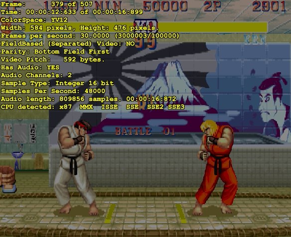

  21. Originally Posted by Cauptain View Post
    That is a no bandicam problem.
    Make some tests using 1.8.5 (YV12, RGB24, MPEG and X264) and all records are perfect 30.000, look:
    mediainfo only shows 3 decimal places
    the sample clip he uploaded from bandicam recording was 30.000 in mediainfo as well, but it doesn't show the precision required, not enough decimal places (it was 30.000024)
    open it up with avisynth and use info()

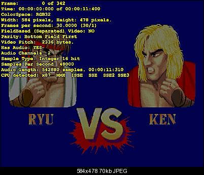

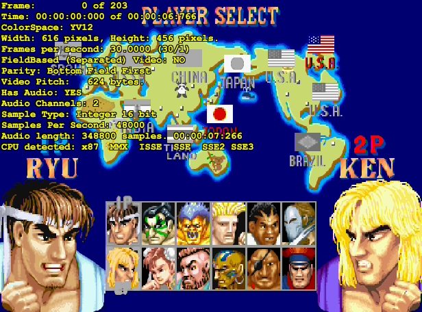

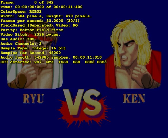

  22. Lone soldier Cauptain's Avatar
    Jan 2006
    Brazil
    bandicam:

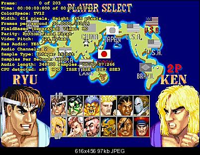

    action:

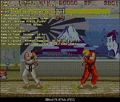

    dxtory:

  24. So Claudio, on your system it looks like bandicam is running "off" FPS too ?
    For example, you wouldn't be able to append those 3 clips because of the 30.00003

    Correct. Not append too.
    Claudio

  26. But the other clips join ok , correct? For example dxtory +action. Because their FPS are identical fractions
    That's evidence that suggests the problem is bandicam....

    Yes. Work great for ACTION+DXTORY+FRAPS.
