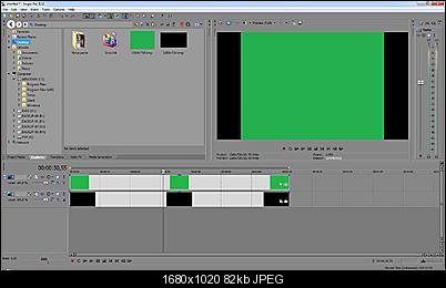

    I use Sony Vegas overlay option to this.
    1 - Make a project 120x720
    2 - Make a black image 1280x720 and open it.
    3 - Insert your opening and videos.
    4 - Encode using 720p with LOSSLESS codec and enjoy.

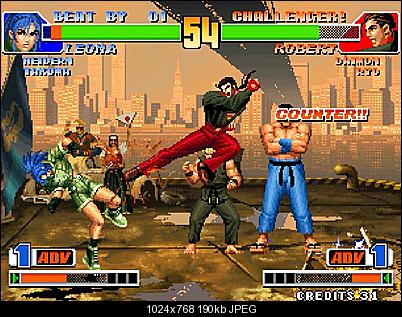

    Source video file (1024x768):

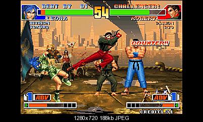

    Avisynth video file (1280x720):
    Easy? Some clues:
    - Both videos must have the same framerate. If not, you can use the function "AssumeFPS".
    Example: DirectShowSource("opening.avi").AssumeFPS(60,1) = opening@60fps, if file are 30fps use .AssumeFPS(30,1)...
    - Both videos must have audio. No need have music but audio track. If one does not have audio, give error.
    Try it. Any doubts, reply.
    [Attachment 15936 - Click to enlarge]
    [Attachment 15937 - Click to enlarge]
    Easy? Some clues:
