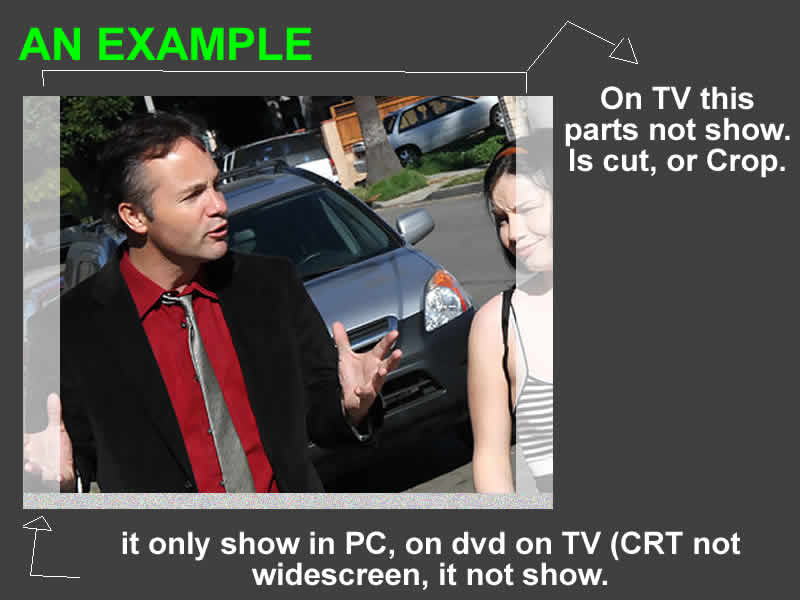

  1. I capture an vhs, the avi source had 720 x 480, I want convert it to dvd 720 x 480, so the source and output is 720 x 480, on captured video had an white track below, I not know why, when I view the video in tv (CRT, not widescreen), not had this track, and had on video an cut (crop) in both sides. I want add letterbox in up and in down, and I not want than cut the sides, I use Avisynth, what line I need add to script to do it.

  2. Why don't you post screenshots of what you're seeing and what you're hoping for. It's difficult to understand your question, particularly what you mean by "white track" and "cut."
  3. See Screen of Example
    More one time, I want than show the parts of both side, I want see it on TV. And white track I not want see on TV. I want keep aspect ratio, I think than is need add black letterbox below and above of image. What is the line to add on script.

  4. You don't see the edges on CRT , because of overscan .
    http://en.wikipedia.org/wiki/Overscan
    One practice is to overlay those edges with black strips to cover them up (or crop and addborders, but you have to be careful about cropping interlaced material vertically)
    http://avisynth.org/mediawiki/Crop
    http://avisynth.org/mediawiki/AddBorders
  5. To show both sides without cuts, and remove the white track, and Keep Aspect, what is the code line to add on avisynth script? Somebody Know?
