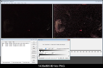

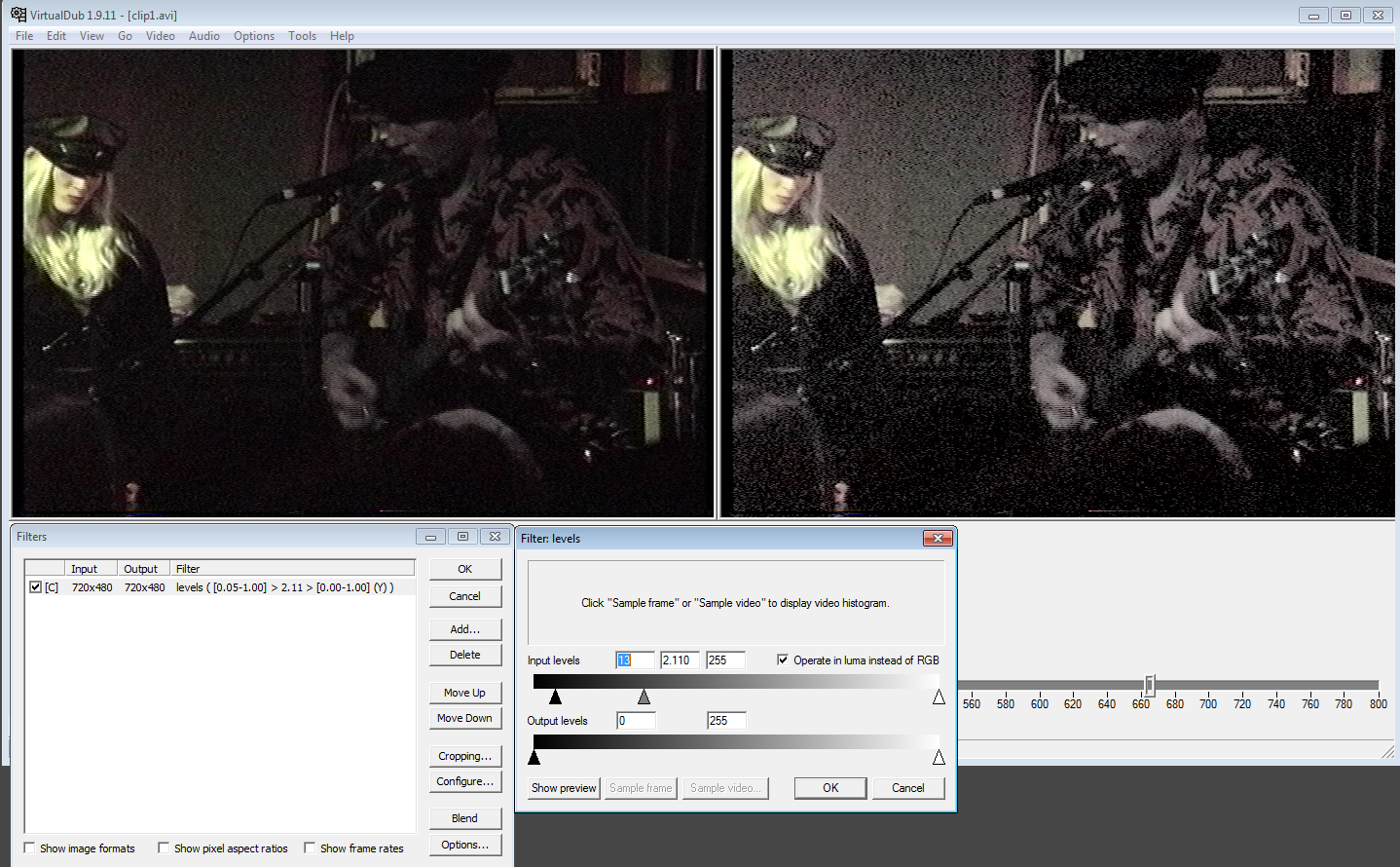

  6. I would stay away from HDRAGC on footage like this, especially if you don't know avisynth.
    Try playing with the level filter in vdub, you will bring up the noise but it will be "watchable." This video will never look great no matter how much denoising you try to pile on later. Using the level filter be careful to keep the blacks black and don't blow out the highlights. Quick sample:
    May 2008
    [Attachment 15906 - Click to enlarge]
    smrpix, thanks so much for the information! See, I'm such a beginner at this stage that I didn't know about the "levels" filter and that I could do that with it. I guess I could do the same with the rest of the video (the majority of it is really dark) like you see in clip 2 and clip 3. I guess I can play with the level filter to make it so that I can at least see the performers, thus making this watchable. If you don't mind providing another little example of one of the darker clips (clip 2 or 3), that would be great, but not needed - as I can always fiddle with the levels myself. I was just psyched to see this little example you gave on what can be achieved by this filter.... Yes, this is exactly what I want to do (just make things more visible and not hidden by darkness), especially during the parts where the lights go out. Would you recommend any de-noise filter to be applied after adjusting the levels to my liking?

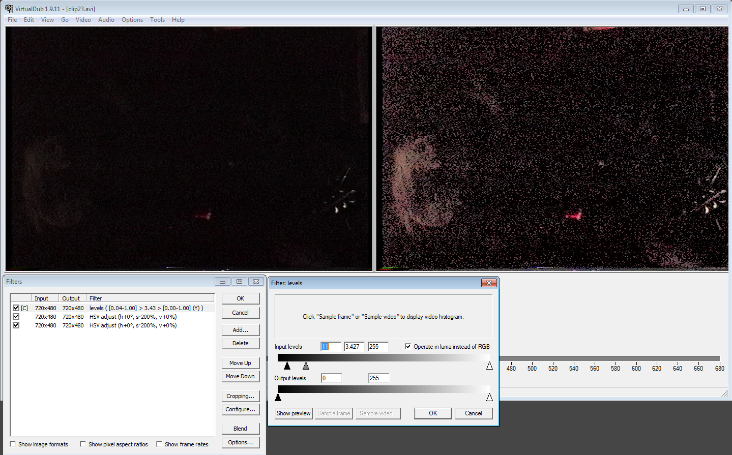

  8. You can try the MSU denoiser, I had no luck with it since at this point the noise IS your image.
    http://www.compression.ru/video/
    Also added HSV adjustment, twice, to oversaturate the color. There's really not much image information there.

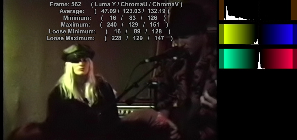

    (Below) Among the tools you'll find useful (that means "essential") in video work are vbarious histograms, vectorscopes, and other graphics goodies. Adobe Premiere Pro and Vegas Pro charge big $$$$ for theirs. Avisynth's and VirtualDub's are free. The image on the left is a YUV histogram, to look at the way video data is stored in your source. The image on the right is an RGB histogram, for seeing how the video will display in various monitors and TV's. The YUV levels histoghram shows luma (brightness) at the top, the red-green channel in the middle, and blue-green at the bottom. In RGB , you see all three channels Red-Green-Blue, with a composite of the brightness or luma at the top. The RGB left side is dark values, the right side is bright values.
    These histograms show that Clip3 has severely crushed darks. The tall peaks indicate this. In the RGB histogram of frame 180, all of the color and luma sits smacked against the left-hand side -- which means that essentially the only colors you have to work with are blacks. The YUV histogramj shows color content as a thin white line in the middle of the graph: if you were looking at a dead-black frame, that's what black would look like in YUV. Both histograms show that the luma and chroma range is packed within the narrow range of RGB 0 (and below 0) to RGB 45 or so. RGB 45 wowuld represent the darkest shadows in skin tones. Skin tones usually range from dark RGB 40 shadows to RGB 180 highlights. There is no color value brighter than than RGB 40. There are a few spectular highlights at around RGB 240 or so, but above RGB 40 there is little or nothing to nothing to work with.

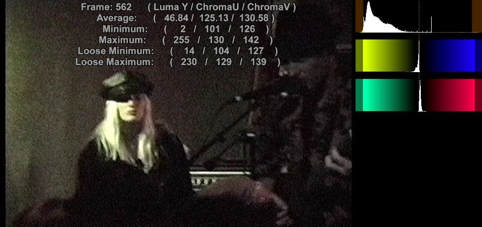

    (Below) You can brighten this dank stuff -- and the noise with it. In frame 180 below, the video hasn't just been "brightened", ikt's been low-contrast enhanced to bring up darks more than it brings up the brightest areas. A typical "brightness" control just moves stuff around on a histogram, but contrast masks and YUV level controls can work specifically on the darks and expand them to a more useable range -- much more powerful than a brightness button. Frame 180 has been brightened to far beyond the original range. The original RGB-0 black borders are the darkest part of the image below, and they'[re at RGB 44 -- which is ghray, not black. You acn see that making the darks brighter does not reveal more detail. All you c an do with crushed blacks is make them brighter (gray). You'll also note that expanding the darkest colors resulted in a nearly monochrome image. You can't make crushed colors into variegated colors. They will always be one color, no detail.
    [Attachment 15910 - Click to enlarge]
    (Below) Histograms showing how much the darks have been expanded -- far ebyond the area where blacks should reside for TV, which is around RGB16 at the left-hand line on the RGB histogram. Note that all three RGB colors have about nthe same shape and the same position -=- that's what dark grays look like on an RGB histogram.
    [Attachment 15911 - Click to enlarge]

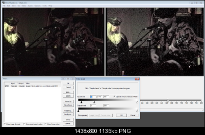

  11. I did my little tweaks you don't have to change much things imo
    ylevels(0,1.000,249,0,255)
    tweak(sat=1.7,cont=1.0,coring=false)
    with avisynth then you'll have to denoise with neat
