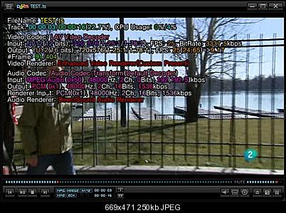

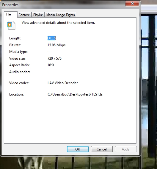

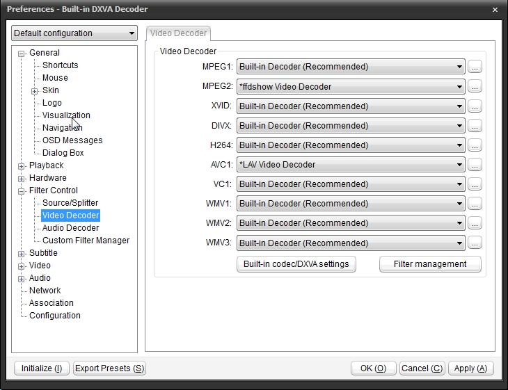

    Ok, this is going to be complicated but I'll try to make it as clear as I can. I have Potplayer, Klite(with FFDshow and LAV). You are right in the fact that if you have it set up right and you select the LAV splitter AND the LAV video codec it will not change IF the Windows default codec is set to some other choice.
    On mine, I had to disable MPEG2 in FFDshow Video codecs then go to Windows codec Tweak tool and set MPEG2 as one of the formats decoded by LAV. I've included some of the images I used to do it but it will in fact change to LAV codec. The easiest way to check is play your file in Windows Media Player and it should say LAV if you right click and select properties while it is playing.
Name:	ScreenHunter_465 Jan. 26 22.45.jpg
ID:	15973 Click image for larger version
Name:	ScreenHunter_465 Jan. 26 22.29.jpg
    Both the above should say LAV. If they do then then it should show LAV when you hit TAB (default propertes key) while potplayer is playing.

    Basically, if Windows media player says LAV then Windows default is LAV and Potplayer will accept LAV and play with LAV.
    I verified this on mine and you'll notice I had MPEG2 set with FFdshow because I like thumbnails and originally I couldn't get thumbs with Potplayer FFMpeg decoder so I altered mine.

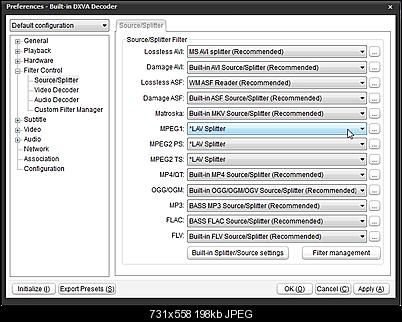

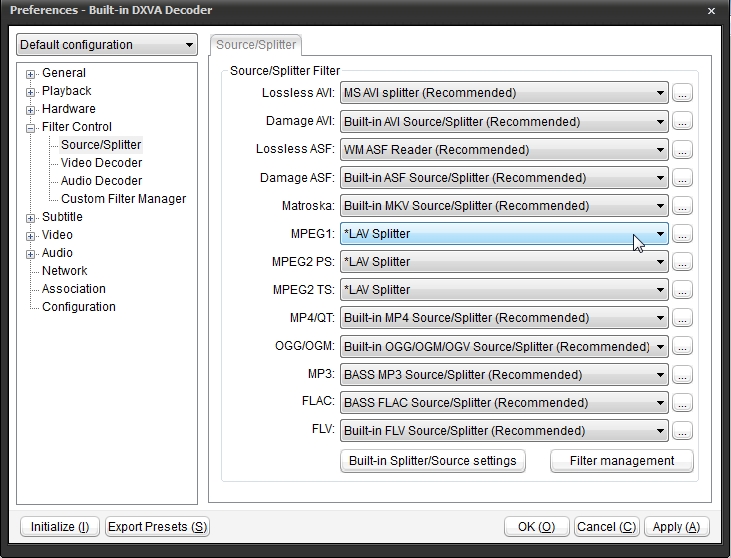

    This method worked on my computer to get a stream to play with the Lav Codec. First set Mpeg1 to Lav splitter (either Lav or LavSource, both worked) IO also have Mpeg-TS and Mpeg-PS set to Lav :

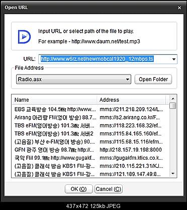

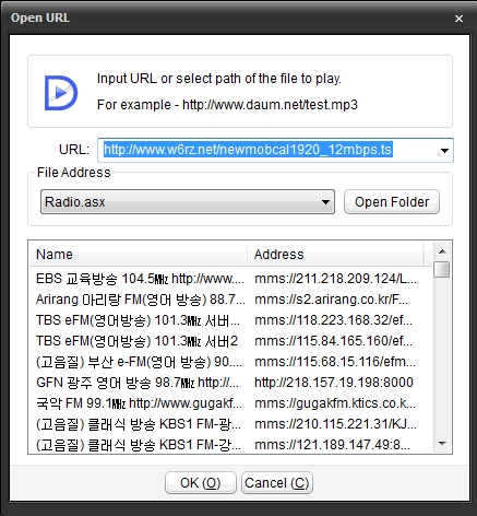

    Right Clicking on Potplayer, I chose Open -> Open URL and posted the stream link into it.:
Name:	ScreenHunter_465 Feb. 01 17.00.jpg

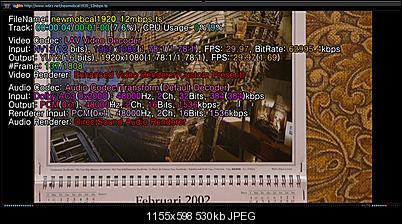

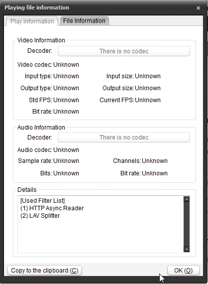

    When I hit enter, I see "Playing..." in Potplayer and I hit tab to display properties of the video. A new window opened and first showed HTTP Async. I closed and reopened until it showed Lav Splitter being used.
Name:	ScreenHunter_465 Feb. 01 16.48.jpg

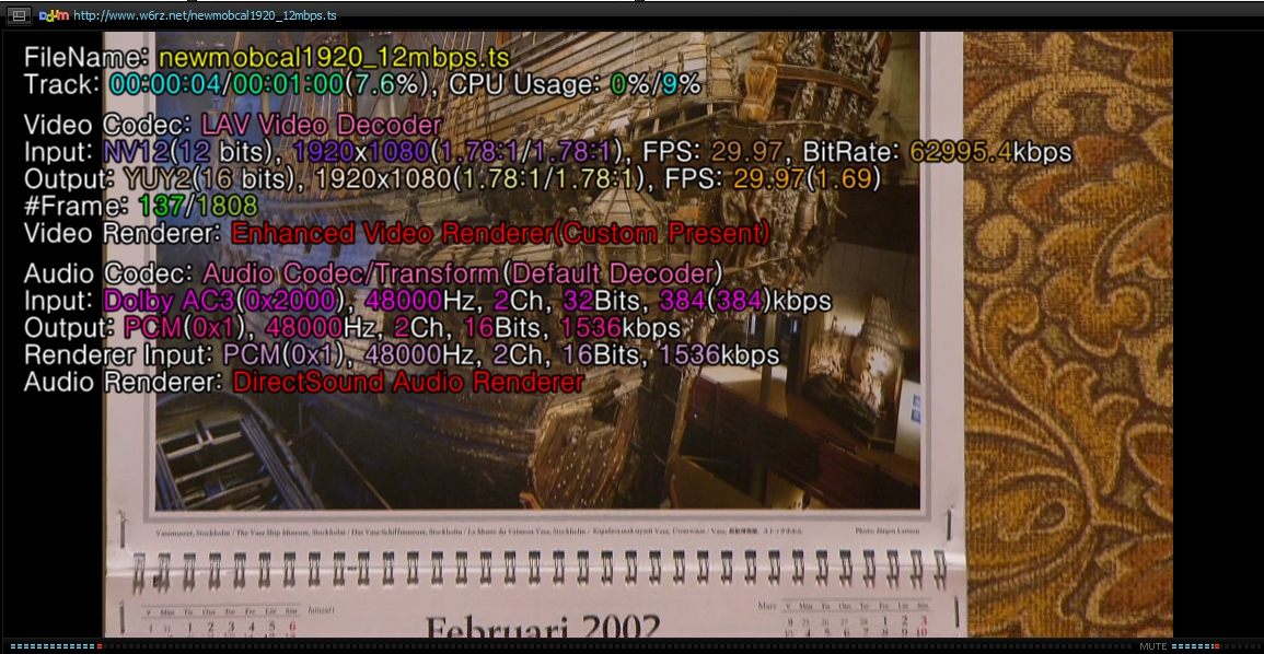

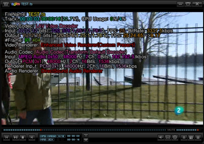

    When enough file had been downloaded, the video began to stream. I hit tab again to show that Lav is being used there also.
Name:	ScreenHunter_465 Feb. 01 16.47.jpg
