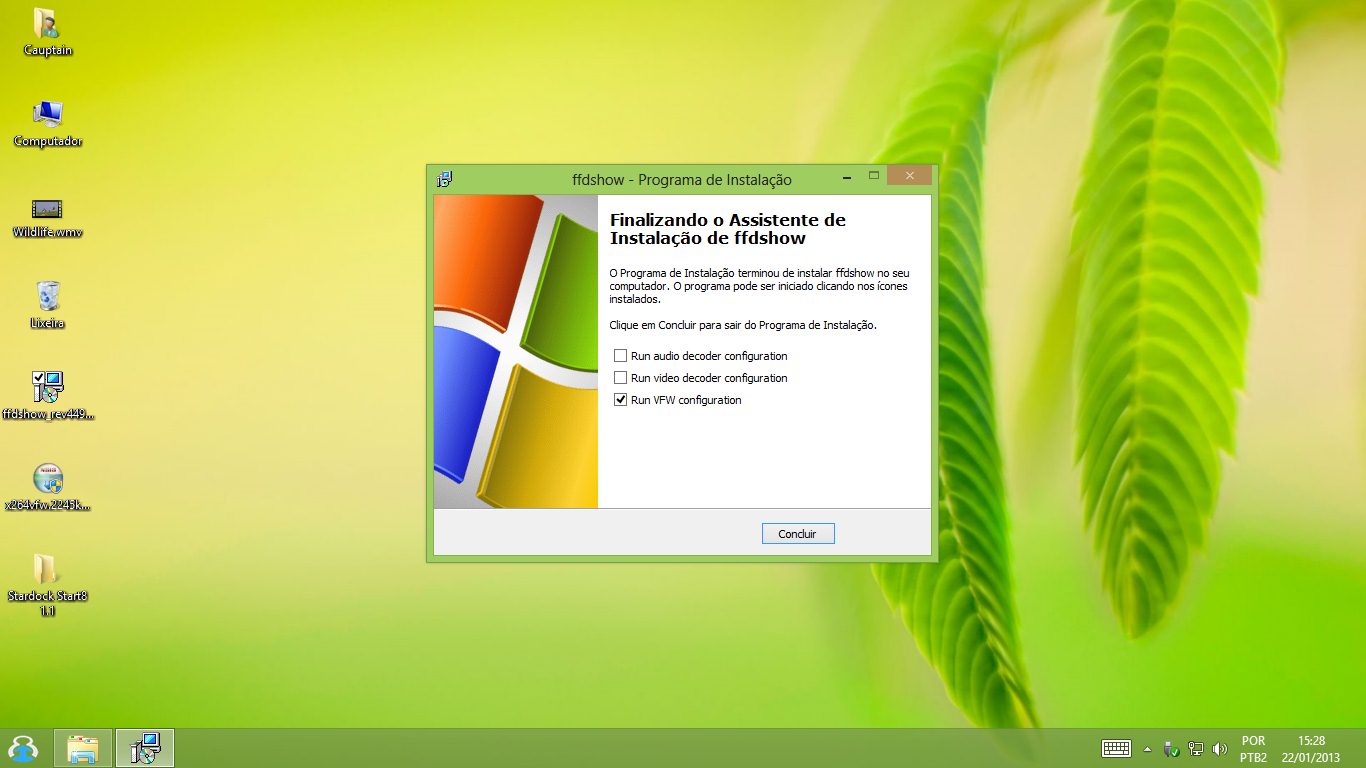

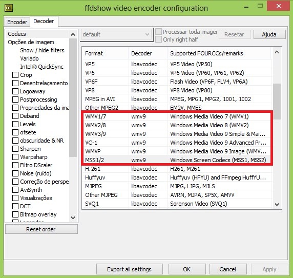

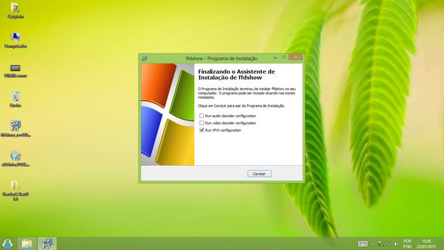

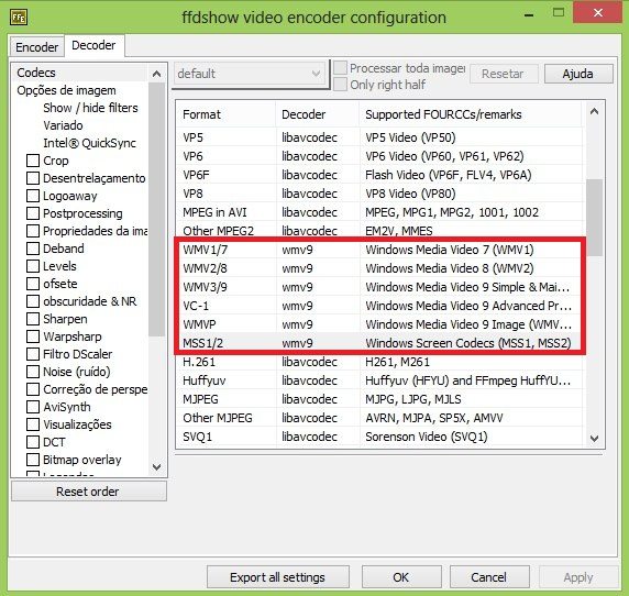

    Virtualdub + FFDSHOW + X264.
    - Install FFDSHOW, go to VFW config and set WMV files to use LIBAVCODEC.
    - Open your files on VD and edit.
    - Save using x264+MP3 codec compress.
    I installed FFGSHOW and X264 but am not sure where to the config what you are referring too. Can you link the X624 install that I need I just want to make sure I got the right one. I can't re access the FFDSHOW config after I installed it.

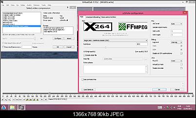

    Yep, it will also work. BUt you will get avi files with h264 because virtualdub can only save in avi. You could later remux/convert them to mp4 with for example mymp4boxgui( no quality loss).
  6. I'm a MEGA Super Moderator Baldrick's Avatar
    Install the x264vfw and you can convert to h264 directly in virtualdub. BUT only in an avi as I mentioned above.

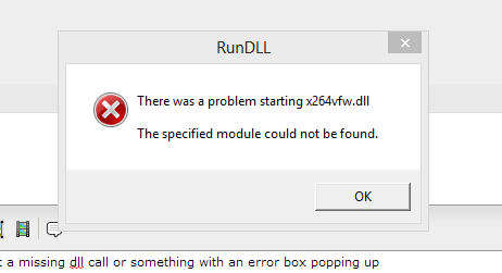

  9. Well yeah when I installed it I get a missing dll call or something with an error box popping up.
    So it will not work for me

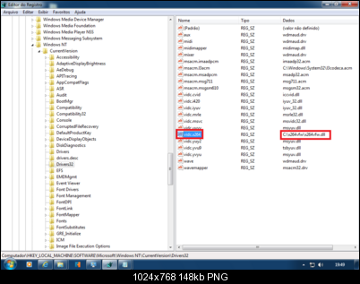

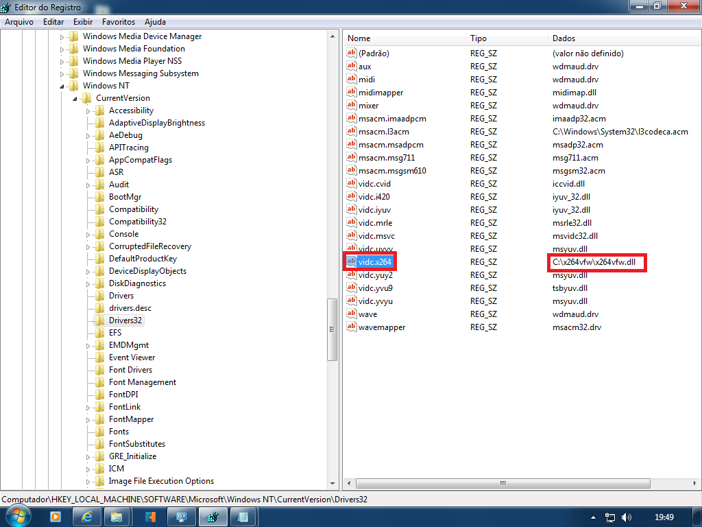

    1 - Download x264 here:
    x264vfw.2245kMod.x86.zip
    2 - Extract to any folder (ex: C:\x264vfw\), remember this, very important to make work.
    3 - Open regedit, search for : [HKEY_LOCAL_MACHINE\SOFTWARE\Microsoft\Windows NT\CurrentVersion\Drivers32]
    4- Add new
    value of string and named: vidc.x264 and use the "extract dll folder" has data ( like the screenshot below):
    5 - Close regedit and enjoy.
    Claudio

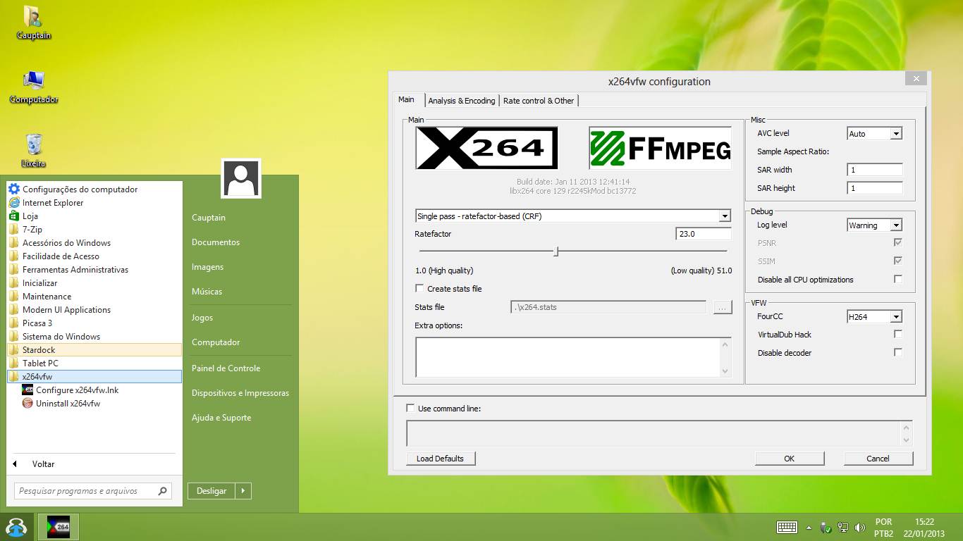

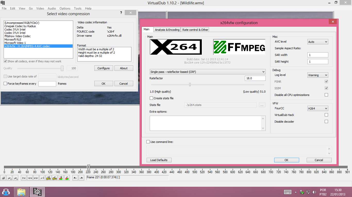

  20. Lone soldier Cauptain's Avatar
    Jan 2006
    Brazil
    Originally Posted by sparker3669 View Post
    Ok now how do I get the config up for that after I do that?
    Claudio
  21. Well still then this doesn't work C:\Windows\SysWOW64\rundll32.exe c:\x264vfw\x264vfw.dll,Configure.I still have the shortcut in my start menu.
    I don't have that entry in Vdub
  22. See not there and FFDSHOW is not showing up there either

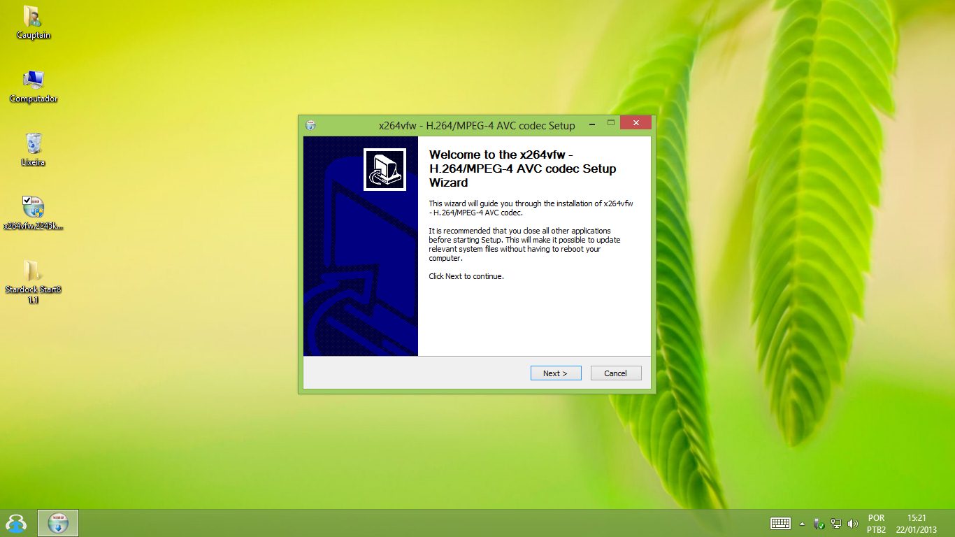

    Hi sparker,
    Please, install the other x264vfw codec: http://sourceforge.net/projects/x264vfw/files/latest/download
    Try and reply.
    Claudio
  28. Still doesn't show up in Vdub but that installed and the start menu config works. Not sure how to get Vdbub to work with this. Completely frustrating
  29. How did you install vdbu? Did you just extract it to a folder on one of your drives. How do you refresh its setting and stuff?
