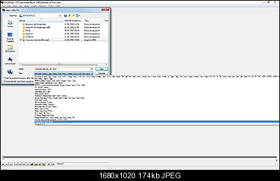

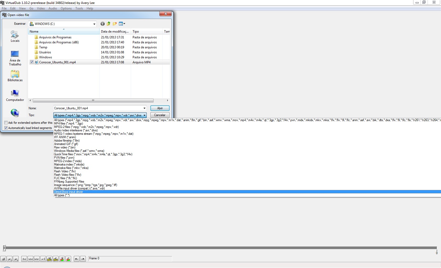

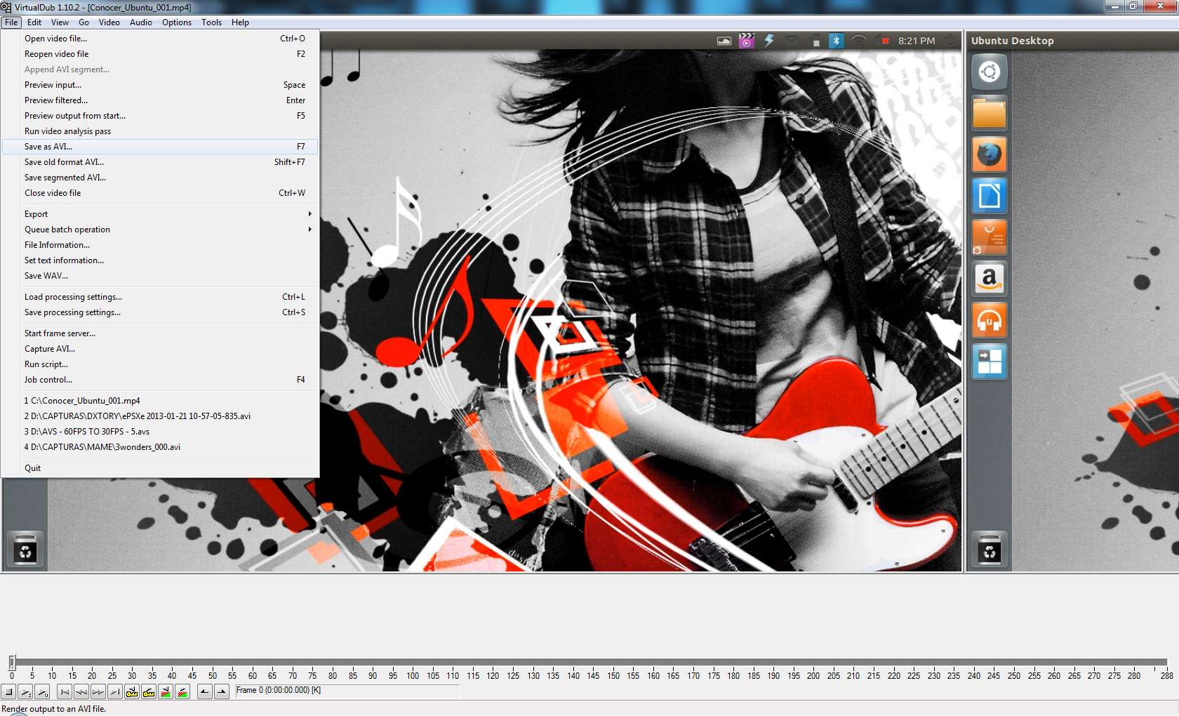

  15. Lone soldier Cauptain's Avatar
    Jan 2006
    Brazil

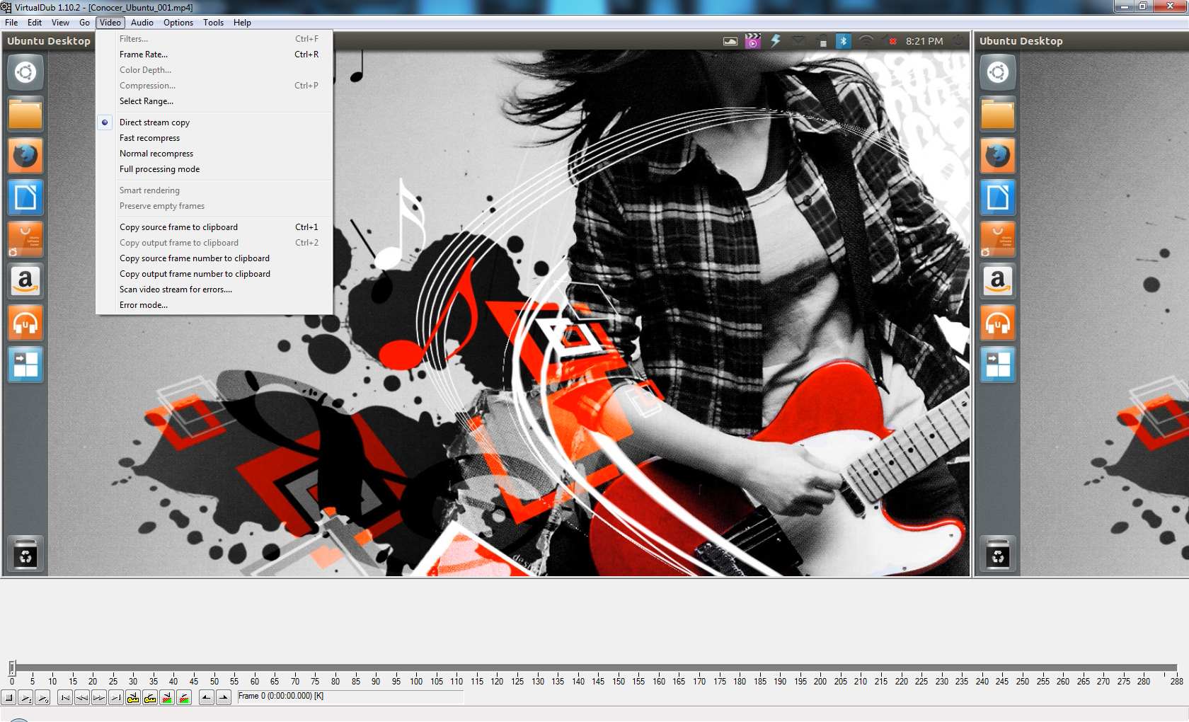

    Easy way to correct this.
    Open your file in Virtualdub using directshow filter, select direct stream copy for audio and video and save avi file.
    The new file work perfect in Vegas in any resolution.
    Claudio

  18. Lone soldier Cauptain's Avatar
    Jan 2006
    Brazil
    Originally Posted by Nikephoros768 View Post
    How can I do that?
    1 - Download Virtualdub
    2 - Download a Directshow filter here:
    http://www.virtualdub.org/beta/DShowInputDriver-0.93.zip
    3 - Extract to Virtualdub\Plugins32 - (If no exist this folder, make it.)
    4 - Look screenshots below and get your work file:
    Claudio

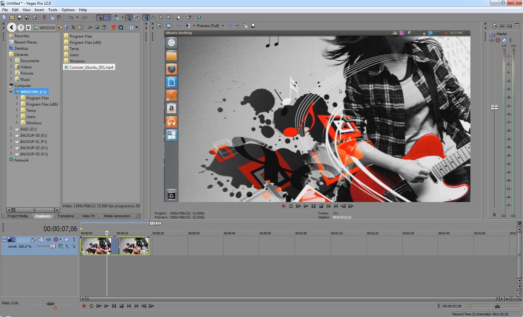

  20. Lone soldier Cauptain's Avatar
    Jan 2006
    Brazil
    I'm very confused as to why you are getting those results...
    Does the preview within vegas look ok ? (ie. before exporting out)
    No Poison. In preview its wrong too.
    Claudio

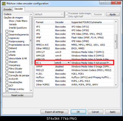

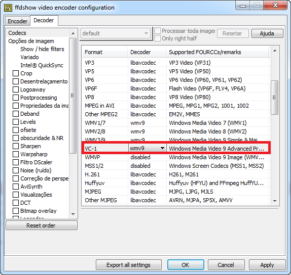

  28. Lone soldier Cauptain's Avatar
    Jan 2006
    Brazil
    Yes, it does look good. Now I'm having problems with the directshow filter LOL!, Virtualdub won't open the mp4!
    Easy. Install FFDSHOW, go to VFW config and select like this:
