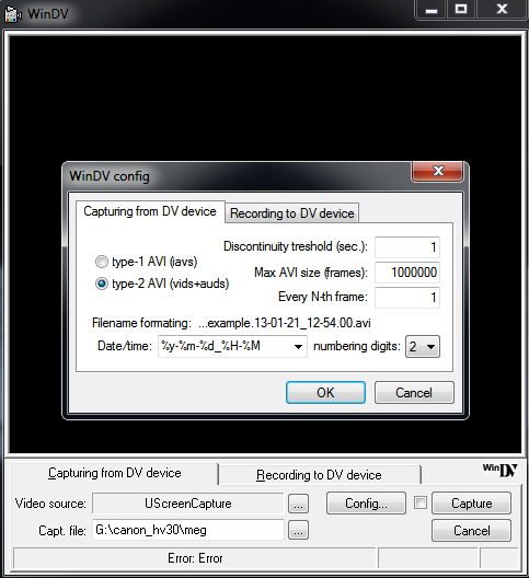

    rather than using vegas to capture, use winDV. click the options button and set it up like this to capture the video as 1 file.

    look closely at all the settings in the picture i posted. the max avi size needs to be what i posted.

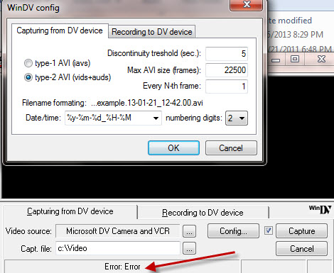

    I ran into trouble with WinDV per attachment. "error, error" Same as yours above.

    max avi size needs to be 1000000.
