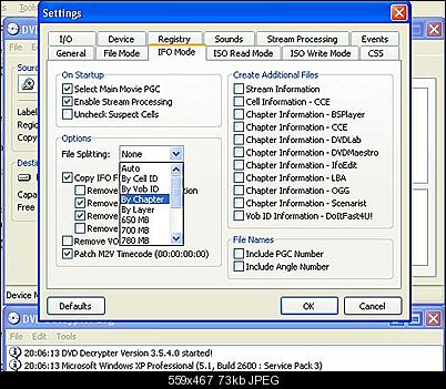

  1. Help Please , i am wondering how i can rip a dvd that for example has 18 chapters on the disc , is it possible to rip the video from the disc and for it to leave me 18 files that will be suitable for me to use with say AVStoDVD
    or should i simply be able to rip the dvd using say freemake and that will keep all the chapters for me ?

    Try the old DVDDecrypter. You'll need to use it in IFO mode (this is NOT the same thing as ISO mode - be careful!) and monkey with the default settings but if you rip in IFO mode, you can make it rip chapter by chapter. I don't do this kind of thing so I leave it to you to reference how to do it, but now you know what tool to use.

    In that case DVDDecrypter in IFO mode is definitely your answer. There are guides on how to use it for ripping in IFO mode. Take a look and you can figure out how to do chapter by chapter ripping.

  6. Member hech54's Avatar
    Jul 2001
    Yank in Europe
    DVDDecrypter
    IFO Mode
    ....oh screw it

  7. Originally Posted by soulbug View Post
    i mainly just want the chapter structure to stay in place via the chapters.
    That's unclear to me. You're decrypting by chapter (and then reencoding by chapter, presumably) so you can make sure the chapters remain in the same place after making a new DVD of it?
    If so, that makes no sense whatsoever. First, you may wind up with wildly varying quality between chapters (if, for example, you give them all the same bitrate), and it'll take way more time than necessary. Second, if using some all-in-one program you're liable to wind up with each chapter as a title, which isn't at all what you want. Third, it's totally unnecessary. You can extract the chapters in a number of different formats (as evidenced by hech54's picture just above this post), one of which can almost certainly be used by whatever program you're using.
