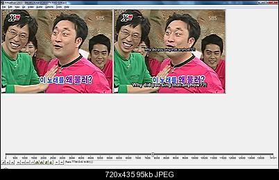

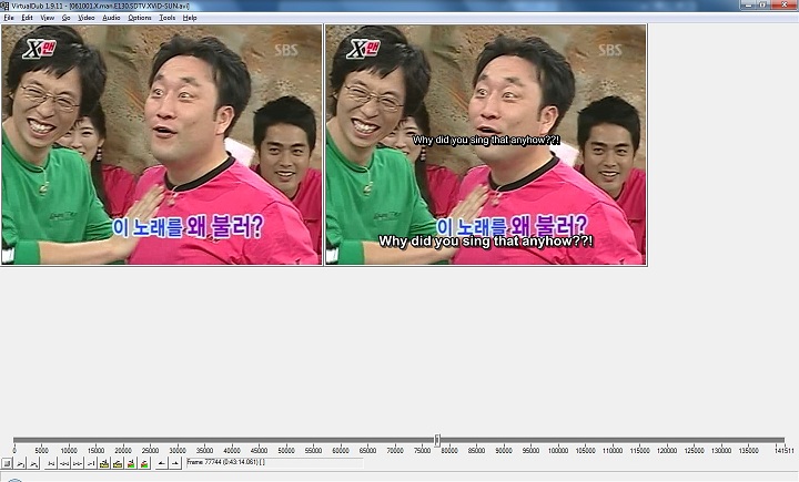

  3. I'm assuming you wanted something like this, but not so extreme?:
    I just selected all of my subs in Aegisub and double clicked on the screen where I wanted my subs to be positioned. Saved it as .ass. Then loaded both subtites in Vdub.
    If you wanted to be more adventureous, you could make a sub file with both of your subs in it and just load one sub file.

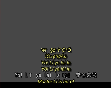

    Is this something like what you are looking for?
Name:	ScreenHunter_464 Jan. 26 22.17.jpg
    I just read the thread and it seemed to get confusing but I think this is what you need? I put every choice there was in crouching tiger and it looks like the characters/symbols are all there.
