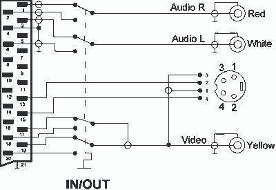

  12. Member hech54's Avatar
    Jul 2001
    Yank in Europe
    Just think of this as the female SCART connection on the back of your VCR. Your SCART connection pins #s 13 and 15 have no connection to anything inside the VCR. If that is the case then you will never get an S-Video signal from that SCART connection.

  14. Member hech54's Avatar
    Jul 2001
    Yank in Europe
    Again.....you are not listening.
    Unless your VCR has a devoted/dedicated S-Video connection....the odds of a SCART connection(on the VCR) outputting what is required for S-Video is 50/50.
    I've looked at about a dozen completed listings on Ebay at Panasonic NV SJ series VCRs and NONE of them say they are S-VHS VCRs and NONE of them list a dedicated S-Video connection as an output.
    Do you know why there is no dedicated S-Video connection on the back?.....BECAUSE IT'S NOT AN S-VHS VCR!!!!!!!
    With that VCR you will need to use the Y/R/W cinch connections just like I use on my Panasonic NV-HD620.
    Period.
    End Of Discussion.
