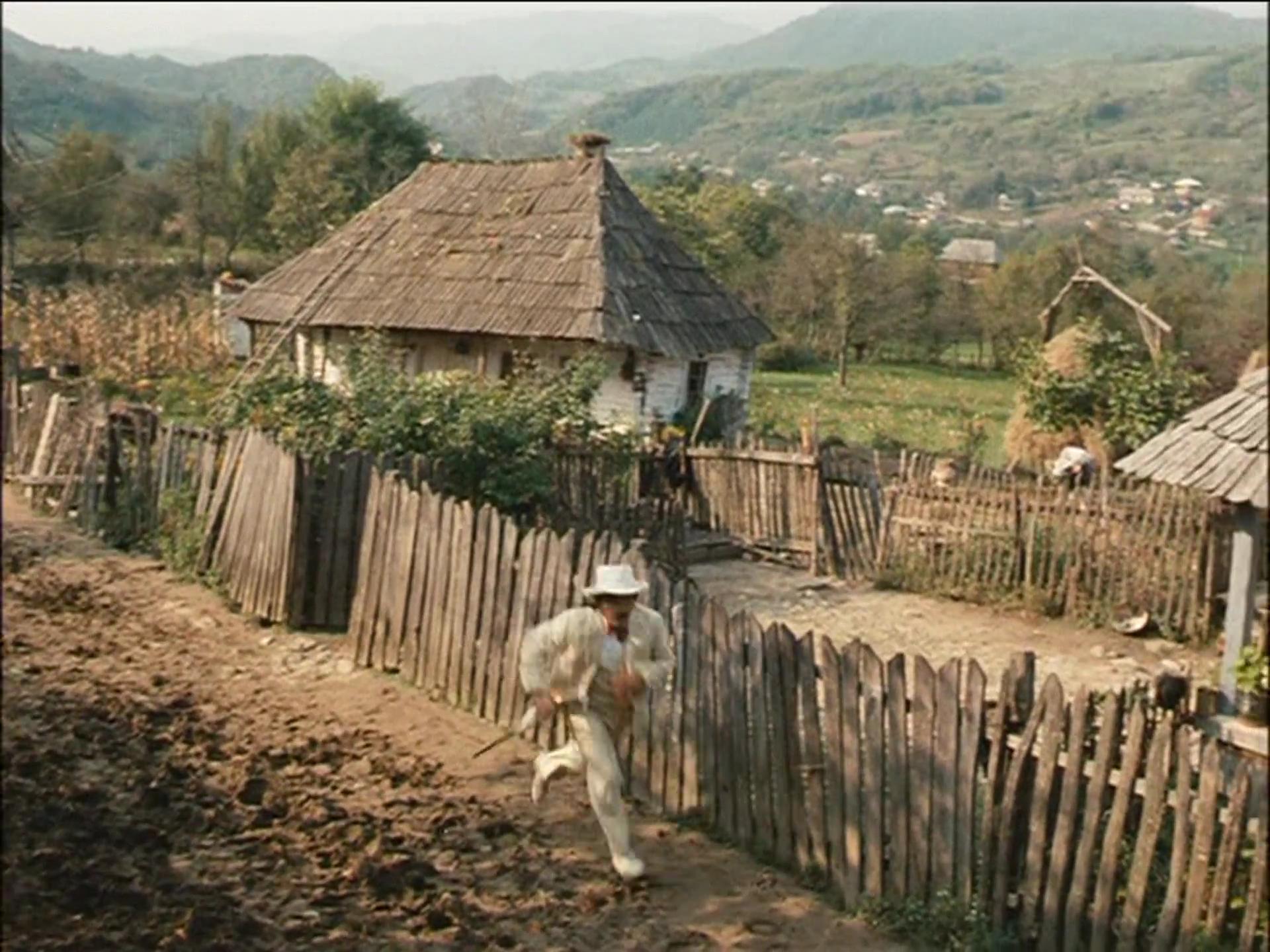

  1. Hello everybody!
    I've searched around but didn't find anything useful.
    Well, my problem is that I haven't been able to resize a video from 1920x1440 to 1920x1080 the thing a actually want is to be able to play video on a HD tv which plays videos with max resolution of 1920x1080p.
    The catch is that I don't really want to lose anything from the bitrate, it's a really old video so everything counts.
    Whe I play it on my Pc, beacause is not a 16:9 video I have to black bars on both sides of the screen.
    I'm not an expert at this so I apologize if I've offended someone with my ignorance.
    This is a screen capture from the video : https://forum.videohelp.com/images/imgfiles/N6D3c.jpg
    Any help would be greatly appreciated.
    Thank you.

  4. What you have is a standard definition video 4:3 that's been upscaled to 1440x1080. Resize to 1440x1080. If that doesn't work resize to 1440x1080 and add black pillarbox bars to make it 1920x1080. If that doesn't work resize to 640x480.
