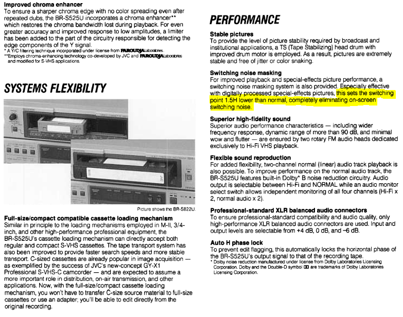

The reason they referred to this as masking, is because by default these decks not only pushed the switching noise down but also masked the remaining noise from the image. There is an internal switch on one of the modular video boards which must be flipped to disable this masking.

You own a JVC BR-S525 - does it show the distortion at the bottom? My BR-S522E shows very minimal head switching noise, so I assume that a BR-S525 behaves no different. Or are you interested in eliminating head switching noise of those videos already available (captured with a different VCR)? -
Standard placement is 6.5H ahead of V-sync in recording
Your JVC has the ability to record at 6.5H, but shift 2H to 4.5H in playback.
It is worth noting that the 822 and 622 models can take this even further and offer the ability to record at 2.25H, and play back at 1.25H for use in closed-circuit systems.
What is interesting is that at least some Panasonic decks don't adhere to the standard, but actually raise the switching point to 7.5H, rather than lower it.
After doing a quick bit of reading, it seems that if anyone wants to lower the switching point on playback in any of their decks this can be done by adjusting the phase generator (PG) shifter. As jimdagys has said, adjusting this beyond the tolerance level of your monitor/capture device may result in vertical jitter, and an unstable image. -
