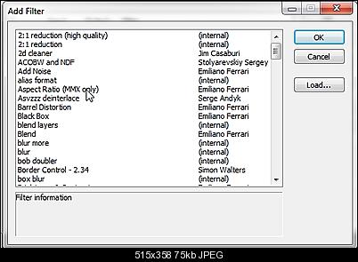

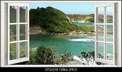

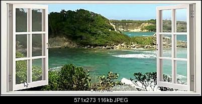

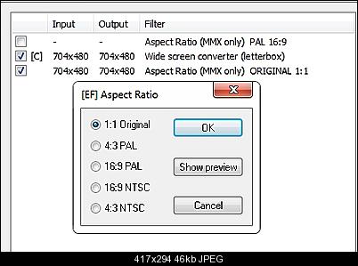

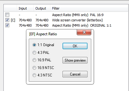

    Just a quick add... not sure if this is what you want from Virtualdub but....
Name:	ScreenHunter_463 Jan. 16 11.37.jpg
ID:	15762Click image for larger version
Name:	ScreenHunter_463 Jan. 16 11.38.jpg
    yields below
Name:	ScreenHunter_463 Jan. 16 11.43.jpg
ID:	15765Click image for larger version
Name:	ScreenHunter_463 Jan. 16 11.44.jpg

    Hi Budman1,

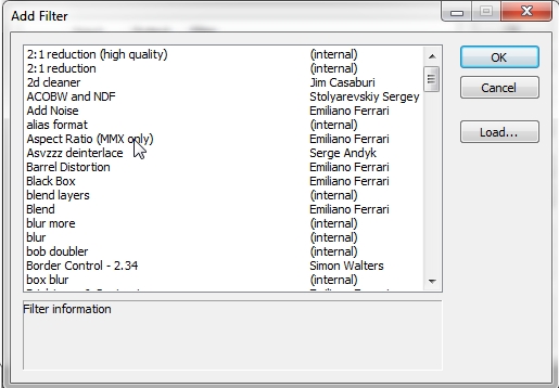

    This is exactly what I want! Thanks! Where do I find that filter?

  15. Member Budman1's Avatar
    Jul 2012
    NORTHWEST ILLINOIS, USA
    That filter is one by Emiliano Ferrari (ef_AspectRatio.vdf) and can be downloaded at http://emiliano.deepabyss.org/. Download the BINARY (http://emiliano.deepabyss.org/All_filters/All_filters_Bin.zip) and unzip. It contains a lot of filters which you place in the plugins folder or the plugins32 folder in later versions of Virtualdub since they seem to have removed the plain plugins folder. All my plugins (.VDF & .VDPLUGIN) are in one folder, the plugins32 and they all work with VirtualDub version 1.10.2.
    Anyway, I would just place the one plugin for aspect ratio in the folder unless you think you might need others. After that you should find that filter by selecting video->filters->add buttons.

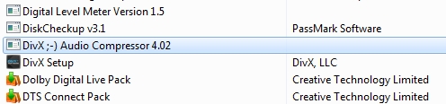

    The missing video codec for early versions of WMA (codec 0161) won't play unless the older Divx 3.11 codec or its composite Divx audio 4.02 is installed as a codec. http://www.free-codecs.com/download/divx_mpeg-4_audio_compressor.htm is one of the download sites and explains the missing codec 0161 and the WMA audio problem as do many other sites hosting this divx audio 4.02 codec. It also has the advantage of not installing the whole DIVX video codec that may overlay your more current one.
    I tried everything until I found this information and after installing the audio 4.02 codec, WMA audio now plays fine in VirtualDub
    UPDATE the link for Audio Codec 4.02 is broken above. Download from this site at https://www.videohelp.com/tools/DivX-WMA-Audio/old-versions.

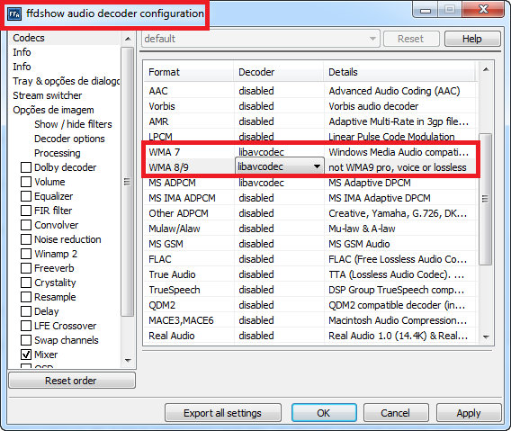

  18. Lone soldier Cauptain's Avatar
    Jan 2006
    Brazil
    Originally Posted by audiocurry View Post
    Hi Budman1,
    I tried all your suggestions and they work great!
    Only one problem: when I render from a wmv source file, somehow, while the video is ok, there is no audio stream.
    Any suggestions?
    Thanks again.

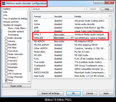

    Install FFDSHOW and set this to decode all WMV audios. Its will enable audio in Virtualdub.
    Claudio

    Hi Claudio,
    Thanks. I've done that, and things should be fine.

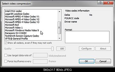

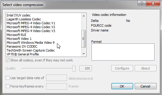

    It is possible to output to WMV9 video by using a VCM video codec:
Name:	ScreenHunter_464 Jan. 19 00.57.jpg
    but an WMA ACM audio codec is almost impossible to find and even if you did encode with WMV(video) and WMA (Audio), As Yoda313 pointed out , Virtualdub only outputs to an AVI container. So while you might have your video ENCODED with the codecs you want, its still going to be an AVI file.
    You would be better off using your original method except skipping step 1 because you can import as a WMV directly into VirtualDub now and use better codecs creating the AVI.

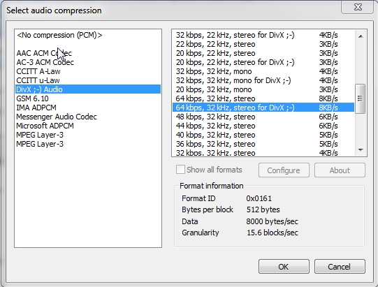

  29. Member Budman1's Avatar
    Jul 2012

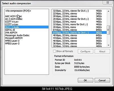

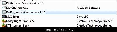

    You CAN get audio with VD. 2 panels up on this thread I show where you just select the "divx audio" and then one of the choices in the right hand pane that has the smiley( ) next to the right of it. That will render WMA audio, at least it does on mine.
    Just make sure you have the DIVX Audio 4.02 compressor installed:
Name:	ScreenHunter_463 Jan. 22 07.28.jpg
    Also be sure you have selected Audio -> Full processing and then Audio -> Compression -> Divx Audio as shown earlier in this thread.
