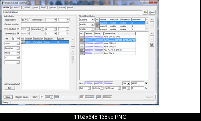

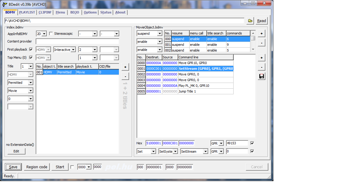

    1) Copy your completed disc back to hard drive somewhere.
    2) Open BDEdit and navigate to the BDMV folder and click "Read".
    3) Stay under the BDMV tab and look at the lower right-hand pane.
    4) Does it have a line that says: "SetStream (GPR0), GPR1, (GPR0), GPR0", or similar?
    5) If so, highlight that line and check the values in the boxes lower down in the pane. Do they look something like this:
    The number 49153 refers to first subtitle stream, 49154 would refer to second subtitle stream, and so on.
    6) If so, highlight the line and click the "-" (minus) button on the right. That will delete the command that turned the subtitle to default on.
    7) Save and exit.
    [Attachment 15735 - Click to enlarge]
    7) Save and exit.
