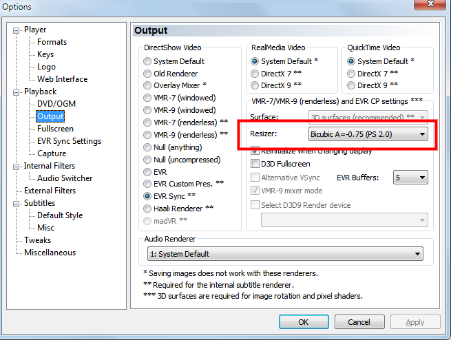

  18. Originally Posted by Stears555 View Post
    Where can I set the resizing algorithm?
    Exactly where Sulur pointed. Options->Playback->Output:
    This isn't MPCHC's resizer, it's where MPCHC tells the graphic card which resizing algorithm is preferred. If the graphics card doesn't respond it's a bug in the driver. And that is very common.
