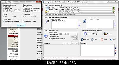

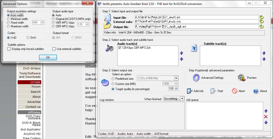

    my settings are the following:

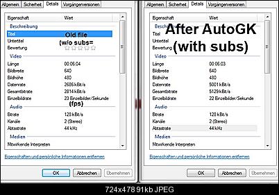

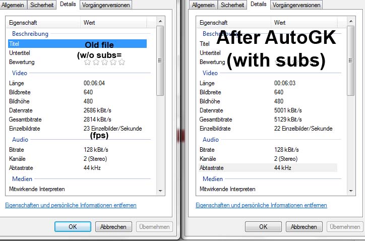

    Unfortunately, rendering the video with this settings again showed me the following result:
    The FPS changed from 23 to 22, the bitrate changed as well as the length. ?!?!
    I'm totally lost here! Any help appreciated (as I said - solving my problem with VideoDub is fine, too!)!

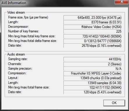

    Honestly, I don't know. I shot several clips with my phone mixed them with VideoPad. The clips already have 23 FPS when I shoot them (I just tested. Some even have 22FPS ?!).
    There are also 3 short clips of another camera with 25fps in the mix, but the project's FPS is 23 anyway:
    And these subs play more and more early as the movie goes along? Or they play early by a fixed amount all the way through?

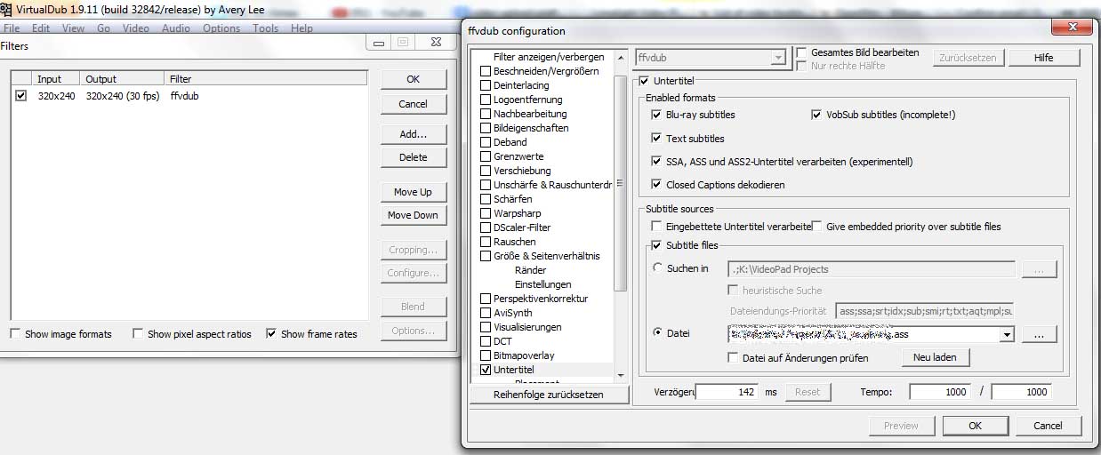

    It seems as they are just played early by a fixed amount (or at least just very small variation). What I'll try now is using the ffvdub-setting to adjust a displacement.
    However, I don't understand how that happened?
  7. It worked with the adjustment configuration. If you guys have any ideas about the problem anyway, I'd be more than happy to know about it!

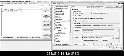

  9. This is what I meant regarding the delay (sry for German): [Edit: the box containing 142ms right now]

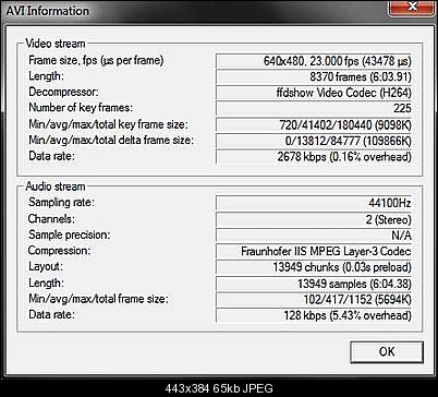

    MediaInfo gives me this for my video:
    Frame rate mode                          : Variable
    Frame rate                               : 23.000 fps
    I checked a few of the raw camera clips and MediaInfo doesn't give out any information about frame rates here... ?!
