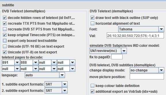

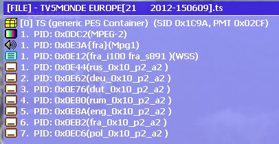

    I can't seem to extract subs from this .ts TV recording. I've used ProjectX. Here's the file info:
    And here, the settings I used:
    Neither DVB subtitles nor teletext ones are extracted.

    By the way, does Teletext and Subpict. PID's indicate the presence of subtitles streams in the .ts file, please?

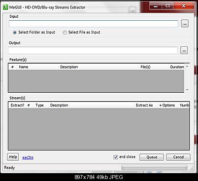

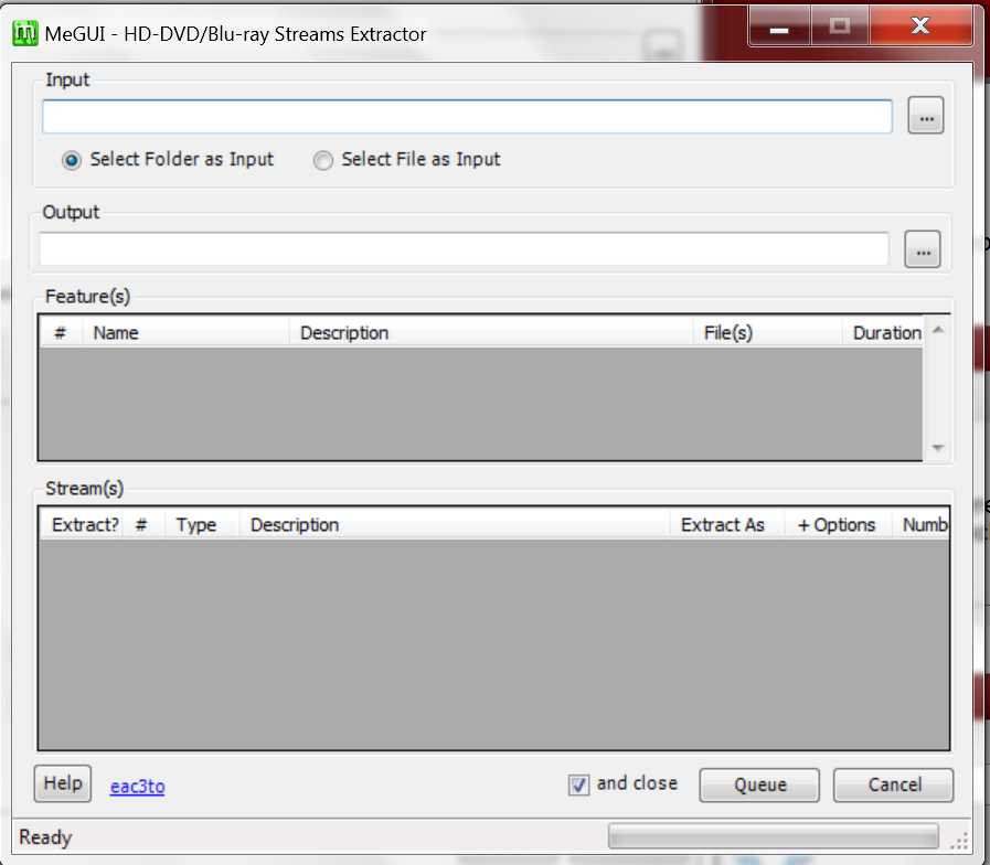

    to get subs from an .ts file you can use MeGui.
    run it...click on "tools"...HD Streams Extractor...select the folder of file where the .ts file is....select a destination where you wanna save it...it will scan the file and at the bottom it will show you whats inside the .ts file....uncheck all the things you don't want to keep and click "Queue" and it will save it to the folder or place you specified
  5. Many thanks.
    MeGUI shows only two types of stream, Video & Audio. Does that mean the .ts file doesn't contain any subtitle streams, even though ProjectX lists their PID's?

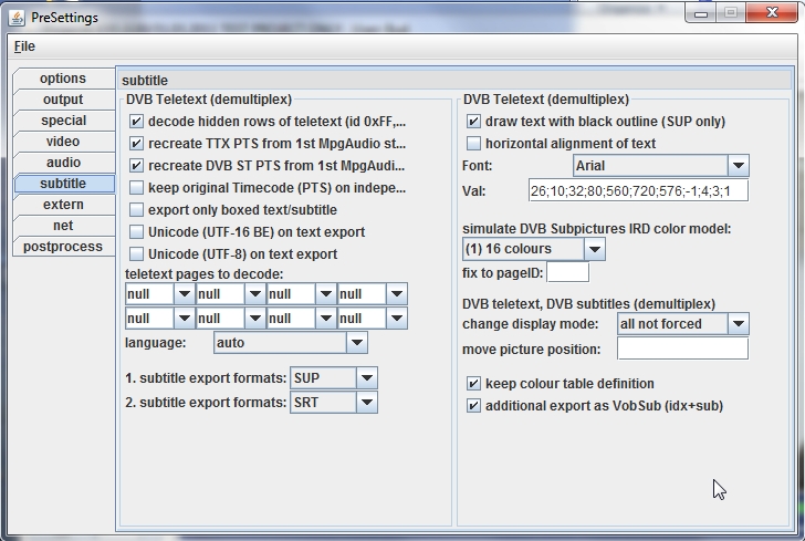

    On the subtitles presetting page try unticking the first 2 options

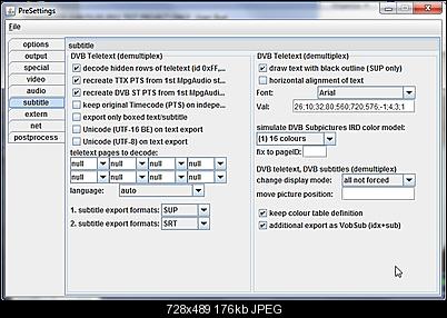

    If the subtitles are truly DVB or teletext You can use ProjectX with the presettings as follows:
Name:	ScreenHunter_480 Apr. 04 02.03.jpg

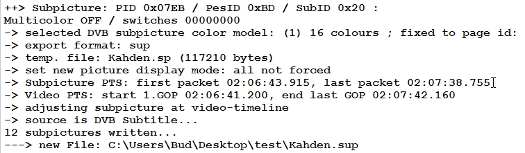

    It saves several files and the DVB to .Sup (Teletext to .sup.sub)

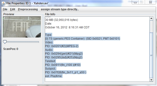

Name:	ScreenHunter_480 Apr. 04 02.05.jpg

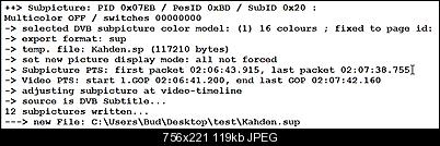

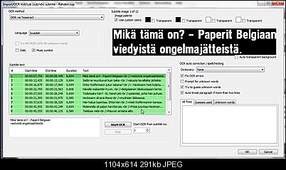

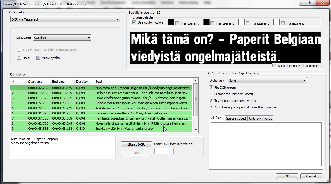

    Then open Subtitle Edit and drop the video.sup into it and click yes if it asks to import the vob file. When the OCR screen opens,
    select the language (download additional if needed) and adjust the colors for white letters with black borders and background:
Name:	ScreenHunter_480 Apr. 04 02.08.jpg
    Click start OCR and it works fairly well. Save to whatever format you choose from the main page. Hope that helps, it has always worked well for me in the past.
