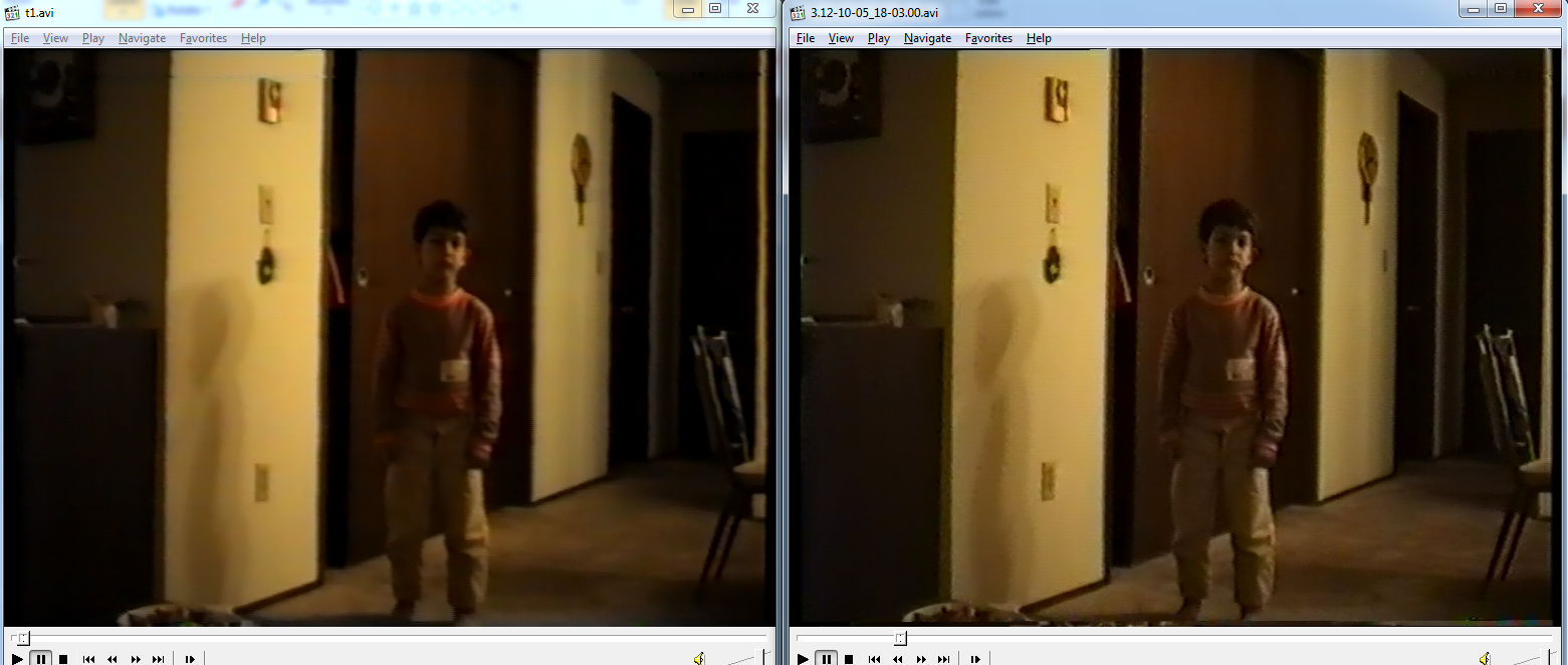

    My setup is a VHS-C VCR/camcorder (PAL) ->(svideo/composite cable depending on cam)-> tbc1000 ->(svideo cable) advc100 -> DV file
    I wasn't able to get a pro VCR where I live, so I tried multiple other options and would like your opintion, yes, I know it is the weakest link and maybe the most important one, but I might have to live with that (unless its worth spending $450+ on..)
    So the LEFT is a simple SONY 4 head VCR, with a composite connection, which was really close to a few other non-pro VCR's I've tested (LG 6 heads, etc).
    The RIGHT came from a JVC VHS-C camcorder (jvc GR-SXM470, should have TBC/NR), I think its very similar to this one: http://www.jvc.co.uk/files/instruction_manual/lyt0707-001c.pdf
    The JVC one seems a bit harsh, but that might be only because I am comparing it to the VERY soft SONY one ?
    Can I get your input on this ? Does the picture look ok ? should I change my gear ? get another camcorder (sony maybe?)
    EDIT: the pic might be misleading, but the video from the SONY looks really smooth compared to the JVC, which is kind of annoying.

    The left image doesn't look "really smooth" at all. It's blurred, and if there's supposed to be a tbc involved on the left it's not helping much (the walls and doors have wiggly edges). Image at the right is better. And verticals are straight.

    Yes, the right is a bit blurry (and there is a TBC in its chain).
    Do you think I would benefit MUCH more from using a pro VCR deck or another camcorder ?
    Could you also explain whats the meaning of a DV codec (is it only in use for PLAYING ?) because if I understand correctly, when capturing with windv (or another program), it saves the DV stream as is to the avi file.

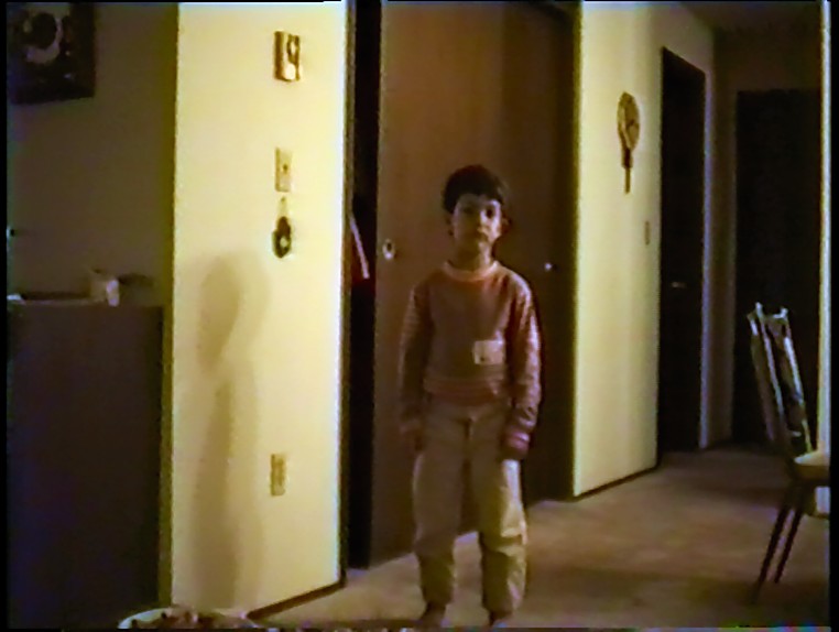

    I wouldn't judge it from a still (it might look completely different in motion), but the wobbly verticals in the left one would make me reject it. You can easily blur+sharpen the one on the right to make it look like the one on the left if you want. You'll be able to see more with the levels corrected, and you can remove noise more effectively once its in the PC.
