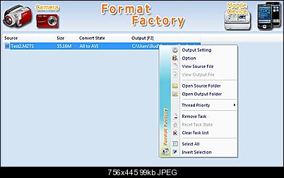

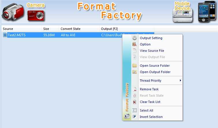

    Since it is your first time using Format Factory, elaborating on what ypou wish to do, first right click the title in FF that you wish to adjust:
Name:	ScreenHunter_461 Jan. 10 16.27.jpg

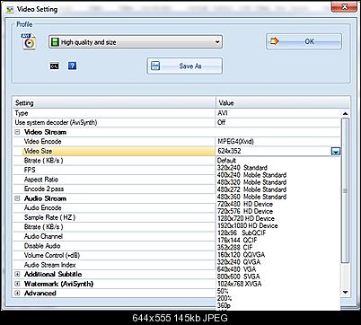

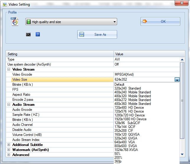

    The two lines you will be using are options and output settings, For now select output settings and click video size. Many standard options show up aand you can use those as previouslyu suggested or you can just overwrite the settings as 624x352:
Name:	ScreenHunter_462 Jan. 10 16.33.jpg
    Convert and see if they play!

    Budman1, I didn't know I could click in that field and input whatever numbers I wanted for video size, thanks!
