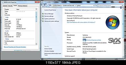

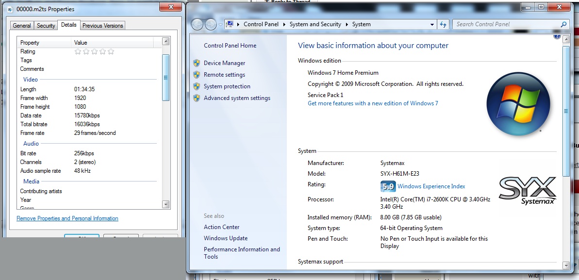

    I will attach some information here, but I used a Canon HD camcorder for most, but not all of the video. I used the FXP mode which is 1920 x 1080, and about 17 mbps. I use different programs for the editing since I like the features of some, but none seem to have everything that I want. I do find that Corel X4 crashes less than Pinnacle 16 and Sony. Sony came highly recommended to me on this board, but it does not work well on my computer. I have i7 processor with 8 GB of RAM. I'll admit that I have not kept up well with listing these specs but I do know this computer should be very adequate for editing video and that is one reason I bought it in the first place. One camera that I used is my new Gopro camera and I know it has a higher bit rate, but I thought this software was supposed to make all my video compatible with Blu Rays before outputting folders to burn to a Blu Ray. Am I wrong about that?
    As far as the jerkiness on the blu ray that does not occur on the computer, I may need to clarify that when playing the burned blu ray disk in the blu ray burner/player, on my PC, yes it still has the jerks in it just like on my separate player with the TV. Only the unburned originall 0000.m2ts file that I find in the folder on the PC (not burned to any disc) plays fine on the computer with no jerkiness. So I am concluding that something happens during the burn process to cause this.
    I suspect if I only used video with the same camera, and only used one software program, for a given project, all the way through burning the disc, I would not have the problem, but that sure seems limiting! I appreciate any continued thoughts here.

  5. Originally Posted by suelaine View Post
    Probably has to do with the software (either encoding or authoring stage) , burning or media quality
    Post the settings used for the project, and the render settings
    How did you create the "blu ray folders" ? Was the authoring done by Pinnacle ?

    You're off to a decent start, but we still need LOTS more info. Mixing camcorder footage is probably a big part of the problem. The one you posted the image for would seem to be interlaced and your other sources may be progressive, meaning that the output is possibly deinterlacing everything or behaving in some less than optimal way to handle this possible mixture of interlaced and deinterlaced footage. Frame rates and resolutions could be different between the sources too. Yes, running your project through multiple editors is quite possibly a source of the problems as well.
