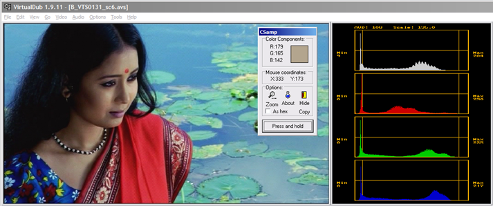

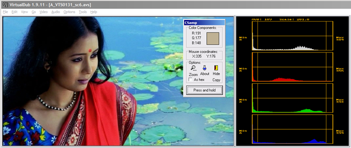

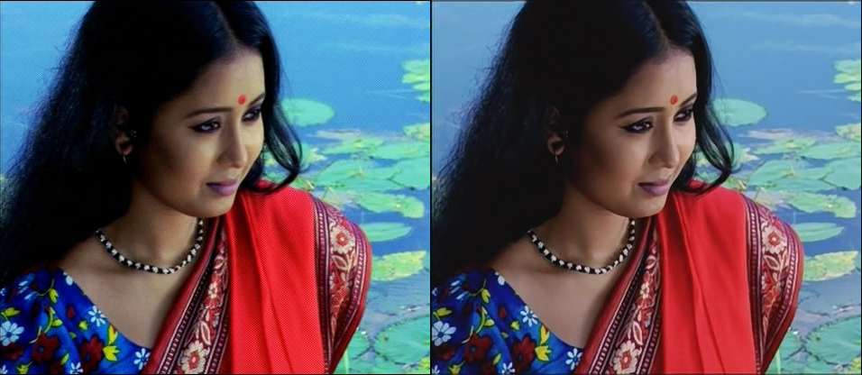

  6. i know there are plenty of flaws in the video
    currently which is bothering me most is this grain/dirt/dust/ dotcrawl
    it worsens (it should) with the detail enhancement/sharpenning
    before sharpening
    after sharpening
    is this problem have any similarity with this?
    http://forum.gleitz.info/showthread.php?t=28979&highlight=spatiales+sieb+goldw%E4scher-manier
  7. You problem is that you use FineSharp, an option which is meant for clean sources, which yours definitely is not.
    # Small and relatively fast realtime-sharpening function,
    # for 1080p, or after scaling 720p -> 1080p during playback (to make 720p look more like being 1080p)
    # It's a generic sharpener. Only for good quality sources!
    # (If the source is crap, FineSharp will happily sharpen the crap.)
    # Noise/grain will be enhanced, too. The method is GENERIC.
    # Modus operandi: A basic nonlinear sharpening method is performed, then the *blurred* sharp-difference gets subtracted again.
    # - Didée
    source: from the beginning of the original FineSharp script,..

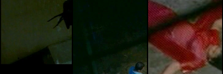

    Similar, but not quite. The noise shown in the link is striping - not the same as dot crawl. Your samples all have dot crawl, chroma upsampling error ("CUE"), and low bitrate artifacts...among other things. The first 2 are alomost impossible to clean without detail loss, the low bitrate problems are very difficult (more detail loss); the color can be fixed somewhat except for the bad crushing and highlight clipping.
    When video data is crushed (darks) or clipped (highlights), the original luma and chroma values are distorted or destroyed. There's no way to get it back. Here is a quick chart for a very simplified demo of what happens to dark colors when crushing occurs. The chart shows the original values, and how those values are changed by crushing, or "compression" of original values whose ability to define fine gradations between details has been crippled:
    Original  Crushed
     RGB  0     0
     RGB  1     0
     RGB  2     0
     RGB  3     0
     RGB  4     0
     RGB  5     0
     RGB  6     0
     RGB  7     0
     RGB  8     0
     RGB  9     0
     RGB 10     0
     RGB 11     0
     RGB 12     1
     RGB 13     1
     RGB 14     1
     RGB 15     1
     RGB 16     5
     RGB 17     5
     RGB 18     5
     RGB 19    10
     RGB 20    10
     RGB 21    10
     RGB 22    10
     RGB 23    15
     RGB 24    15
     RGB 25    15
     RGB 26    20
     RGB 27    21
    You can see that if you try to "brighten" the crushed stuff, you get noise, clumps of grainy dirt, etc. -- little or no detail, and severe banding where colors change.
    From VTS-)1_1.m2v:
    Left image (frame 11): Detail and contours on the lower-left wall are constantly shifting and jittering due to low bitrate artifacts. It becomes difficult to tell the difference between the rain and the wall details that are in motionm. Not enough data bits to maintain definition or control motion with good stability.
    Middle image (frame 318): the same problem, upper right. The darks don't blend cleanly, and the grubby dirt and clumps continually move and change shape.
    Right image (frame 318): dot crawl and chroma upsampling error, not to mention oversaturated and blooming red. The filters your script used are not effective in addressing these problems.
    So, "grain" is the least of your worries. The original source was film media, which itself has a certaint amount of fine grain that accounts for the film "look" of movie film.
    I have attached two attempts at cleaning your VT1_01_1 m2v. I didn't attempt to resize for straight 16:9, as this video won't resize so well. Didn't have time, anyway, to work out the 16:9 dimensions for PAL.
    Effort #1 is attached as VTS_01_1_Q.m2v . Its main tools were ColorYUV, SmoothAdjust, QTGMC, and NeatVideo. Note: NeatVideo was used at very low power, mainly as a leightweight finishing smoother and a mild sharpener. Could probably be tweaked more, but you can use whichever tools you like. This is a condensed version of the three steps I took to get the m2v:

    The o0ther two samples don't just have the same dot crawl and mesh noise-- they're worse. The lon ger VTS_01_3 gets even worse than that: every camera shot looks like something from a different video. That means major adjustments with almost every scene change. If you have little notion of how these filters or color adjustments really work, you could be posting to this thread in 2015.
    The source is simply defective, the same problem apparently runs all through it. How did this source originate? Is it a rip from commercial DVD, a commercial DVD itself, or something recorded to DVD from tape? I see several defects that are common to tape playback. If it's a commercial DVD or tape, it would be interlaced as standard PAL, or some otehr adaption from film would have been made. But this is deinterlaced. Without a better copy of the original, you're in for a very rough time of it.

    The original clip has 14 short camera shots. Each scene has a different noise problem and different oddball levels + color problems. Looks like clips from 14 different movies!I had to correct each scene separately, then join and encode. Some hassler, all 14 shots use a different script. Bad interlace was only the beginning. The infamous net-mesh/dot crawl problem is mostly gone (more or less). I found a trick for handling it:
    RemoveGrain()
    QTGMC(InputType=1,preset="medium",TR2=2)
    TurnRight()
    RemoveGrain()
    TurnLeft()
    Some scenes have a fine-grain mesh or herringbone pattern. Sometimes it's moving, sometimes not. When it moves vertically like ripples in water, a second trick handled it better:

    The image below shows floating herringbone in the red garment and blue water, etc., on the left. The right-hand pic is the result of using the above routine. Taken from frame 950 (scene 6) -- right-click to enlarge. Not perfect, but at least it isn't simmering and sparkling. What a workout! It would take months to clean this bad processing.
Name:	frame950-original-vs-after (scene 6).png

    The rumor is that some plugins are designed to clean noise that moves horizontally (and that's only rumor, but stop and think about it). Look at camera shots #3 and #6 in the original VTS VTS_01_3.demuxed-1.m2v . Note the fine-mesh noise in the clear areas, especially water in #3 and water and red garment in #6. Use DGIndex to make a d2v of that .m2v, then try this:
    MPEG2Source(vidpath+"VTS_01_3.demuxed-1.d2v")
    RemoveGrain()
    You'll see that some of the horizontal-moving noise has been cleaned, but now the horizontal (up and down) motion is more evident. Then try this:
    RemoveGrain()
    TurnRight()
    RemoveGrain()
    TurnLeft()
    More of the noise is removed. Sometimes the second trick with FluxSmoothT() also works. Both plugins have mamny settings. I just ran out of time to try all of them. The other plugins I used were also a big help. Back later.

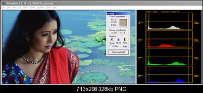

    Below is a reduced-size screenshot of my VirtualDub display, with the original clip (Scene 6) in the input pane and an RGB histogram from ColorTools in the output panel. Also in the screen is the CSamp dialog window, which is a free tool for reading pixel values. Some use YUV histograms. That's wsell and good, but YUV shows how the data is stored. I use YUV tools as well, but in the nitty-gritty I simply prefer the RGB view.
    Viewing images in a web browser tends to darken the image, so you might want to copy these and view them in a photo App. I used Photoshop Pro because it can "read" my monitor calibration (In other words, what I see there is what I get). But on a properly calibrated monitor, VirtualDub gets close to the mark.
    You can see in the photo that skin tones are too green. The dark colors of the hair are badly crushed against the left-hand side of the histogram. The bright contrast (right-hand side) isn't so bad, so at least the highlights aren't blown away. But the hair is too blue and red is oversaturated and tends to "bloom" a bit (looks a little "hot"). Unfortunately the crushing destroys much of the fine detail that should be there. This is the original uncorrected frame 40 image from Scene 6.

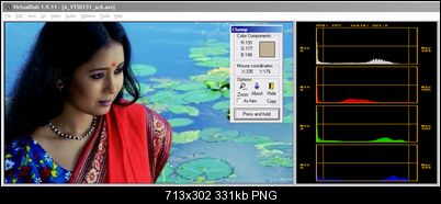

    Without loading any other filters, I ran the script with only the SmoothLevels() and ColorYUV statements. No denoising yet. The web image is still a bit dark, but you can begin to see some small details in the hair (which is still too blue). The histogram shows the major change on the left-hand side, where YUV black levels were raised to about RGB 16 to prevent TV from turning everything a color darker and more grimy than coal. The big peaks on the left-hand side show the dark clipping, so there's only so much one can do to retrieve detail. Making the darks brighter won't bring up more detail, because that detail is gone. With ColorYUV the skin tones were improved by reshaping red and blue contrast and other parameters. Red saturation was calmed a bit to make the cloth look more natural. An oversupply of Green is corrected two ways: First, one can decrease green. But in this case, that would reduce overall saturation, and the water plants wouldn't look correct. The other way to correct Green is to add cyan (Red + Blue, which I did here with ColorYUV). Skin tones and hair aren't quite right; skin is a little pale, and IMHO the water is too green.

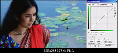

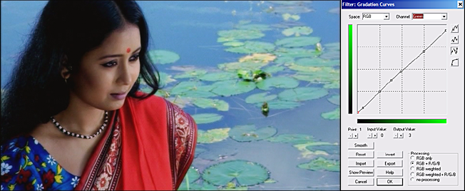

    The colors and levels were tweaked in RGB with the gradation curves filter. Learning to use it doesn't take that much (I studied free web tutorials about the same control in Photoshop). Basically, I had to increase Red in the shadows and midtones, reduce green overall (especially in the brights), and reduced very dark blue a small amount. It's up to personal preference whether I made the water too blue or the plants not green enough. In any case, these tweaks are often a matter of personal preference. I favored skin tones here.
